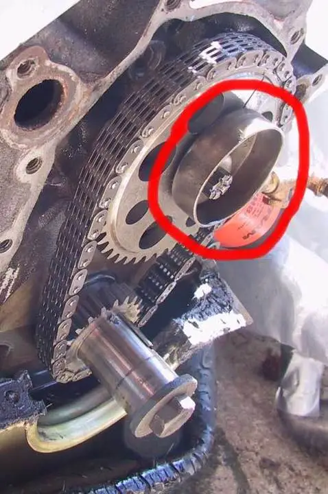

I just finished the same swap, and am trying to get the word about the Mechanical Fuel Drive... TAKE IT OFF WHEN DOING THE SWAP!!! <--- IMPORTANT.
It's that ONE single cam bolt. Unbolt it, take the FuelDrive off (dogdish shaped) bolt the bolt back in, and bolt your timing cover up.
