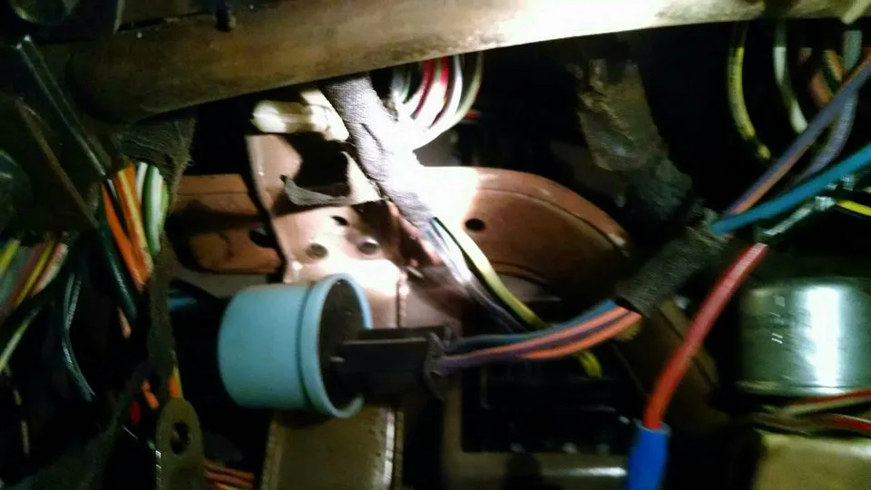

The flasher for the turn signals is a little round silver thing like the one in the front of the fuse box...sometimes they are light blue and plastic sometimes they're metal. They are usually only a couple bucks at a parts store. The turn signal flasher is located under the dash (usually) hooked to the metal frame under the steering column. The connector has a horizontal and a vertical female pin in an L shape. This pic is in an 89 mustang

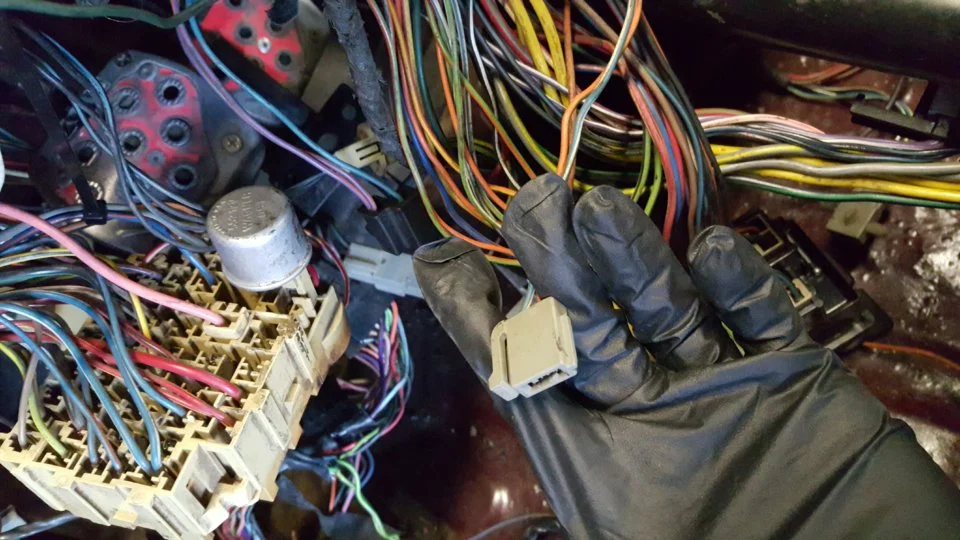

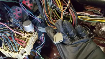

Yeah im not very good with electrical and schematics . I have chased wires and tested wires replaced things and still no luck. I have replaced and checked the fuses on the fuse box. I have replaced the turn signal flasher. I have replaced the ignition switch. I have replaced the hazard /defrost button. I have replaced the turn signal lever thing. I have replaced about everything in the circuit. I have power all the way to the orange yellow wire that goes into the multifunction switch. But i have no power to the white green and White blue wires. I have noticed these two plugs one on each side of the car thay have the same colors as the turn signal wires but i do not know where they would plug in at. I juat really need help figuring this out. Never had this problem before replacing the harness. I am going to post a pic of the two plugs one on each sode of car maybe you know where the hook up at or whay they are for.

I'll go out and check in the am... There are a few connectors that don't plug into anything on these cars.
