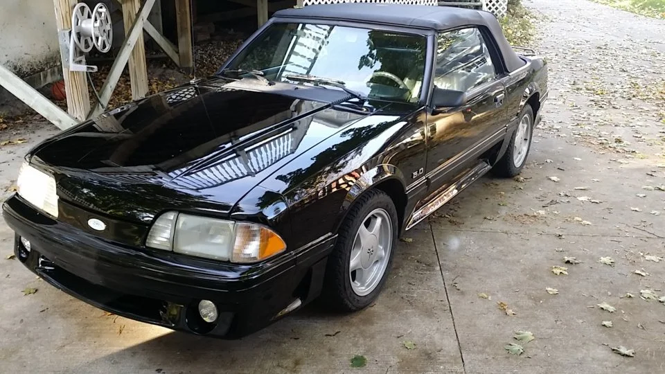

Hello,
I am in a position where I am not sure which direction I should take. What I have is an 87 Mustang 5 speed with 108,000 miles on it. It is all original, as far as I can tell. Overall, I would say the car is in pretty good shape. I would give the body a 7 or 8 out of 10. Because of the age, I am having issues with gaskets leaking. I would like to fix this. So my thoughts were to pull the motor out this spring and replace all gaskets. While I am at it, I may replace the clutch. It is not slipping but it does feel like it is on the end of its rope when it comes to adjustment. While the motor is out. my thoughts were to put on a set of gt-40 heads and intake from an Explorer. This is where I am not sure where to go. There is the possibility that I may put it up for sale in the summer. But I do not want to sell this with the oil leak.
What are your thoughts?

What gaskets leak? All of them... literally. I have oil leaking from oil pan, timing cover, valve covers, rear main. I need to replace the pressure line going to the power steering pump. I bought the car back in September. It was garaged but I would say was not maintained well. I am the 3rd owner. When I say maintained, I mean that things werent replaced like they should. If I had owned this car for the past 10 years, the gaskets would not be leaking. What is nice about the car is that it is all original, except for the wheels. The underside is completely clean. No rust!! But after having this, there are some things I miss with my 94 that I had. So I thought about buying a 99 or newer GT.
I would like to replace the gaskets and get things cleaned up a little. If I sell or keep, either way, I think they need to be replaced. As far as the heads and intake goes, I thought that replacing these items would be great if I were to keep it long term. I know that it would fall short of my 351w that I built but I think it would be a decent start.
As far as the fact that it is all original, do you think anyone would care if these items were changed? I would imagine that someone would be more picky about the gaskets before the head and intake change.

I paid $2200 for the car. Overall, the car isnt bad. It has decent paint job and zero rust. It has a new top and water pump. Since I have owned it, I replaced heater core, lower intake gaskets, wiper motor, front brake hoses. It needs a new driver door handle replaced, new power lock motor/actuators, new weatherstripping on doors/windows/and possibly header windshield area, the driver seat is a little rough looking (leather), and the top motor does not currently work. This is aside from the leaking engine gaskets.
