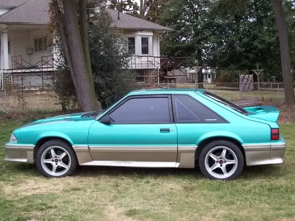

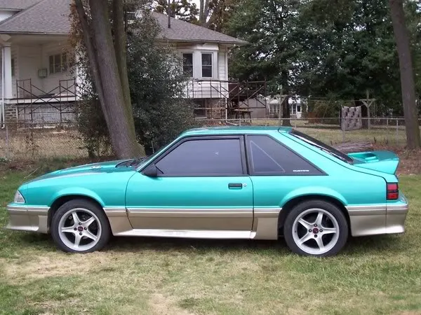

I had this set up on my car with a 2" drop for 5 years with out rubbing
I just switched to 255/40/17 on the front and 265/40/17 on the rear with the same 2" drop... the rear rubs only when i have a passenger....

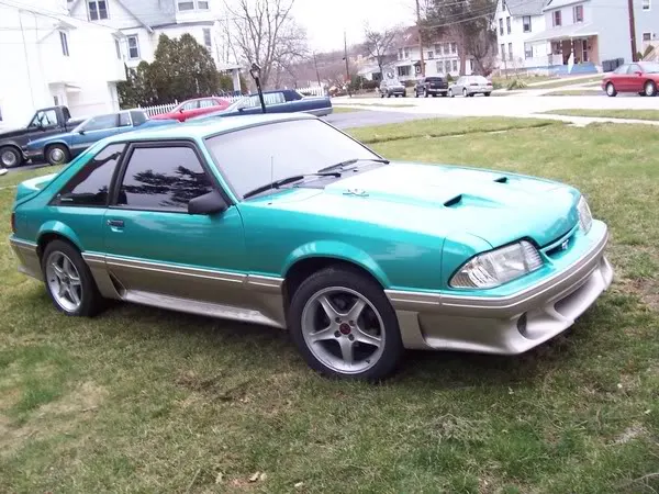

this what it looks like...

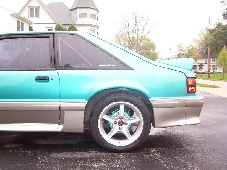

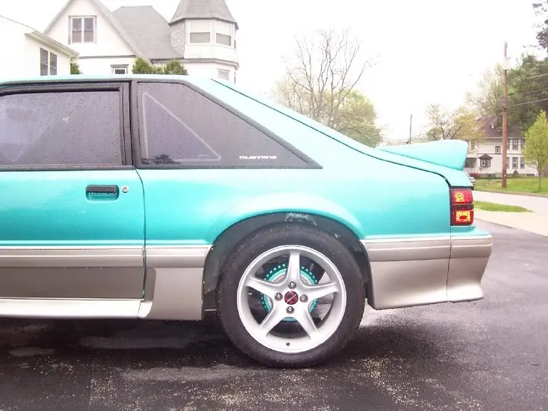

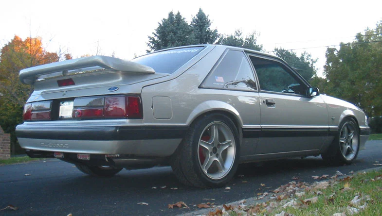

In this picture here, you can actually see where my tire rubs (back) the inner wheel well when going up certain driveway angles and weird turns - normal driving is fine though - it doesn't bother me at all-

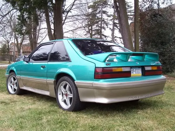

Random pics, i havent seen in a while...

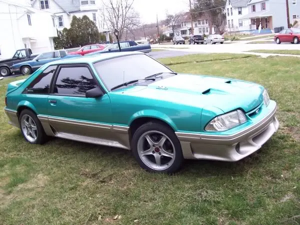

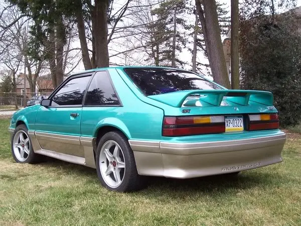

here's another pic 255/40/17 front & 265/40/17 rear
with a 2" drop
