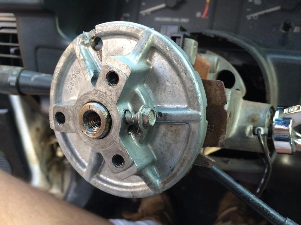

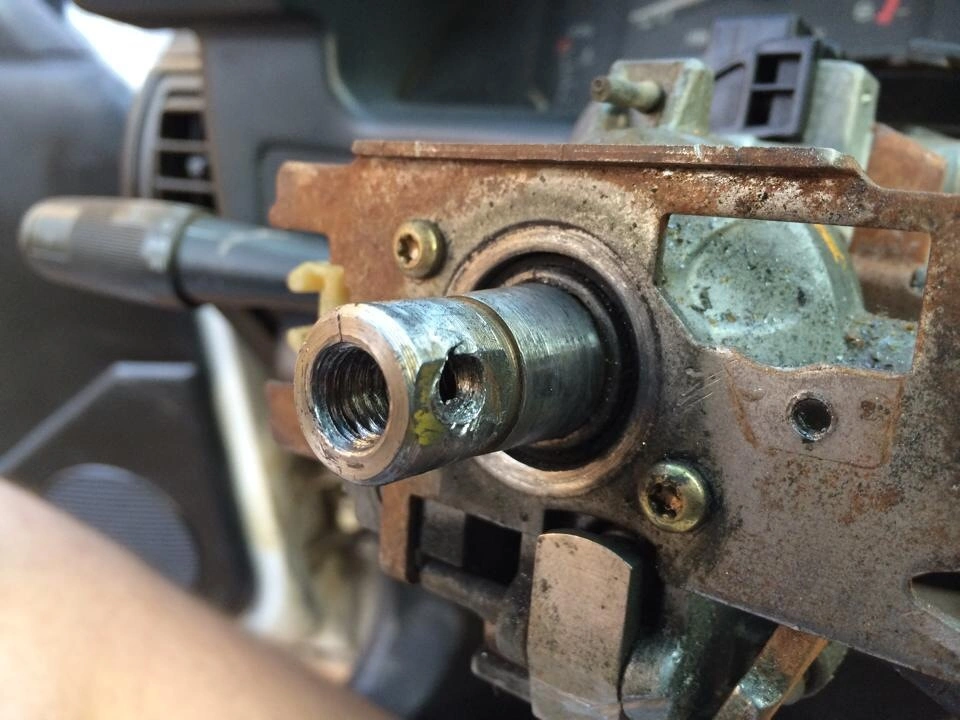

Need to source some parts in order to get my 87 driving again.
On my tilt column, one of the 11 previous owners decided to rig up an after market steering wheel.
In doing so, they buggered the shaft where the steering wheel connects, and the horn connection is no where to be found. Which will cause problems for a safety inspection next year.
What this has caused is the steering wheel at times to slip and turn with out turning the wheels, which is as scary as it sounds when driving.
So. Do I replace the whole column, or can the end part of the tilt be removed and fixed?

There are plenty- too many in my opnion- fox body's being parted out. Find one and swap the entire column out. It's a few bolts a couple of connectors and you are done. You can change the ignition switch while you have it out.
