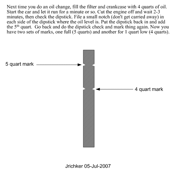

The dipstick, just like the factory gauges isn't accurate.
Here's a simple fix.
Change the oil, fill the new filter a full as you can get it without spilling a bunch of it when you screw the filter back on. Add the partially empty oil bottle to the crankcase plus 3 more quarts. Check for leaks and loose things like the two drain plugs. Start the car, check for leaks again : this mixes the oil in the filter with the rest of the oil, giving you a full 4 quarts in the pan when it settles. Shut the car off and go have a soda or some other cool refreshment: that will give all the oil the chance to drain back into the oil pan. Come back remove the dipstick and use a round file to make a pair of marks to indicate the 4 quart oil level. Add the 5th quart and repeat the file marking process. The round file reduces the chance of any cracks developing in the dipstick. Some cars have a 1/16" or smaller hole drilled in the dipstick instead of a file mark on the dipstick. This requires a drill press and a high speed 135 degree cobalt drill bit. Small drill bits break easily and the dipstick is very hard spring steel. Be sure to wipe all the metal filings off the dipstick before putting it back in the oil pan.
