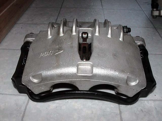

Highly recommend not running the 94-98 front calipers and picking up a set of 99-04 2-piston calipers...but your call there
The brackets are part of the caliper up front. It's the black bracket shown here

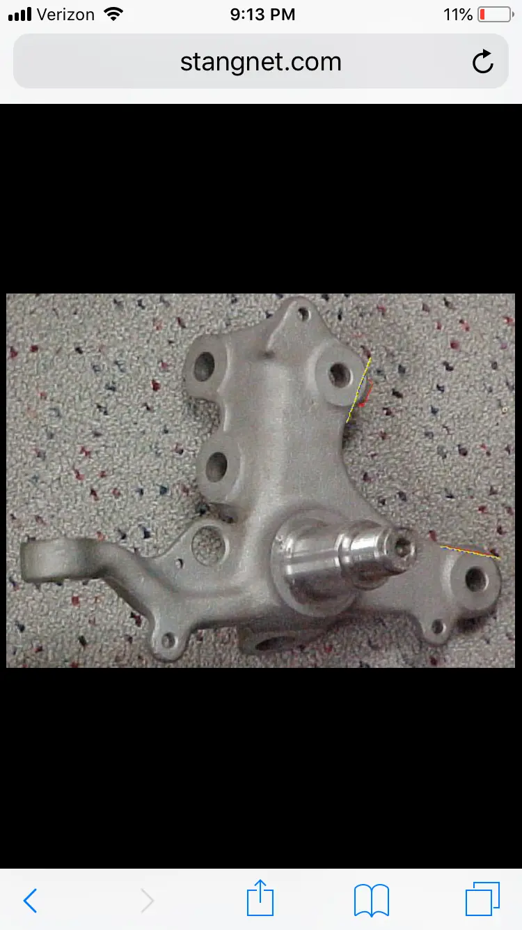

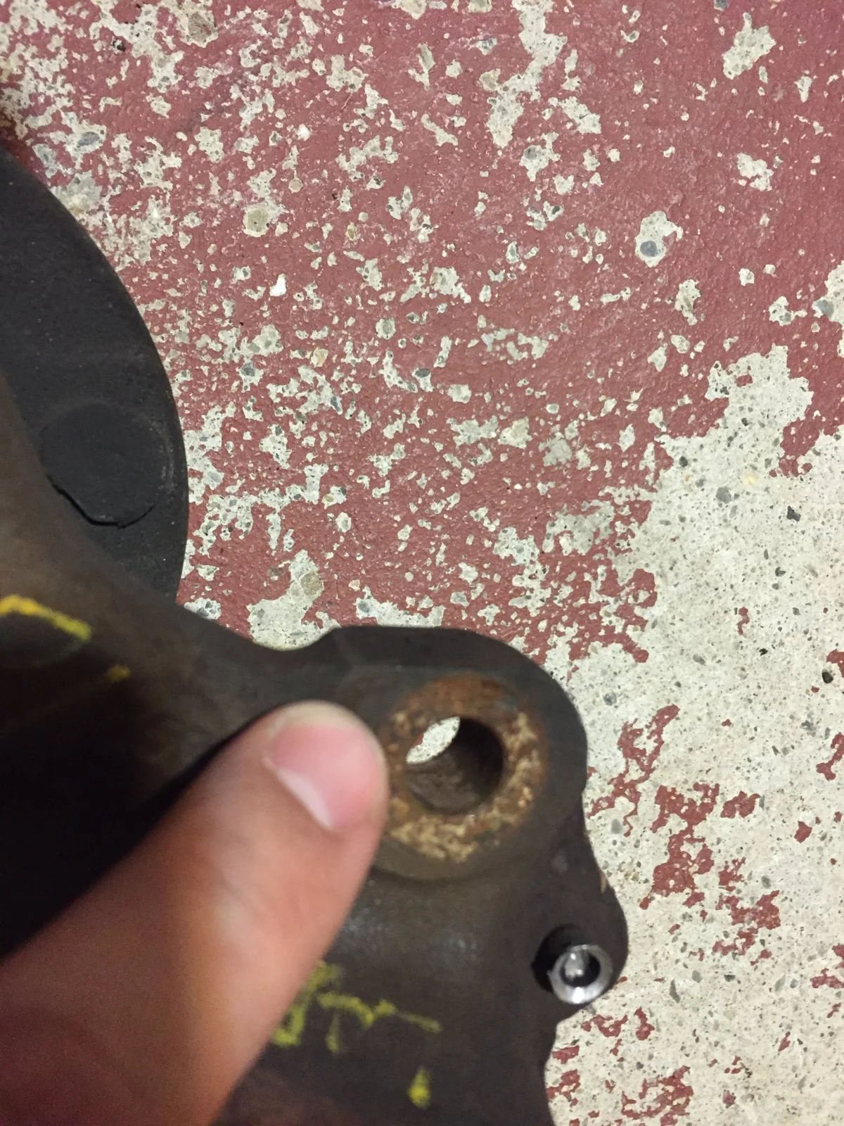

When using the 99+ calipers on 94/95 spindles, a small bit of ckearancing is required for the two pistons. Bolt the calipers on off the car and you'll see what needs to be clearanced around the mounting holes
This is a 96+ spindle that is cast with the mounting holes clearanced slightly

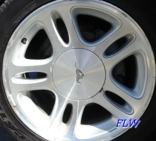

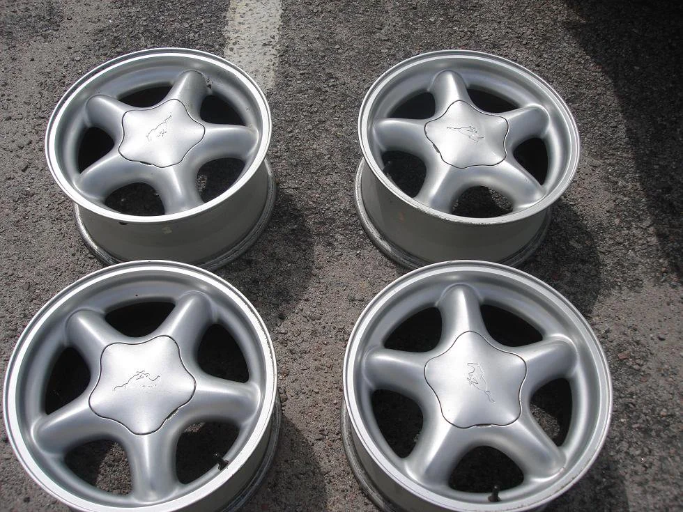

I'm looking forward to it. I was looking for the notes I saw on wheels that will compliment the swap. I was thinking about 17" pony wheels but am open to suggestions and opinions. It's an 88 GT with (soon) 95 GT brakes and spindles.
... and now I know. Thanks. I'd like to run 17" and these seem to have an offset that "should" fit based on what I've read (30mm). Though I have no hands on experience with these so I'm going based on what I've read. I was certain that I saw (and I should have copied / bookmarked) a page that indicated the factory rims that folks had actually used. I'll keep searching, I have the time...
@Mustang5L5 I managed to find a set of split 5 spokes with tires (about 1000 mile on them) for $250 seemed reasonable to me. I never heard back from you. What size tires are you running on the sn95 wheels from the post above? I think 245/45R17 is supposed to be the norm. Let me know

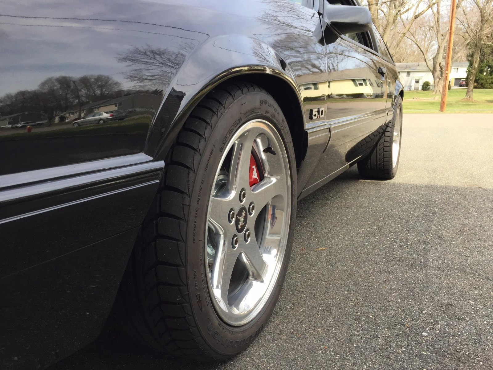

235/45/17 up front, and 255/45/17 out back.
If I could do it over again, i'd go with a 245/45/17 up front. The 235 does make fitting the wheel easier due to the shorter diameter, but I think I could squeeze the 245/45/17 in there fine. The 235 looks a bit narrow at some angles
