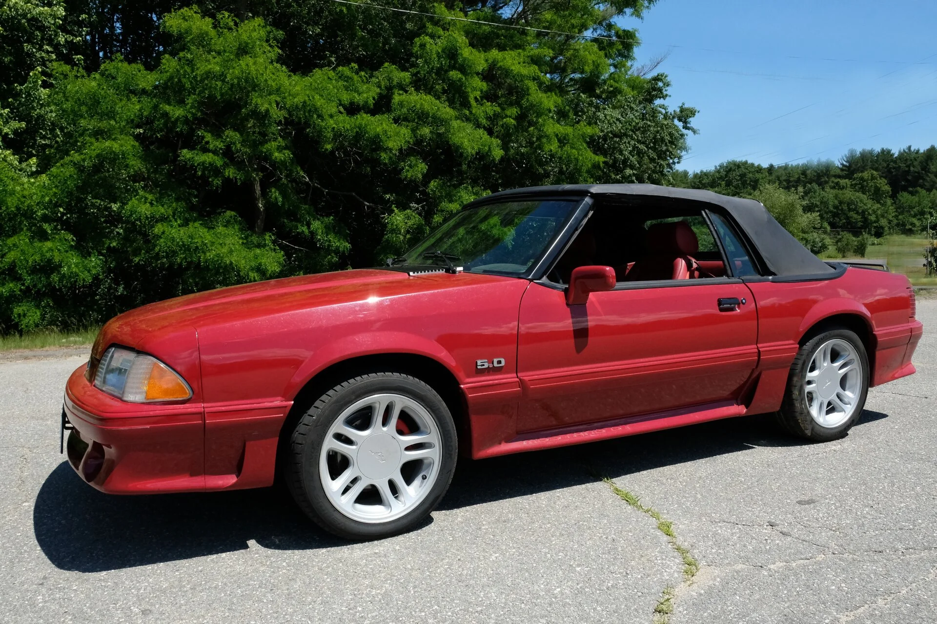

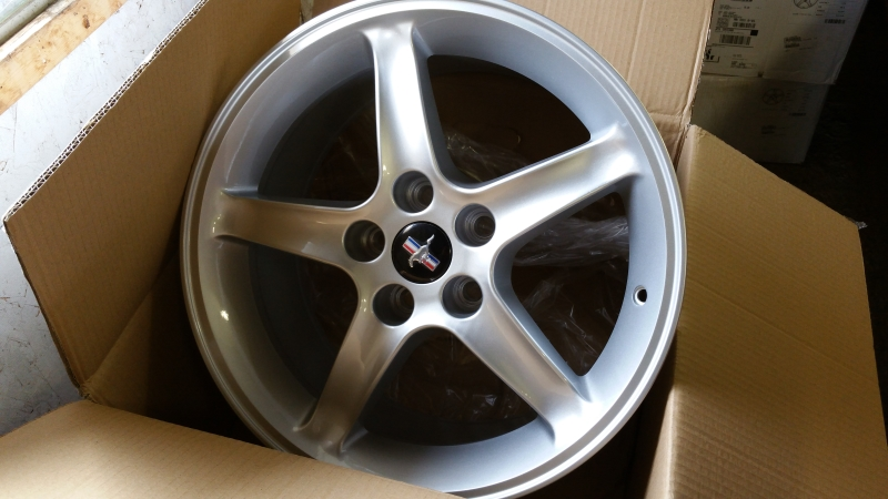

) Finishing clean up on the wheels and thinking about tires. My plan is to go with https://www.firestonetire.com/tire/firehawk-indy-500/245-45r17 to use for the rear but test fit them on the front after the 5 lug work has been done up there and see how they fit. I'd like to run 245 all around but may need to go 235 in the front and 245 in the rear. I'd like to understand how much bigger the 91 wheel well is when compared to the 88. And for folks with more practical experience than I, if they feel that 245's will fit all around. I'm going to be running 1996 - 1998 GT "10 spoke / split 5 spoke" 17 X 8 wheels.
