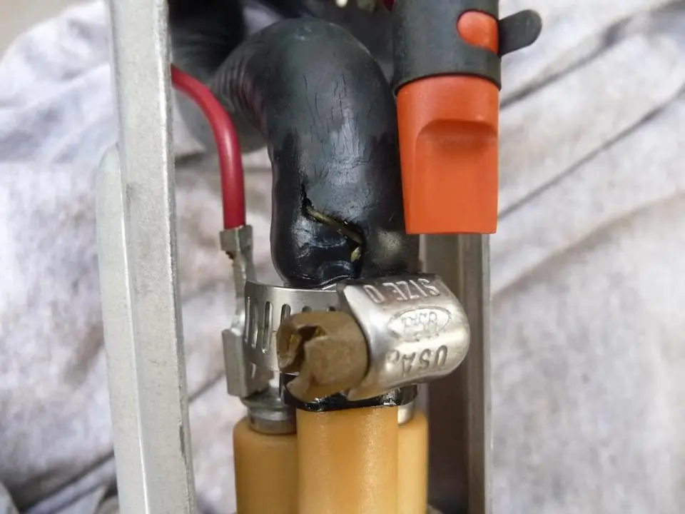

Whether you find the a kinked line or not I would also recommend checking the hose that connects the fuel pump to the sending unit inside of the tank. It’s common for them to rupture with age. Mine did and here’s what it looked like. It caused my fuel pressure to be low and surge.
