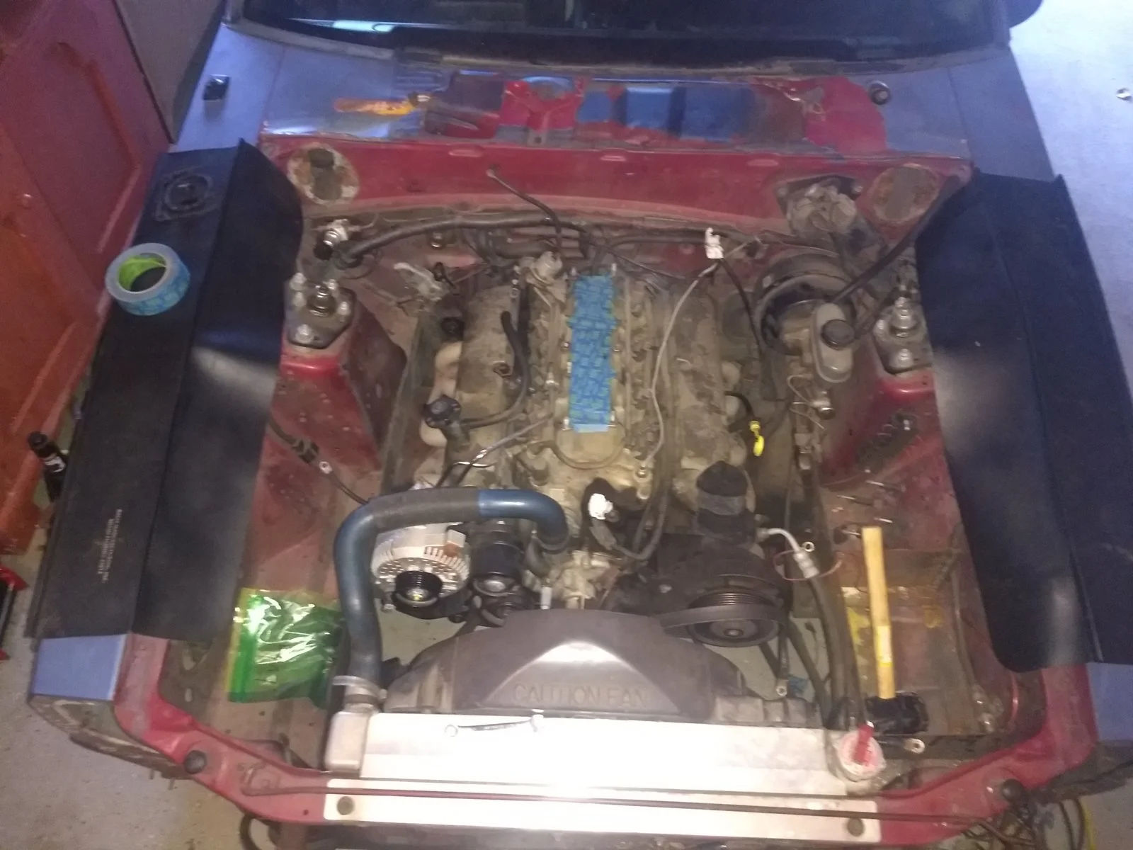

I plan on pulling the engine this weekend, and agree one of the first steps is going to be to pull the oil filter. Lets see what we find in there 1st before tearing into the bottom end.

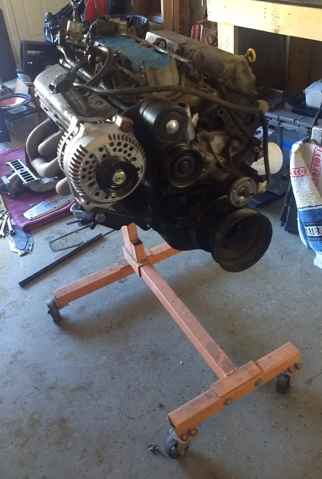

So I was able to get the engine out today as planned. I did cut open the oil filter like Mike said and there is only a small amount of metal in the oil. I am really hoping I caught everything early. So I have the engine on the stand and the oil pan off to drip everything to be flipped over tomorrow. I will be pulling the rear most main to check the bearing and see what it looks like along with the rod caps.
I am hoping it was just the rocker that was rubbing on the valve cover that caused the metal in the oil. Only way to find out is to check the bearings. Still thinking of pulling the heads as I still don't know what heads there are since they have no markings to research.
Also a bit of bad news is that I was told the engine was a 331 and it's not. It clearly has a Ford stamped crank in it so I bet it's just a plain 306.
Currently thinking to just replace the bearings if needed, replace the oil pump since I have a new one (Does the oil pump make the oil pressure?) Due to the lower oil pressure when hot. Also take the heads off and rebuild them with new seals and lap the valves for good deal. Figured this would be a good idea for the plans of the 76mm turbo that's being put on this engine.

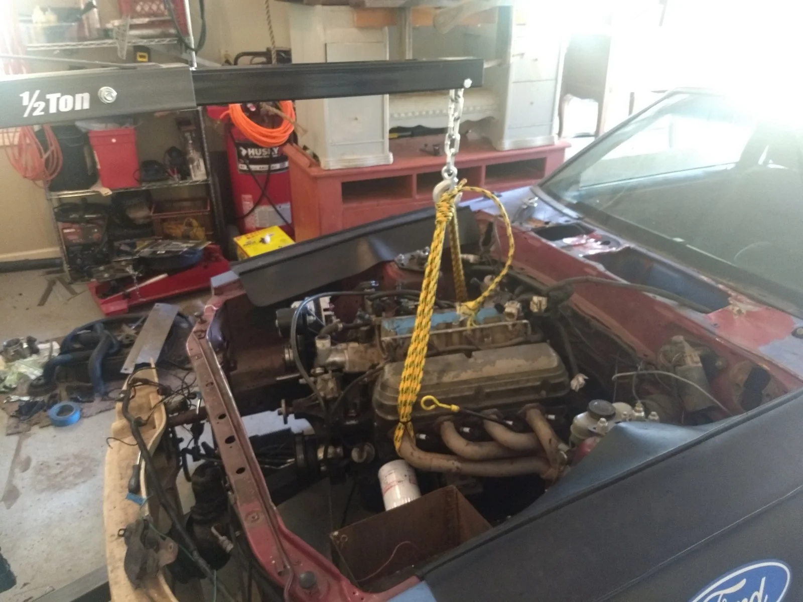

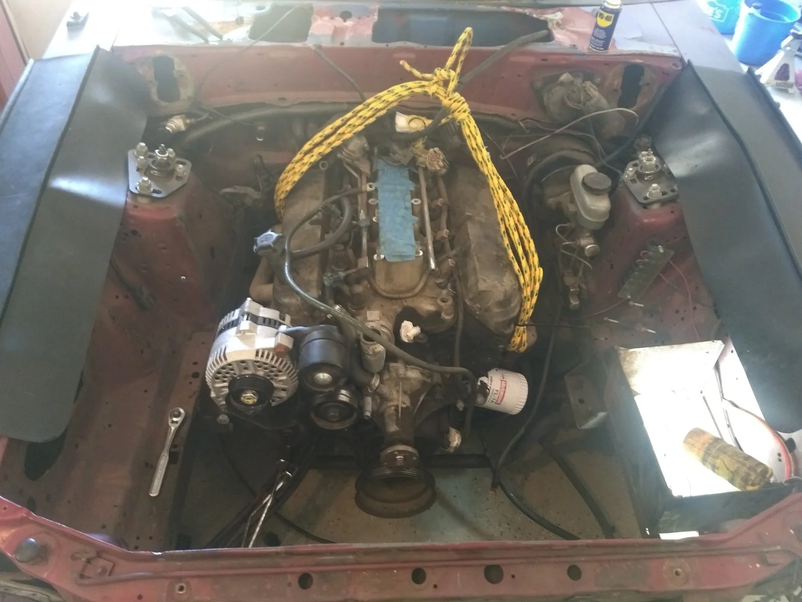

I like the mtn climbin rope that has been doubled, tripled, and maybe quadrupled......
" Chain?!!! I don't need no stinkin' chain!!, I got me some mountain climbin rope......it's like spider string!"
Why thank you Mike... The chain that I had was really f**in big and long, so I decided to use the climbing rope that worked perfectly around the header tubes. Yes, it is for sure quadrupled and zipped tied if you look closely so it didnt slide around.
This is what you get when you live up in the mountains like I do :)

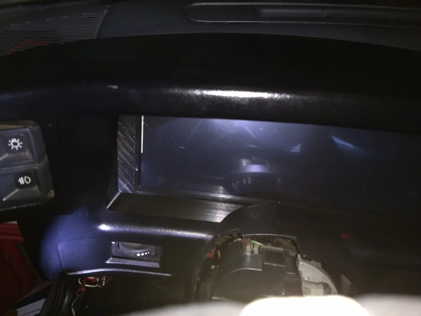

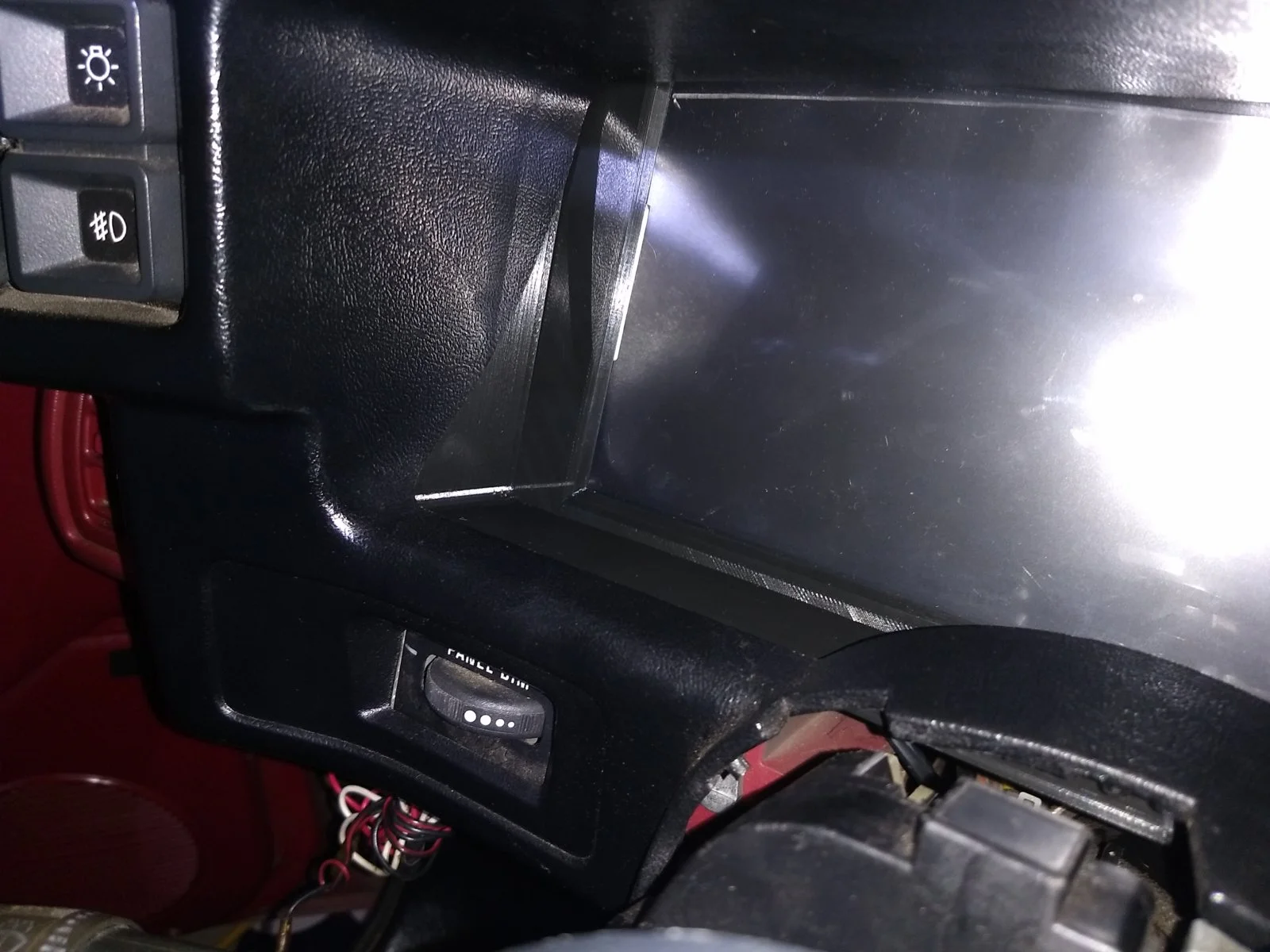

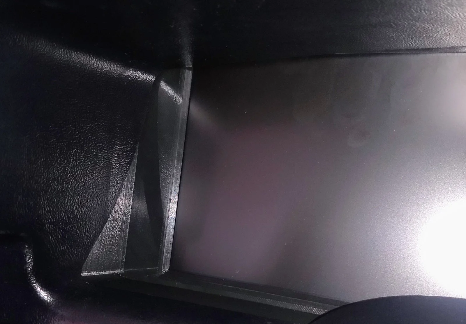

Slowly but surely I am making additional progress on the latest Digital Dash. I am now in the testing/fitment stage of the project, which provide a couple additional modifications to the bezel. The bezel needed to be trimmed on the left side due to the dimmer switch coming in contact with the bezel. I also decided to not use the factory bezel, and spaced the screen further forward so its not as far back. I will be printing the (2) sides and the bottom to match the factory bezel.
Here is a picture of the current installation:

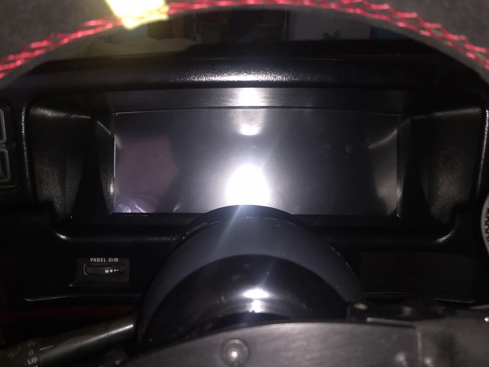

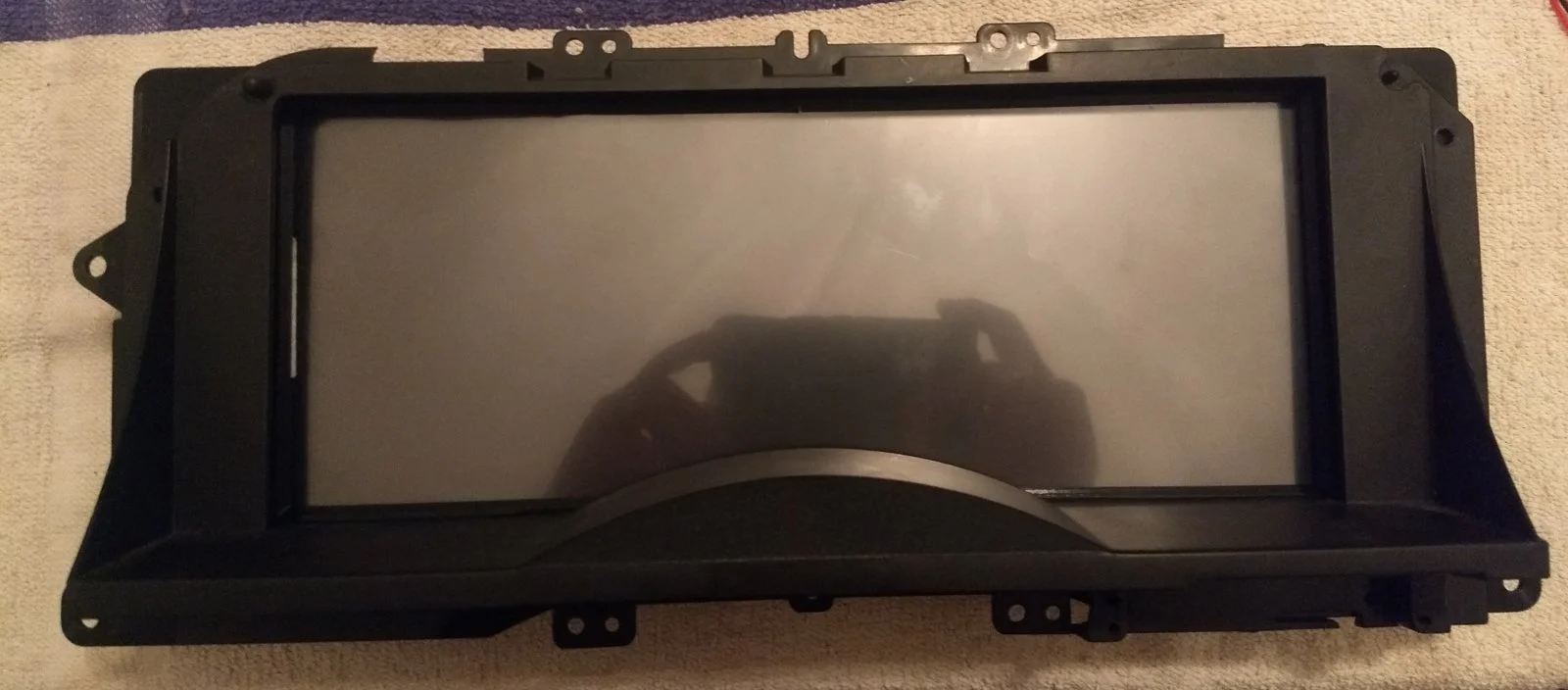

Worked on the side and bottom cover like the factory bezel. I have it modeled up but still need to slice it in half to fit the printer and add the screw holes to mount it from behind.

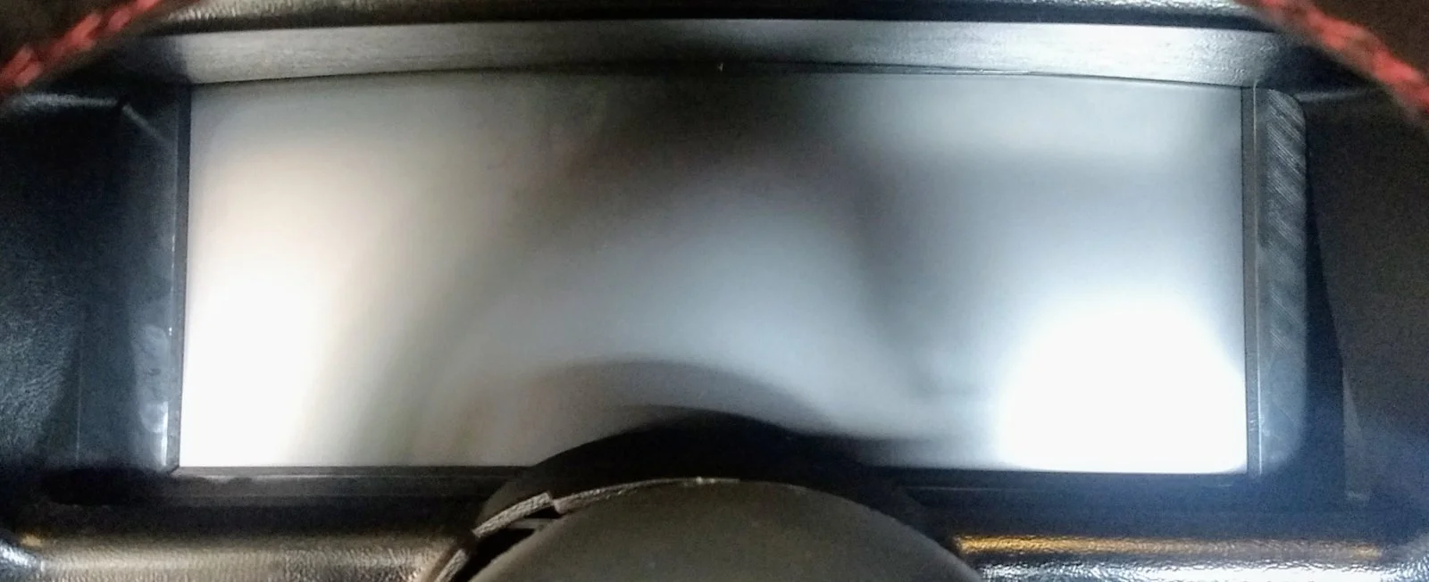

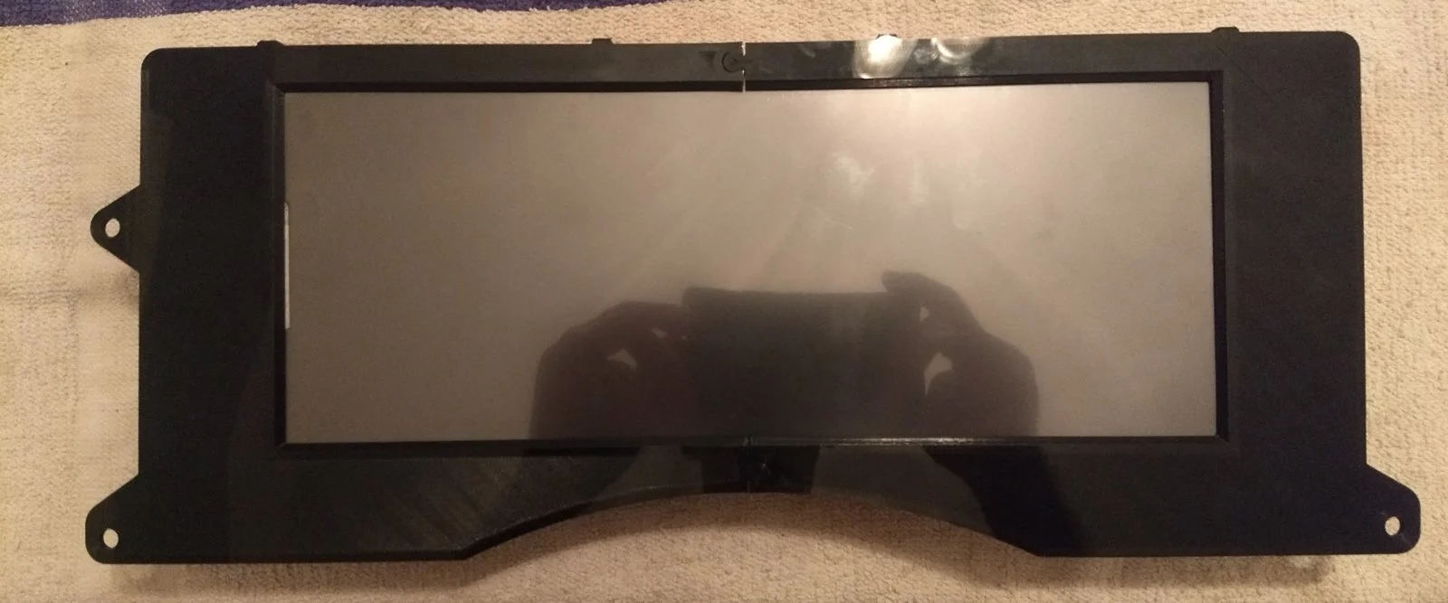

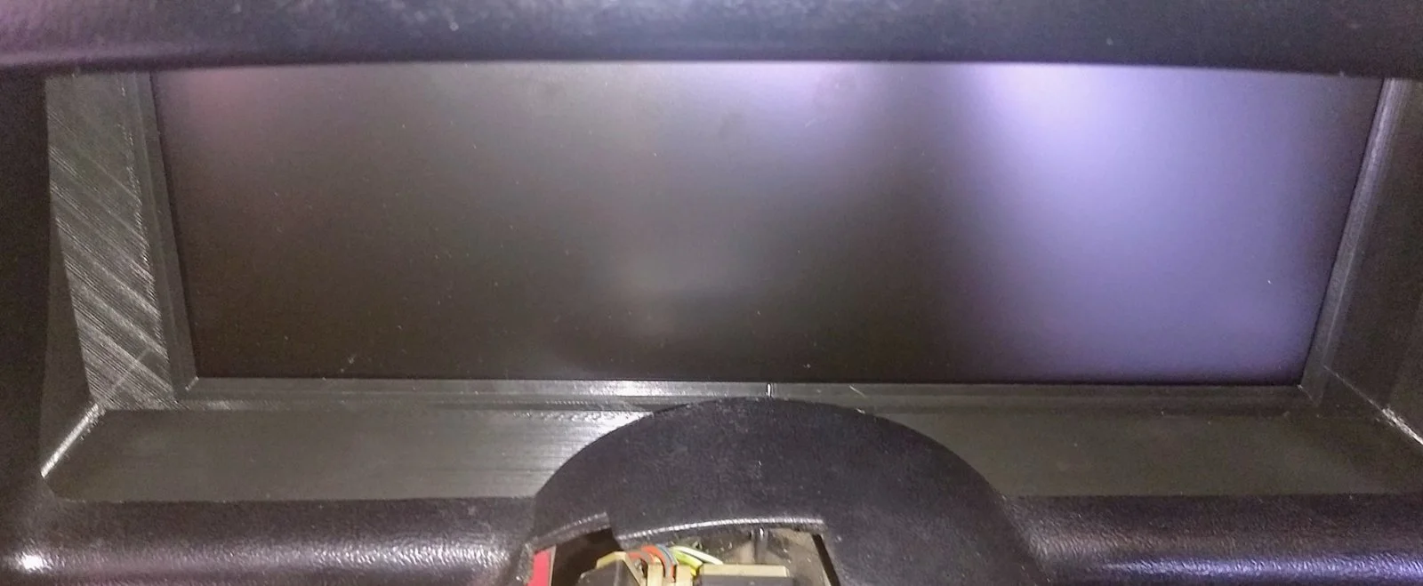

I did make some pretty good progress on the dash. The bezel surround fits and looks awesome IMO. It has the factory look that I was going for. I now have both sides printed and needed to reprint the bezel again for the screws bosses and additional length on the left side mount screw boss.
Did anyone ever notice that there factory instrument cluster doesn't mount level left to right?
I added 5mm additional to the left side over the right to level it out.
Sorry for the dark pictures doing it at night. I should have better pictures for everyone tomorrow when I have it all printed and remounted to the dash.
