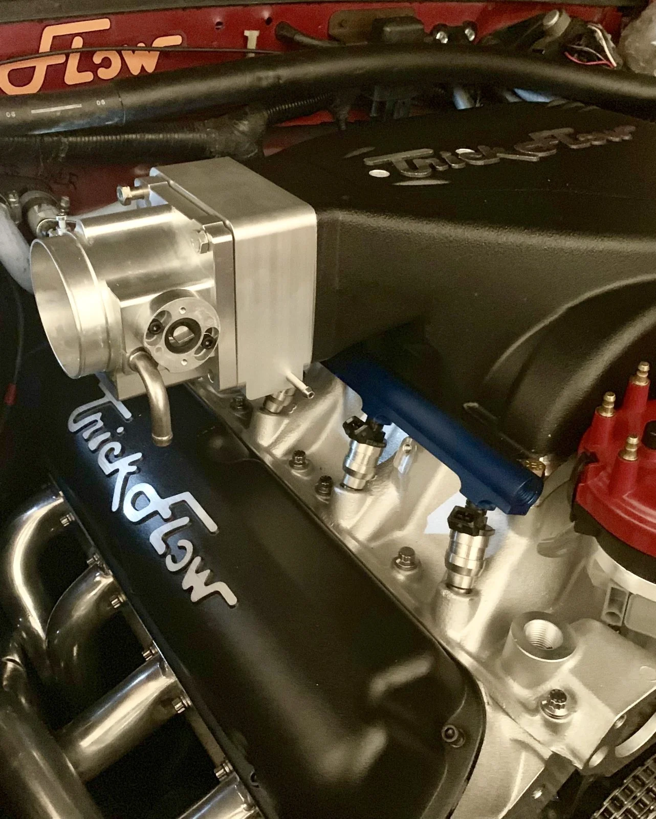

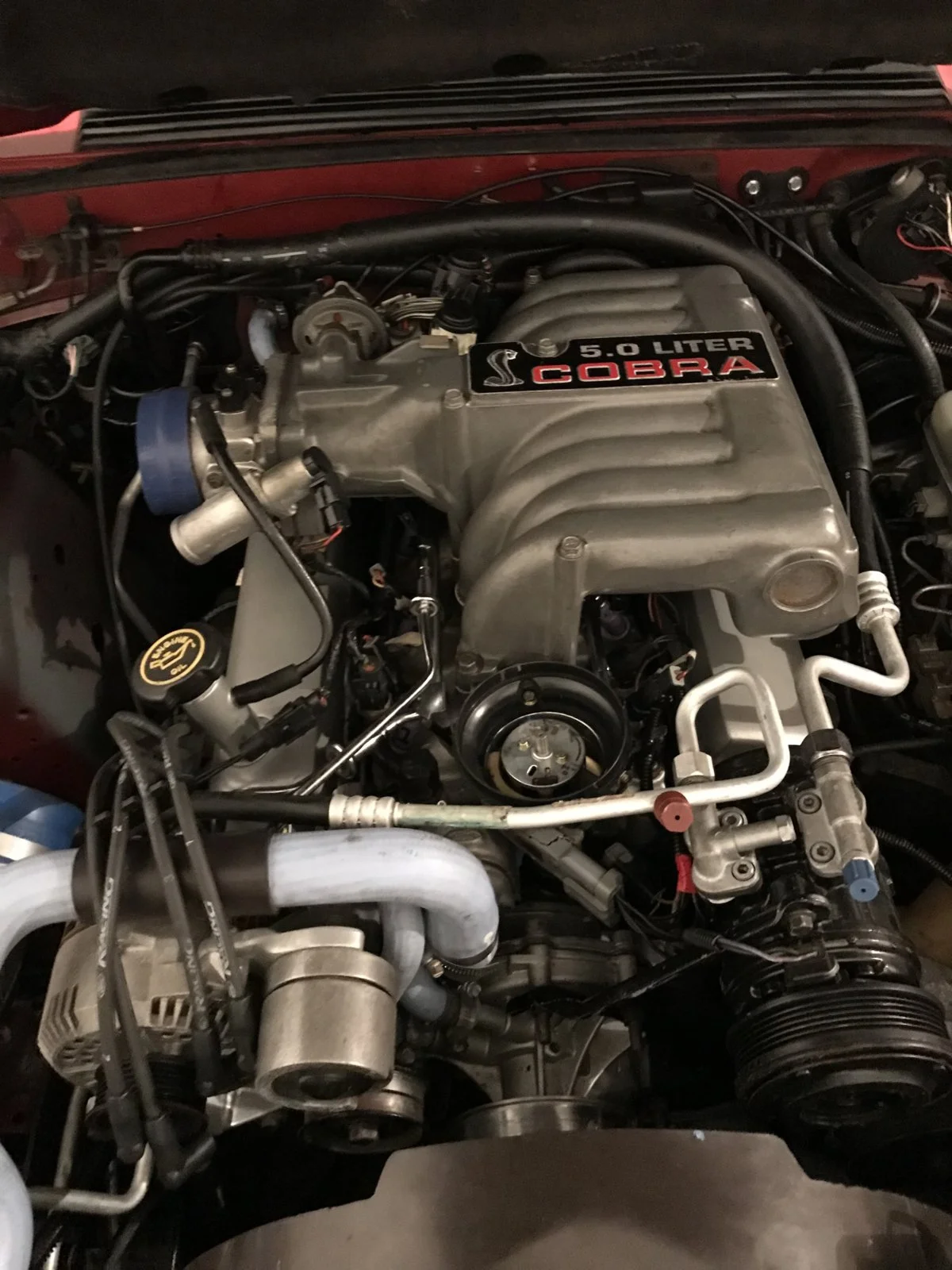

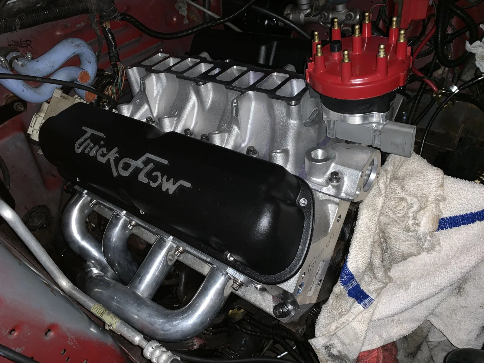

I’ll drop a few pic’s of a SBF a guy had put GT40 heads, Cobra upper, explorer lower, E303 Cam,1.7 Roller Rockers, etc. Major issues. So, offered him this alternative..
Trickflow top end kit went on in, St 2 cam, rolled main brg’s in, #30lb injectors, longtubes, SLP loudmouth Exhaust., MSD pro billet Dizzy -maybe a year ago, 120k on it. Cleans up nice, about 3 grand & labor.
Was 320 HP last dynotune pull & Runs great, 3.73’s in, otherwise, all suspension work & brakes done, lowered, bumpsteer kit. Drives 60miles twice a day, long commute, around 20mpg, yet runs 12’s.
