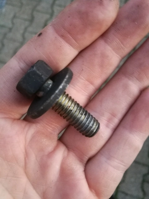

Hi there i just did some rust repair and removed the engine, when putting everything back together i was left with this bolt.... engine and tranny came out in 1 piece, the bolt is 9/16 and about 4 cm long
That bracket your asking about is bolted in the same place the battery ground wire is. The bolt in the pic is the top alternator to bracket bolt.
The bolts that hold the brackets for the starter cable do not have washers on them.

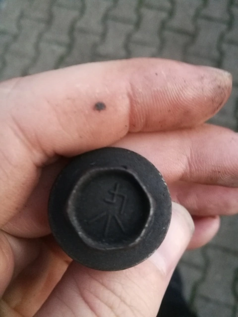

Does it have metric or US threads?
If metric, that's a A/C compressor mount bolt. The A/C compressors are all made in the Far East and use metric fasteners.
