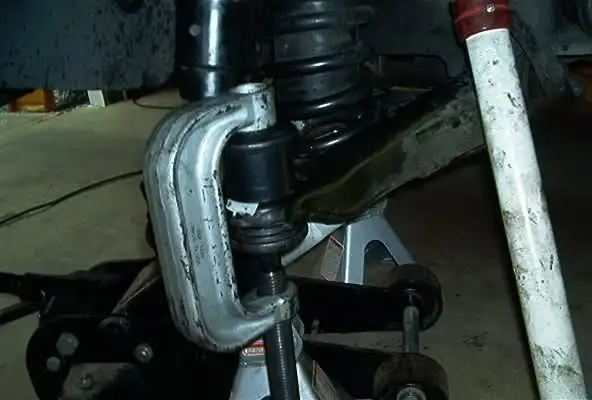

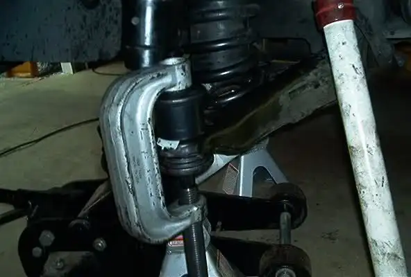

Here is the balljoint press that I used:
In that pic I am pressing the new balljoint into place. I got the press from Autozone (Part# 27023) as a rental with a $100 deposit. There are instructions on the box and it is really simple to do. The fox ball joints are NOT welded or rivited in, just make sure you grease the new balljoint and lower control arm when installing. I also grabbed a pickle fork (Part# 27020) to seperate the spindle from the balljoint. Again, Autozone rental with a $15 deposit. Make sure you get new ball joints with zerk fittings!! Good luck.

Tom, I have replaced the lower ball joints. The press you mention does work (looks like a Big C-clamp with some adapter bushings). BUT:
