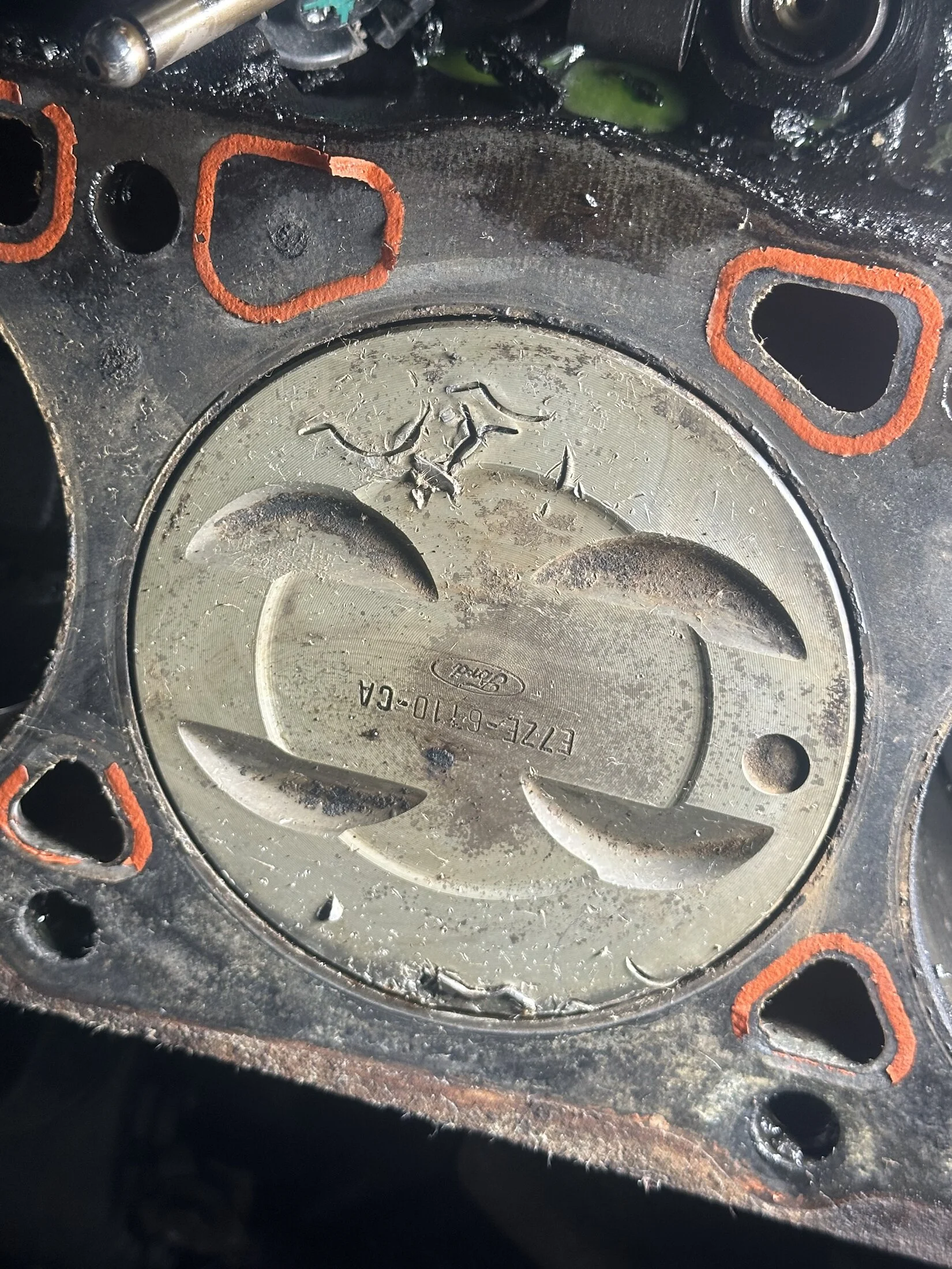

Super late but wanted to give an update. I ended up taking the head off to look at the pistons. Looks like some kind of metal got into the piston while taking everything apart (no clue how it happen). The car did set outside for about 10 years. The oil filter and spark plugs were fine. The rods and rocker arms seem good also.
A had a guy look at the piston and said it should still be fine. In the process of cleaning everything up and putting in together now. Appreciate all the suggestions and advice
