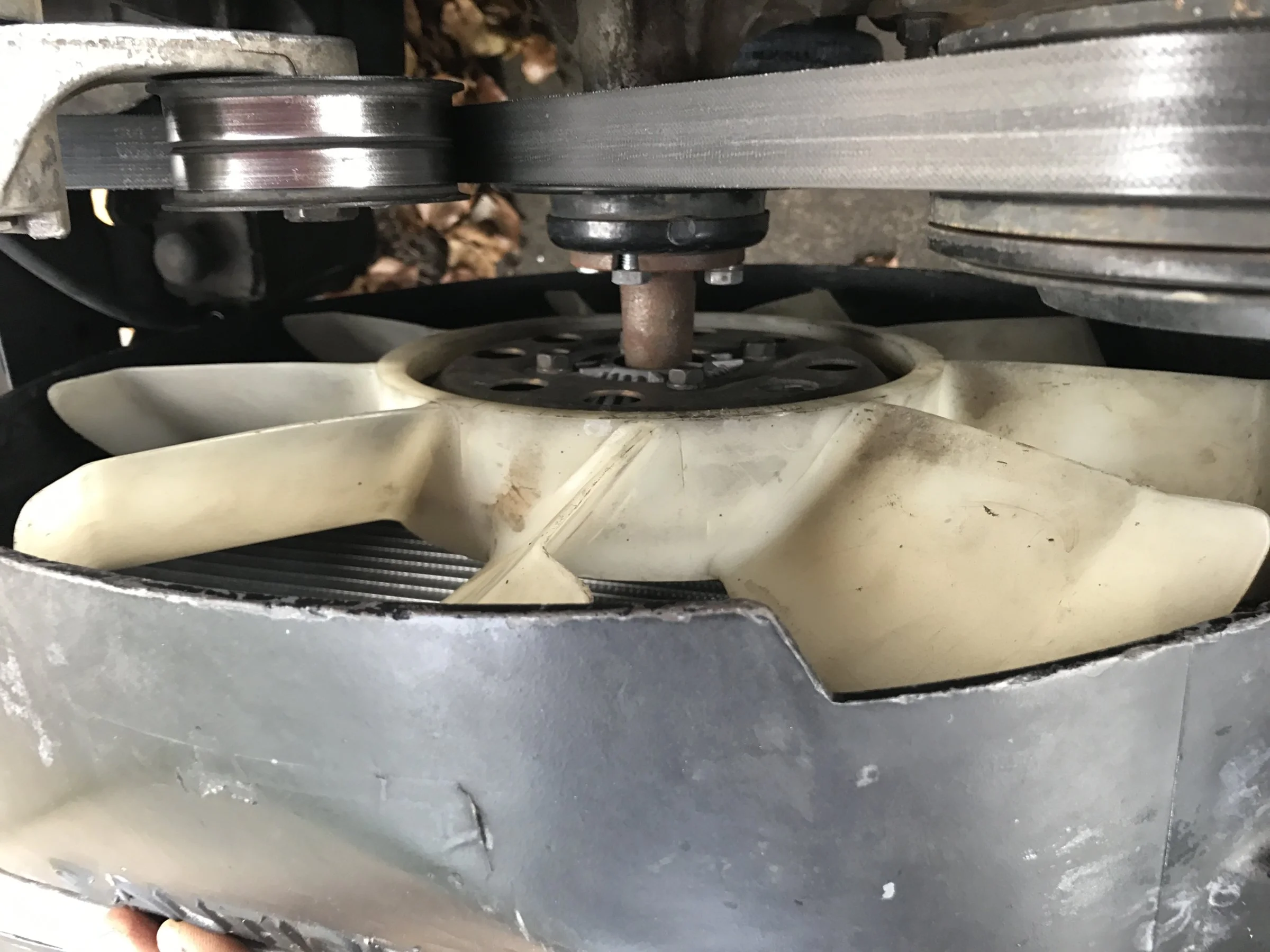

I assume it's the stock clutch fan setup? If so, with engine off, grab fan and spin it. Does it immediately stop and have resistance, or does it freewheel very loose?

I'm assuming that this fan is stock? And it spins maybe a quarter of a turn?

You have a stock fan/clutch and if it has resistance, cold, than it is likely ok, 1/4 turn, stop, it's good.

Yeah before I couldn't get it to hear up it ended up being there was no thermostat in the housing. Now I put the thermostat in this is happening. Yes I'm using a glowshift water temp gauge. When I just spun it it was warm and did 1/4 of a turn?

When the car is warm the fan should be pulling pretty hard. That fan clutch is probably almost 30 years old....a new one couldn't hurt. They aren't real expensive.
Yes, that is the stock fan. Should move plenty of air so I don't see the need to change to an E-fan until this issue is solved.
