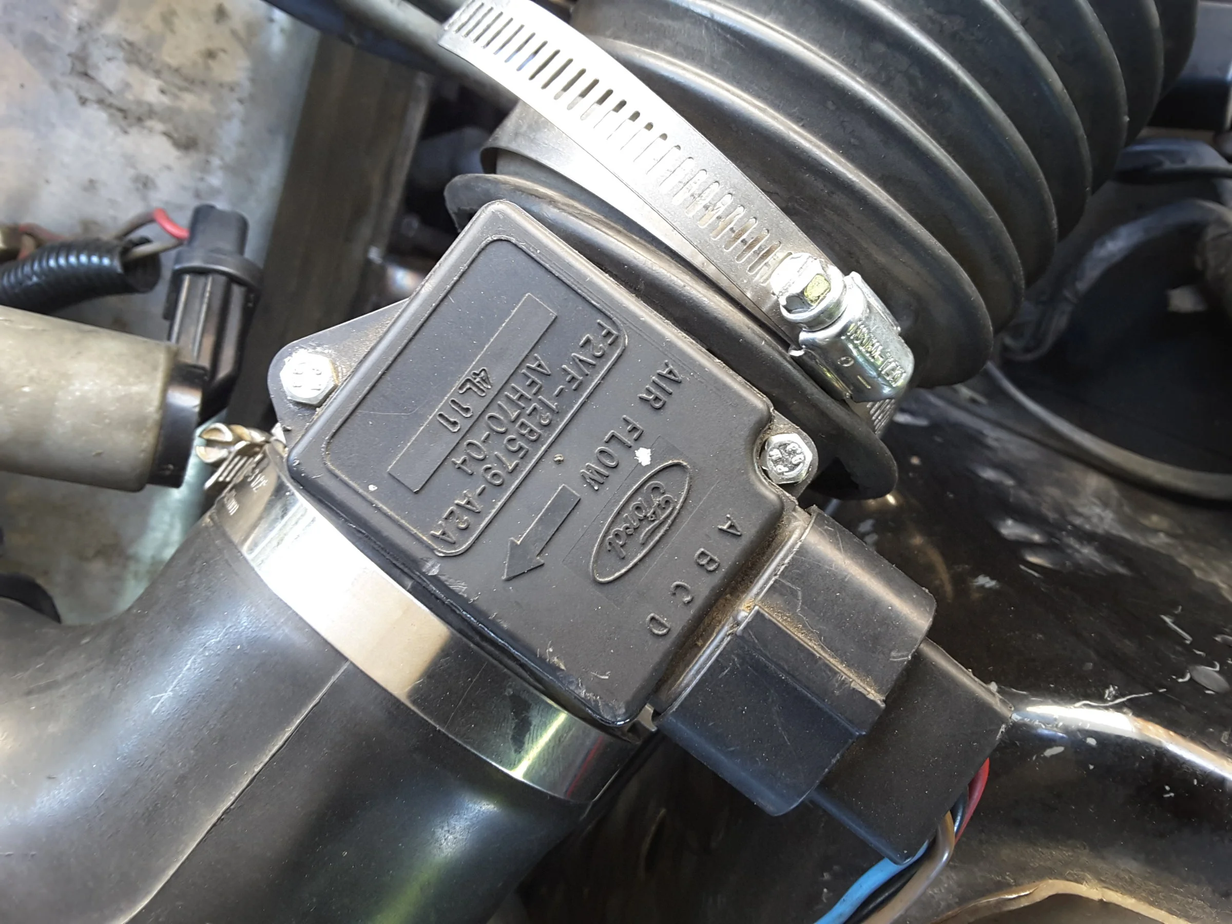

I initial thought is the MAF might not be communicating correctly, but pull the codes first. Also what is the part number for MAF sensor you have on the car atm, and do you have the old one to stick back on to try?

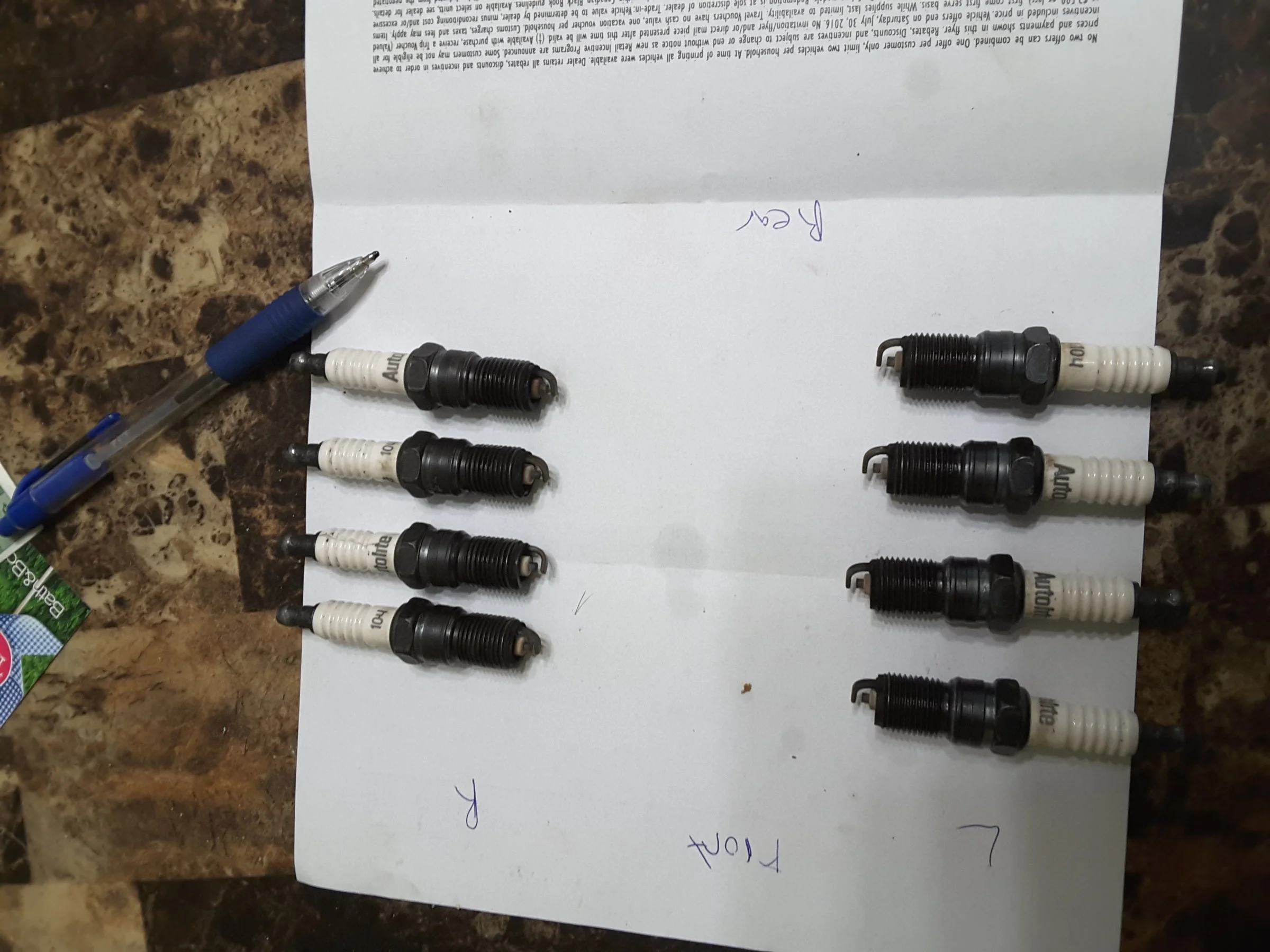

I'm kinda new and don't know how to get to test have section sorry about that. I checked codes and I get code 31 and 95. Have new plugs in it. I can post pictures after. Also this problem came up before I did maf conversion. I did the conversion to fix this problem. Has different wires. I checked all vacuum lines and there all brand new. Idle is OK it has a little miss to is

Did this problem occur after the fuel pump install because 95 is for the Fuel pump circuit. Also did you use the housing from the MAF or just the sensor (I know you said it had a problem before, but not seeing the flange). If I'm not mistaken that is a Lincoln MAF.
It had a flange I cut it off just to use the tube. And from what I've read the code 95 is because some maf conversions didn't have the wire from the ecm to the fuel pump relay witch don't matter. I replaced the fuel pump relay Cuz it went bad already

One other thing is MAF sensor being used, have you inspected the sensor (pulled it out of the housing and cleaned with maf cleaner (not brake cleaner). Just trying to eliminate everything that could be contributing to the problem.
No I tried 91 octane as week. And the contacts were scraped off a while ago and they look like they got some arcing again. I cleaned maf with maf sensor cleaner. Also I should mention the car ran a bit better set at 15degrees for some reason no ping. I've double checked timing marks and there correct to TDC. I even tried pulling spout setting it at 30 degrees and it was worse yet
