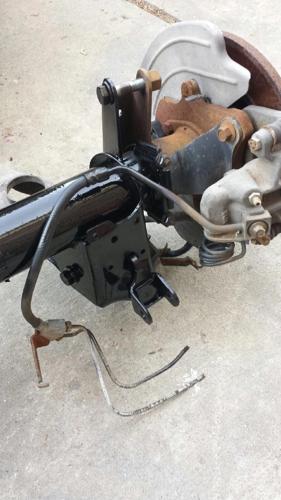

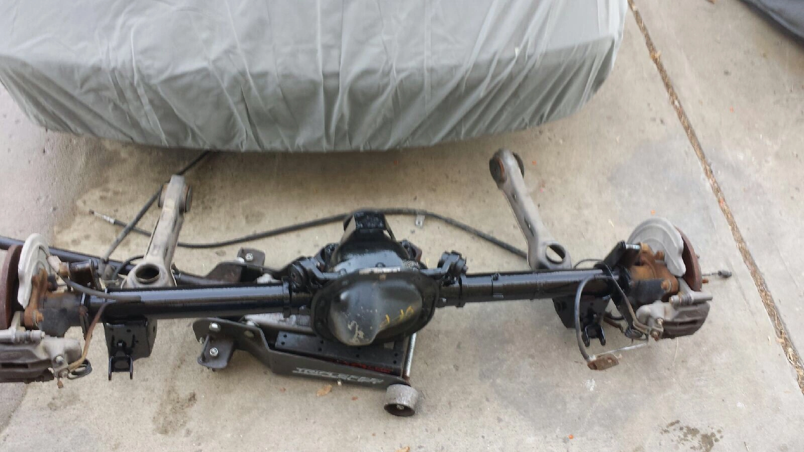

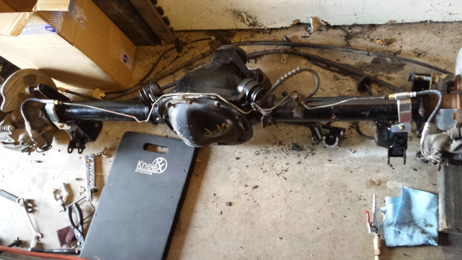

So looking at the axle I need to figure out how to connect the 8.8 brake line to the 95 axle here are some pictures
You are kinda going to create a hybrid line setup on the axle.
94-95 rear brake soft lines. They come with mounting brackets that bolt to the axle.
In the center, install an 87-93 v8 center brake flex line and mount.
Between them, either bend some pre-flared lines with adapters, or custom bend your own. Fox axle lines will work with weather head 7818 adapters. I don't know the size off the top of my head of the adapter.
