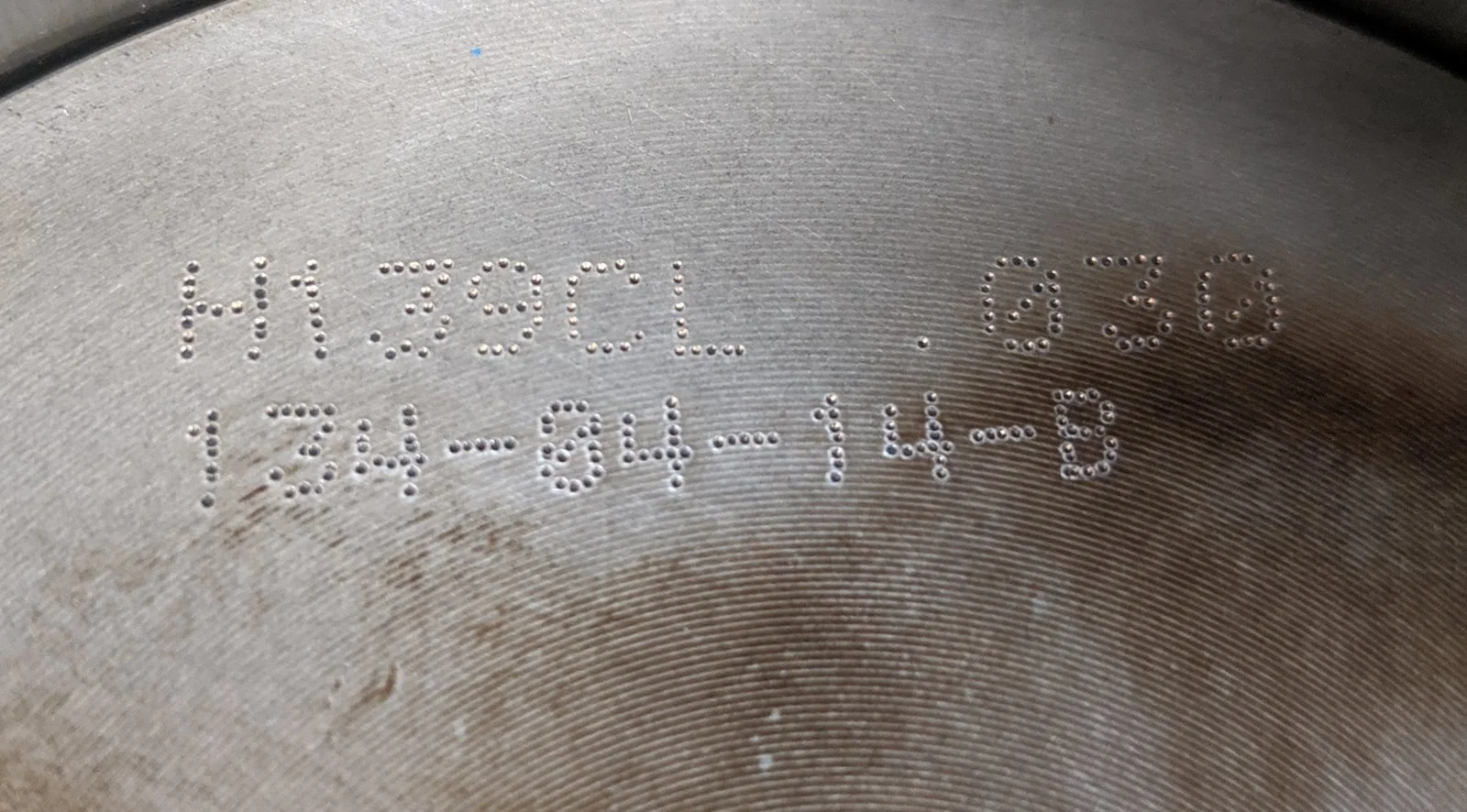

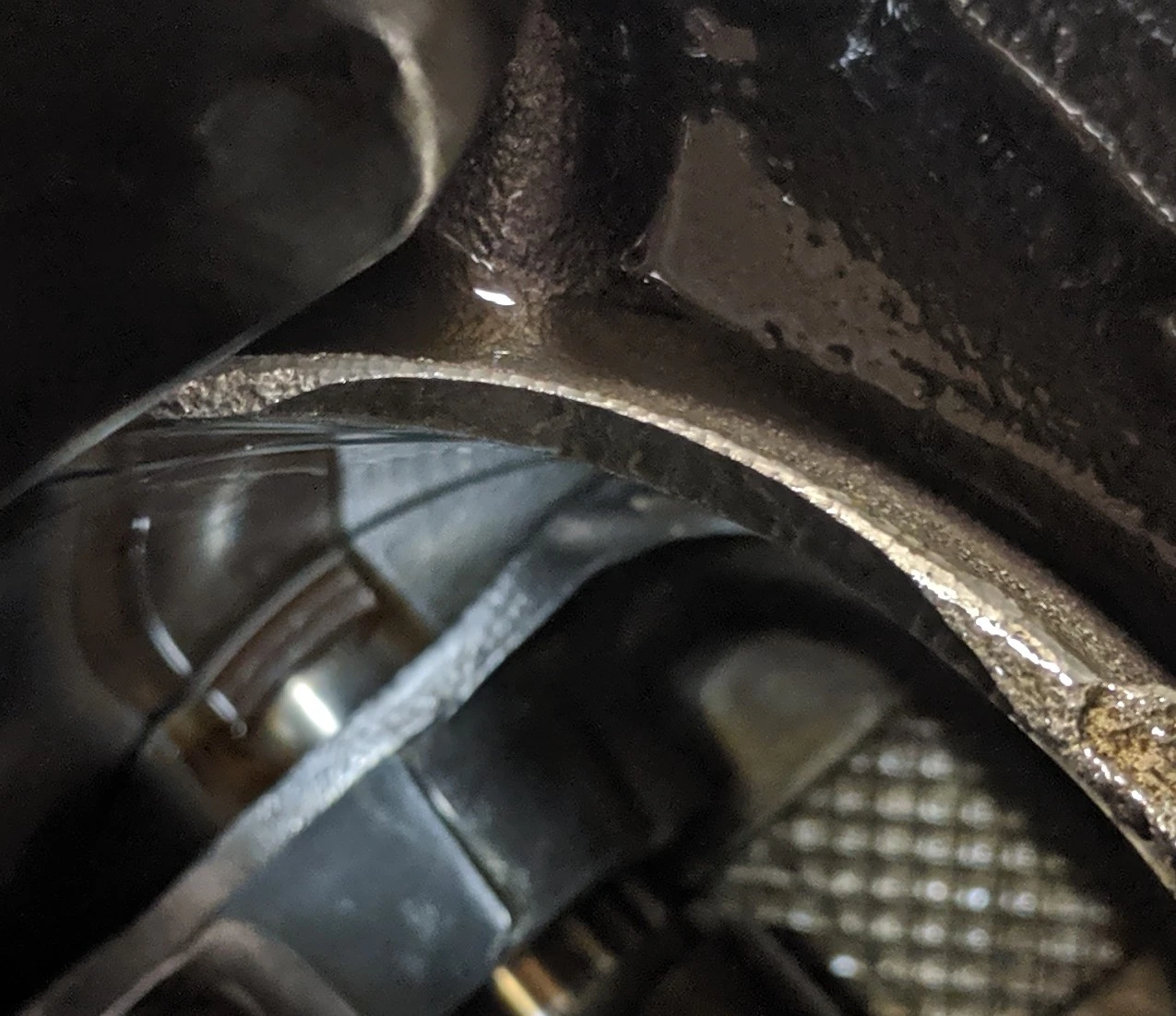

Stroke seems to be 3.4" though I have no reliable way to measure exactly at the moment. Definitely more than a 3" stroke. The bottom of the cylinders seem to be clearanced, though not nearly as much as I have seen on some. Nothing hits though. It has been bored .030 by verifying the Piston stamp. Any thoughts?

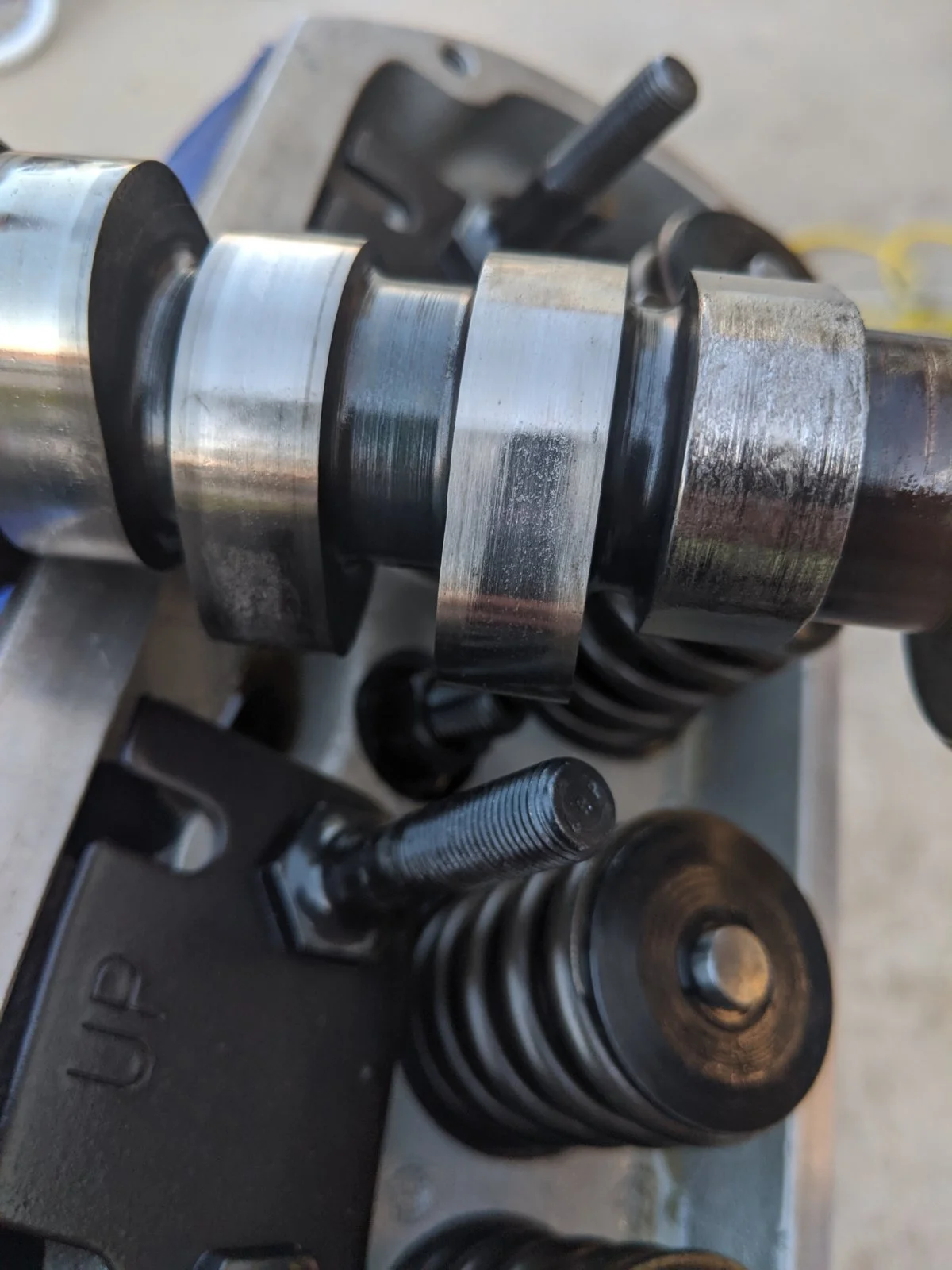

Cam was as bad as I thought it would be. Found some metal in the oil pan. Going to check all the crank bearings and then clean it all up before rebuilding.

Does appear to have the stroker notches cut into the bottom of the piston bores.
Do you have a caliper with a depth measuring probe on it? Drop a piston to the bottom of the bore and measure that way. 3.4" is a 347 and 3.25" is a 331.
