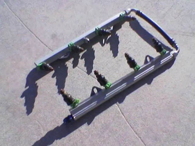

I hear what your saying. Let me know when your ready for that jump. I have a serious aluminum fuel rail and 42# FORD injectors that I have no use for. If your looking to trade something keep me in mind. I don't mind being a bottom feeder and accepting handme downs :)
If your intrested I'll take a picture and send it your way.
What kind of money are you talking? I can always start stockpiling parts now. hehehehe.
I would prefer to trade for something that my Saleen could use. Saleen specific parts, Vortech pulley, larger MAF, adj fuel pressure regular, ford motorsport spark plug wires. coil cover that shows the vacuum line routing, rear coil over's, better front calipers and rotors.
You name it, I probably could use it.
