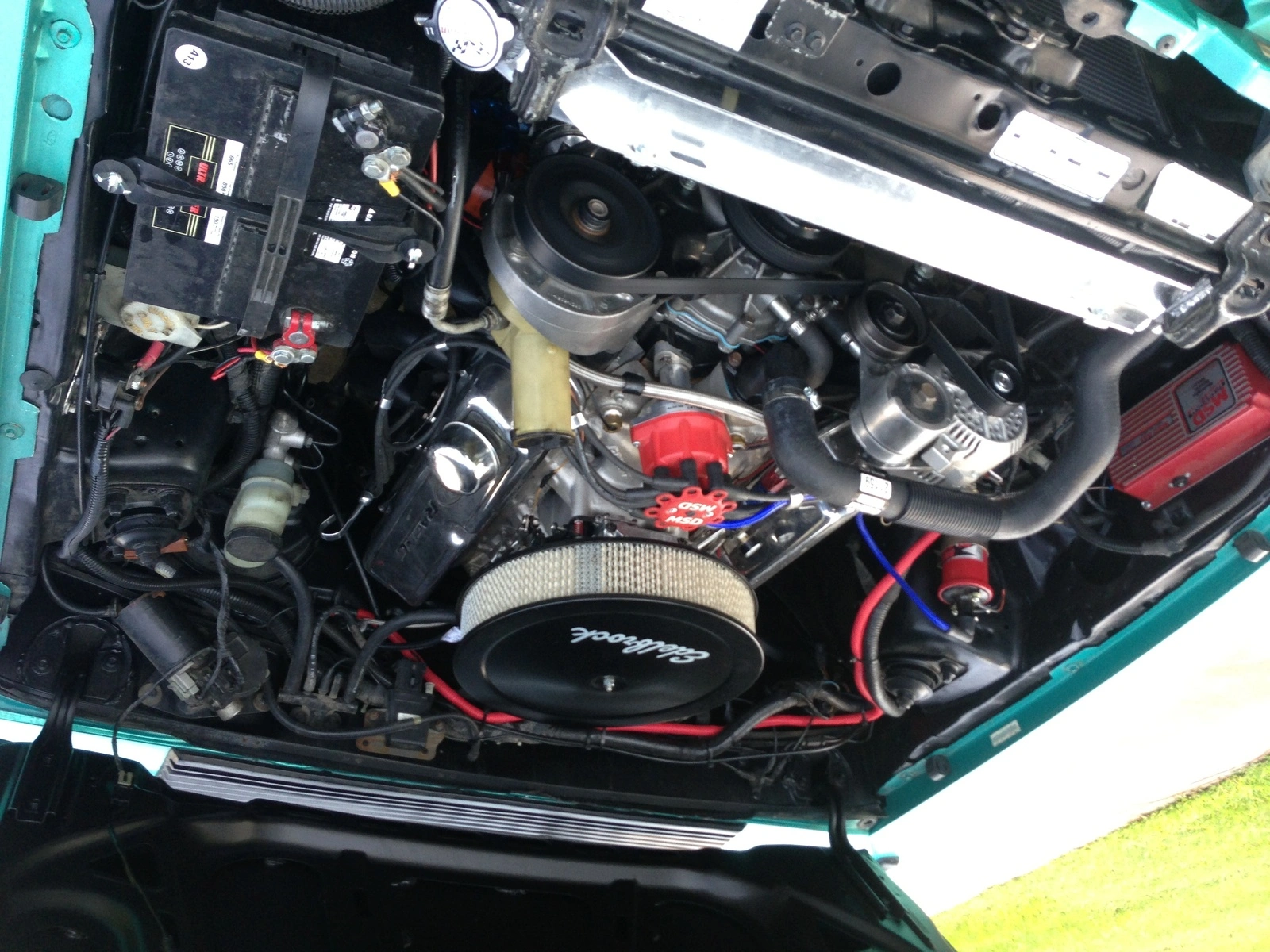

Looking at the photos: I see diff pulleys and water pump on the motor. Did you go away from the underdrives pulleys UDP's? And What water pump did you finally use?

The reason for the change in pulley is if you look in the pic of the motor in the back of the truck, it was on its way to the dyno guy to tune it so i had to come up with a set up to just run the water pump. best option was to run an old v belt set up, water pump is ford racings hi vol pump. Now it has the udp set up on it(got new pulleys because the sliver ones in those pics were worn out from 70k miles.....

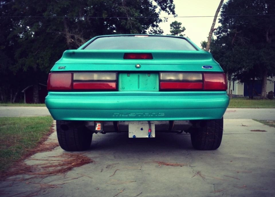

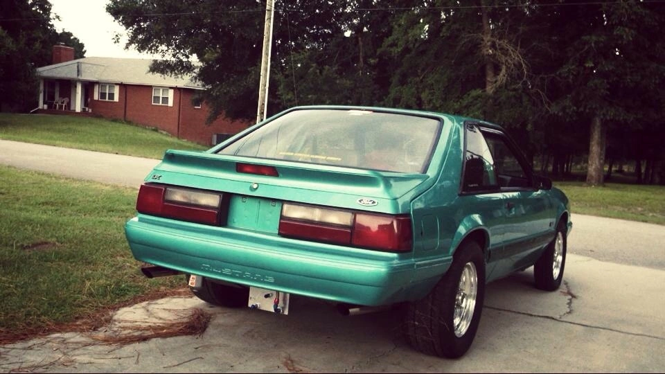

Car is running driving, motor is in brake in period so no 1/4 mile passes yet. Tore back in go the motor, larger heads/more aggressive cam, went to 1 3/4 headers, also upped the jets on the carb and took the motor back to the motor dyno. 515hp 502 tq at the flywheel. Also dialed in the HGM Comp-u-shift computer, that unit is worth every penny if you have a plated race car. Makes driving on the street comfortable and lowers et's and 60ft times at the track. Amazing that you can lower and raise the trans PSI for each shift and also change shift points based on rpm or mph or both along with throttle %.

Finishing up a few transmission issue with the 4r70w and Comlushift 2 I put in but other then that the car is running nice, just need to finish break in and start installing the cage.
