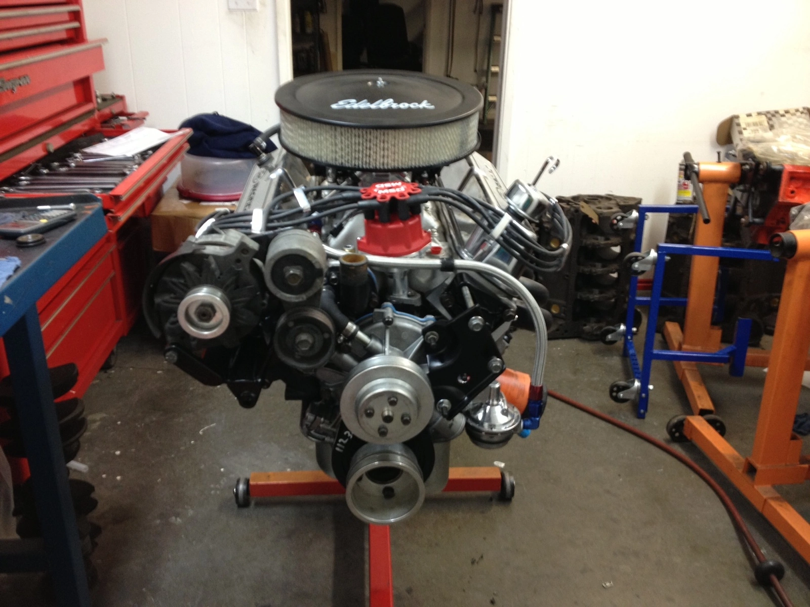

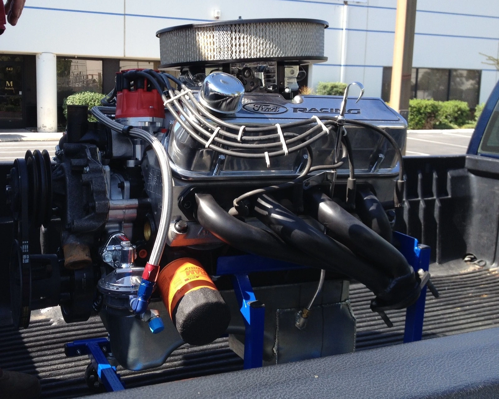

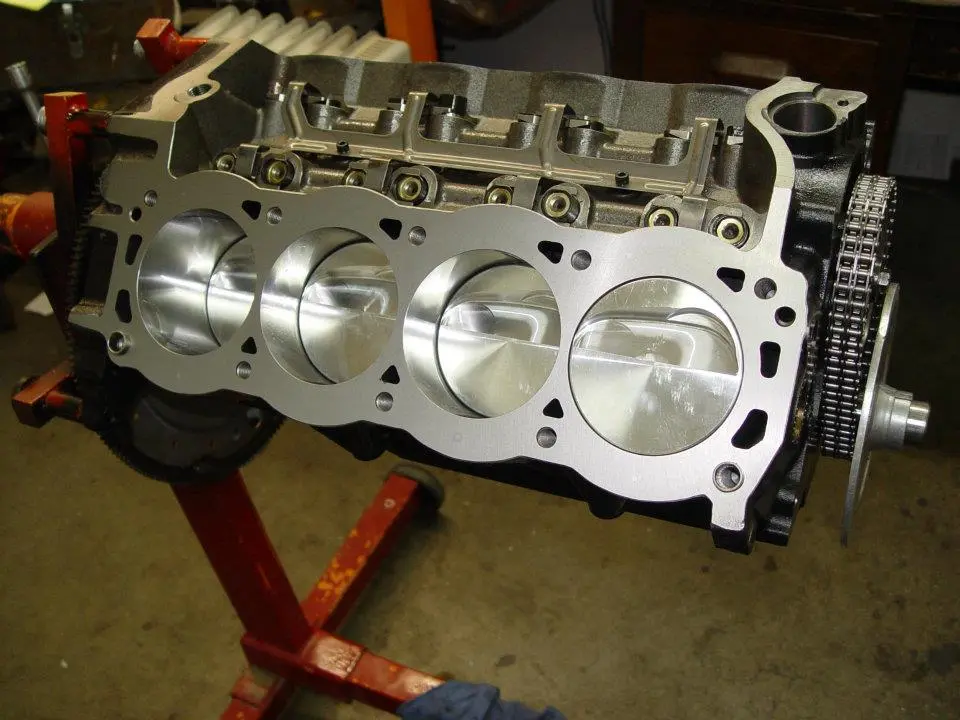

Just got the motor back from the Dyno guy, 446hp 436 ft/lbs on 92 pump gas
  • 92 5.0 LX Hatch
  • 127,000 on body
  • Dart SHP 4 bolt main block

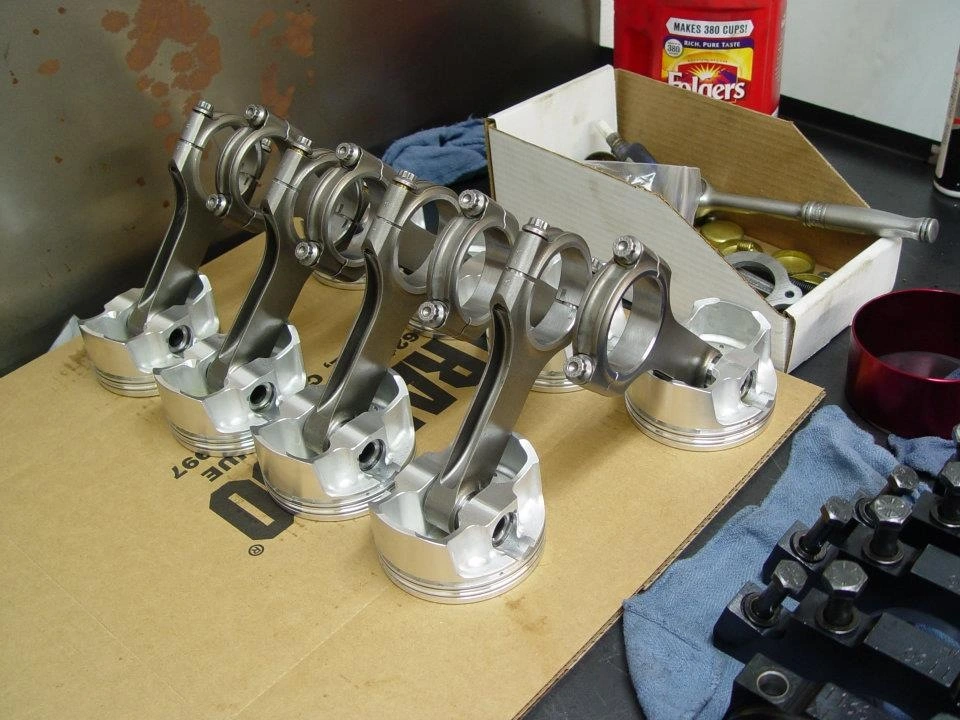

  • Bored to a 331 and stroked to a final 347 (the safe way to a 347 so the skirts dont drop out to far)
  • Scat Crank and Rods CP Pistons all blue printed and balanced
  • Edelbrock Air-Gap Intake
  • Holly 650
  • all -8 lines from carb to fuel cell
  • BeCool Radiator
  • Felx-a-lite Dual Fan
  • Gen 3 Charging system
  • Fuel Cell
  • Mech Fuel Pump
  • Ford Racing 1 5/8 Headers
  • BBK Off Road H Pipe
  • FlowMaster cat-back
  • AOD-E Trans with Comp-u-shift
  • Converter-Precision Industry 9.5” Multi-Disc Lock-Up 2500 stall
  • Eaton Posi Rear end with 31 splines
  • 3.73 gears
  • Weld Wheels with MT Drag Radials
  • Kenne Bell Welded sub-frame connectors
