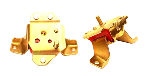

Hope you got the Energy Suspension polyurethane mounts. They will last forever.

https://www.jegs.com/i/Energy-Suspension/355/4-1122R/10002/-1?ymm=4294829838+4294829830+4294829436
