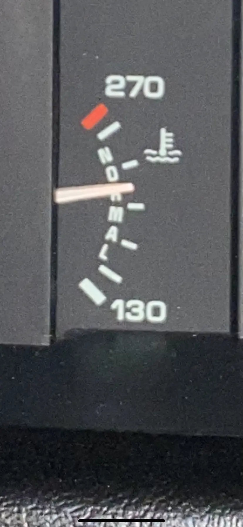

Mine is always between the middle notch and the next one up. I believe that’s normal. She Runs fine.
Reactions: pavlos413
That's where mine is..Thanks good to know. My old one was bad..Maybe. It doesn;t seem that hot
I’d love for it to be dead center. Sometimes it is but most of the time she rides a little bit higher as shown in my picture. Never had any problems so decided not to let it bother me but always keeping an eye to see if it ever increases. That’s why I keep that picture so I can always compare.
I converted to electric fans and they come on at 205. My OEM coolant sensor would show the fans come on at the middle point (as you described). Unfortunately it crapped out and I put in a replacement. I changed nothing else in the system (same fans, same controller, same t-stat). My gauge will now climb to the point shown in the pic above, maybe slightly higher to the O, but my system still cycles as expected and I don't overheat. I have just come to expect that this is the new normal.
Reactions: 91AOD5.0LX
91AOD - that is exactly where mine sits! I was a little bit worried just because sometimes it can go back to dead middle at any point. Good to hear it is not uncommon. I may hook up a mechanical gauge just to get a more accurate number for peace of mind. Right now I feel like I'm always looking at that gauge!

Pavlos... what do you define as hot? You may have no issue and just a factory gauge showing you a high number (that is incorrect).
It's above the middle line, sometimes it's halfway to the next one above and sometimes it goes to the line right above middle and that's scaring me a little especially because there's no numbers on that guage below 270 and I'm wondering how hot this thing is actually getting. I think I'm going to get a temp laser scanner and check the thermostat and the hoses to read where it's at.
