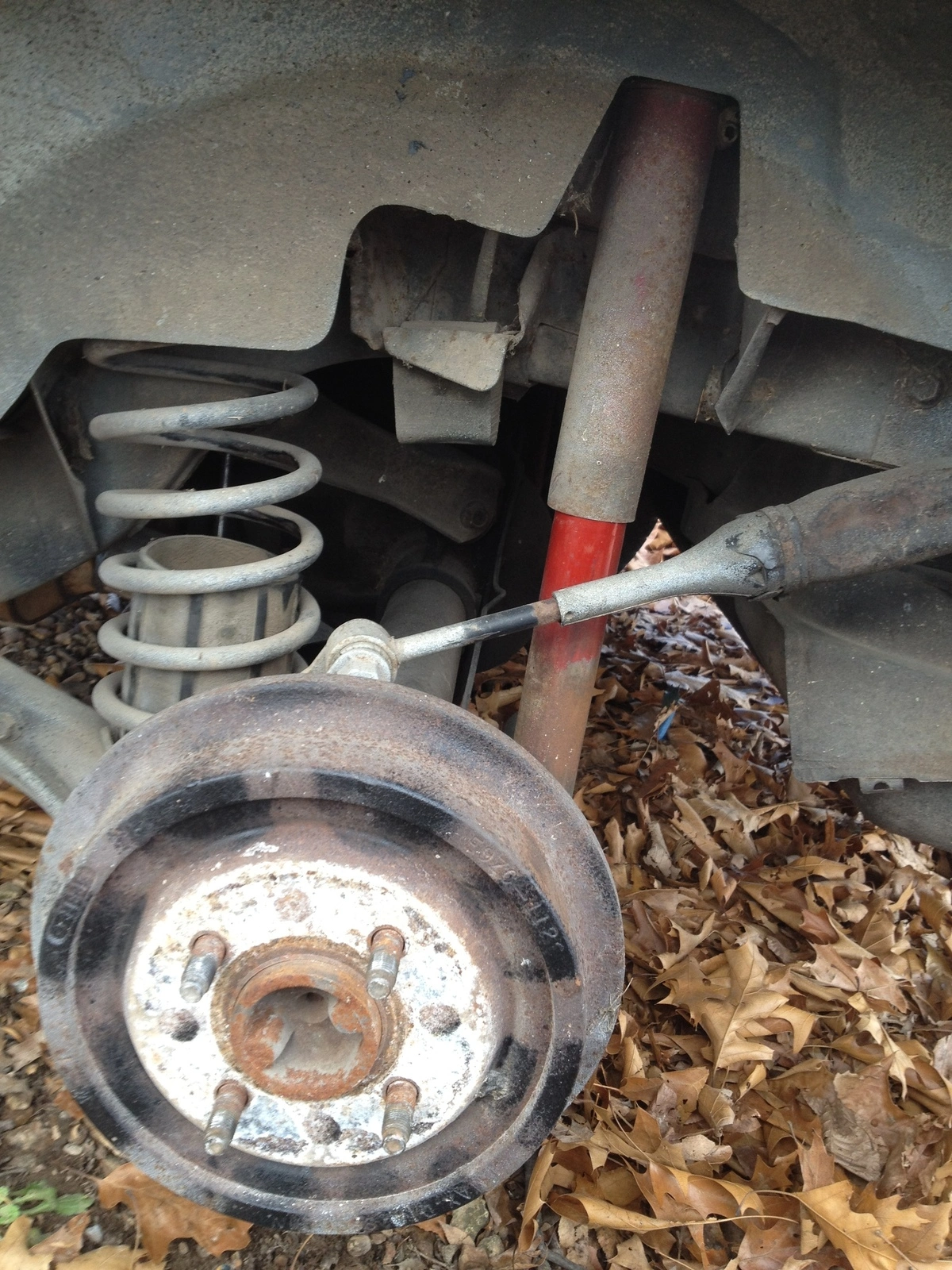

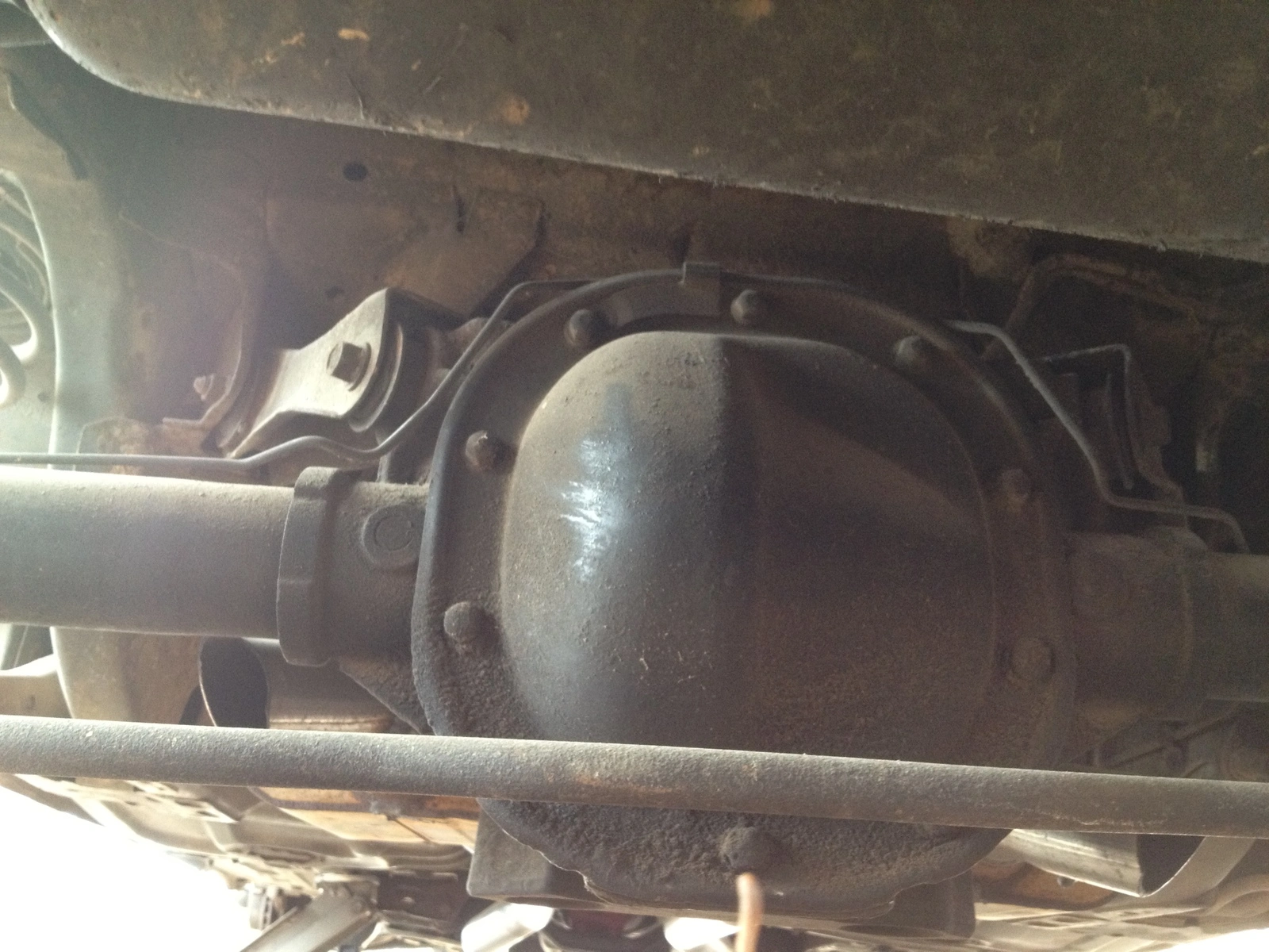

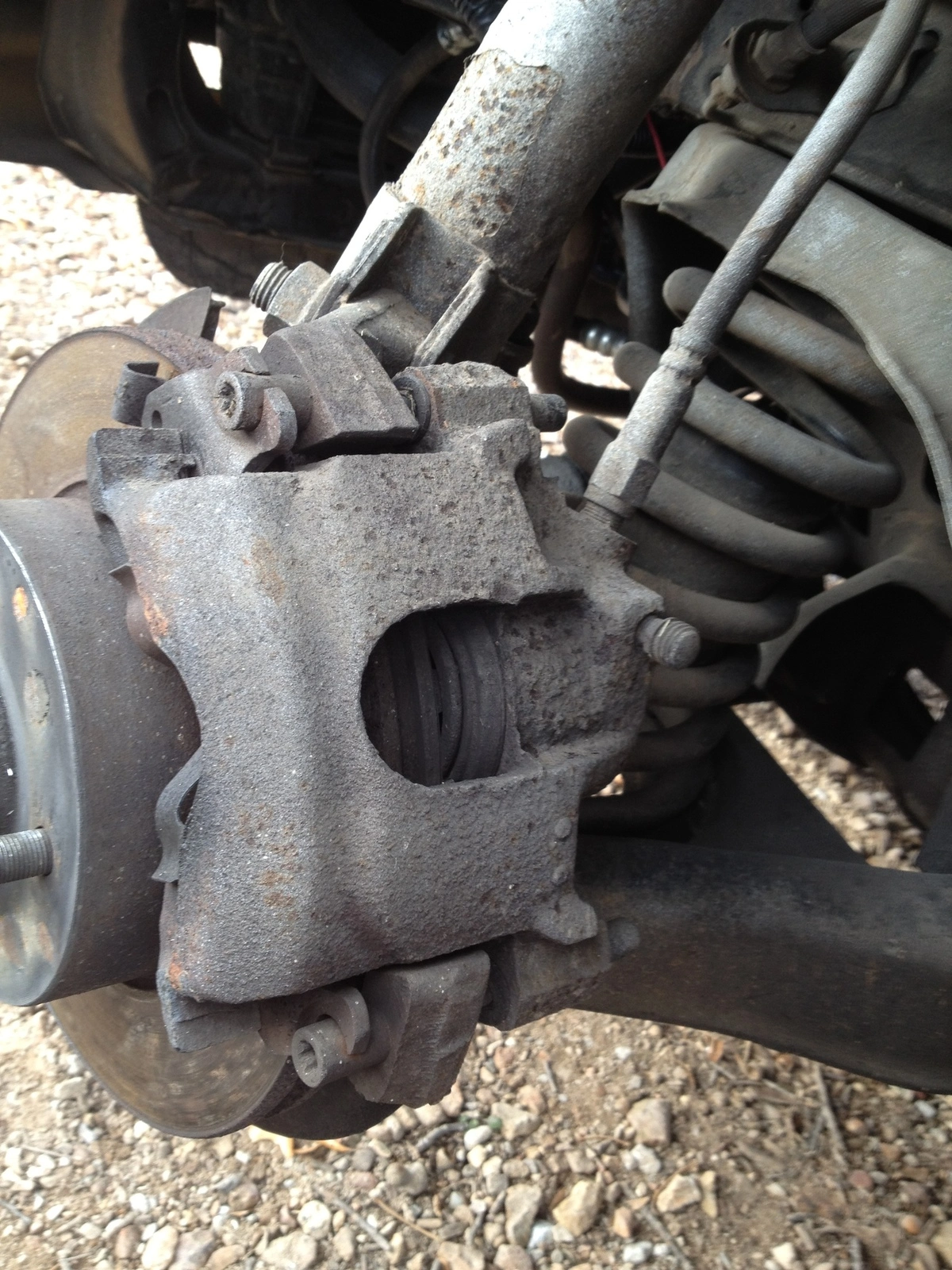

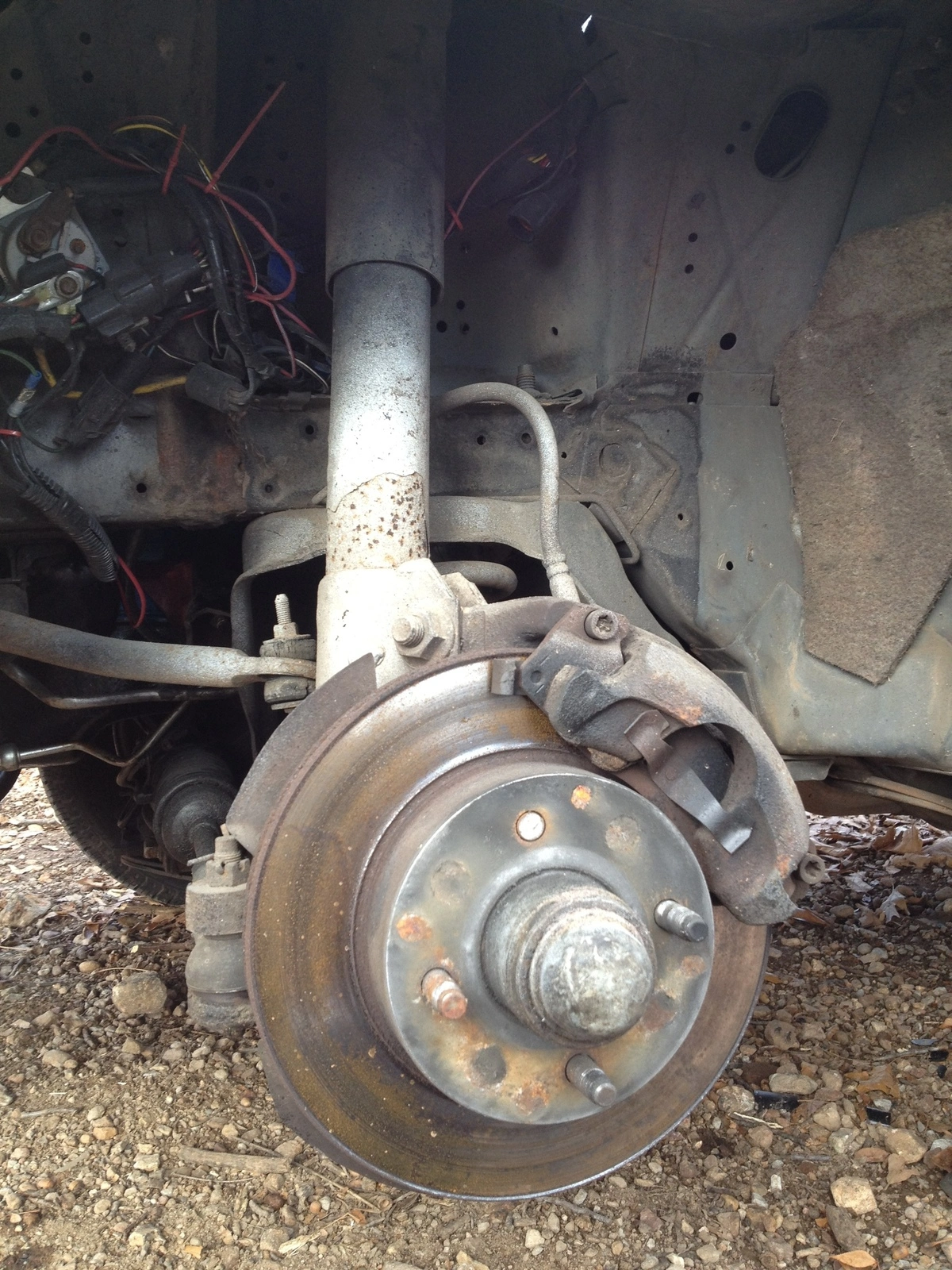

here are some pictures i took today. hope there good enough. wasnt real sure what i needed to take pics of

Looks like 4 cylinder front end with an 8.8 out back. Note the quads as well. Front can be done with 4 cyl ranger rotors on existing spindles but I would upgrade to at least V8 spindles and SVO or Lincoln front rotors and calipers.
