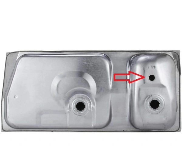

Looks like I'm going to have to replace the fuel tank, fuel pump, and the rubber grommet for whatever goes in the small hole.
Problem is that I don't know what it's called, I'm not finding anything that matches what it looks like on Rockauto. The old one was like jelly and pulled apart in several pieces.
Can someone help me out please?
Yeah the plastic part that goes in just fell out on it's own since the grommet was trash.
It looks ok on visual inspection. Is the Vapor Valve prone to failure or one of those parts that should just be replaced while I have the tank down?
Alright, thanks guys! I think I've got everything identified now.
Just test it. It's a one way check valve. vacuum should pull from the tank, but not be able to flow back into the tank. Put a rubber line on the nipple and test it

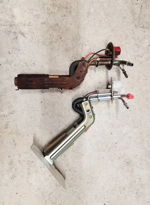

So I received the fuel pump replacement, but I don't think it's going to work. The bend isn't the same angle so it's not going to reach the gas in the bottom of the tank unless I just don't understand how it works.
Can anyone confirm? Should I send this back?
Looks bent, check out the curve in the fuel line, I would send it back.
You were correct. On further inspection it had actually bent so bad that it creased and opened up a small hole in the metal fuel line.
