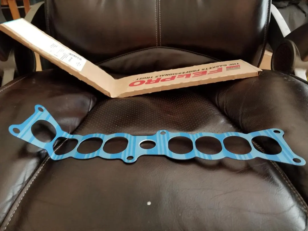

I got everything bolted back in place and turned the key, but fuel starting leaking out of injector 1.
Unbolted everything once more, reseated the injector into the rail and started bolting everything back up, but this time I decided to shear off 2 of the bolts for the fuel rail. They must have been pretty weak already because they just twisted in two like they were made out of plastic.
So now I've got to find an easy-out that's small enough to drill those out, and hope the threads aren't jacked up.
