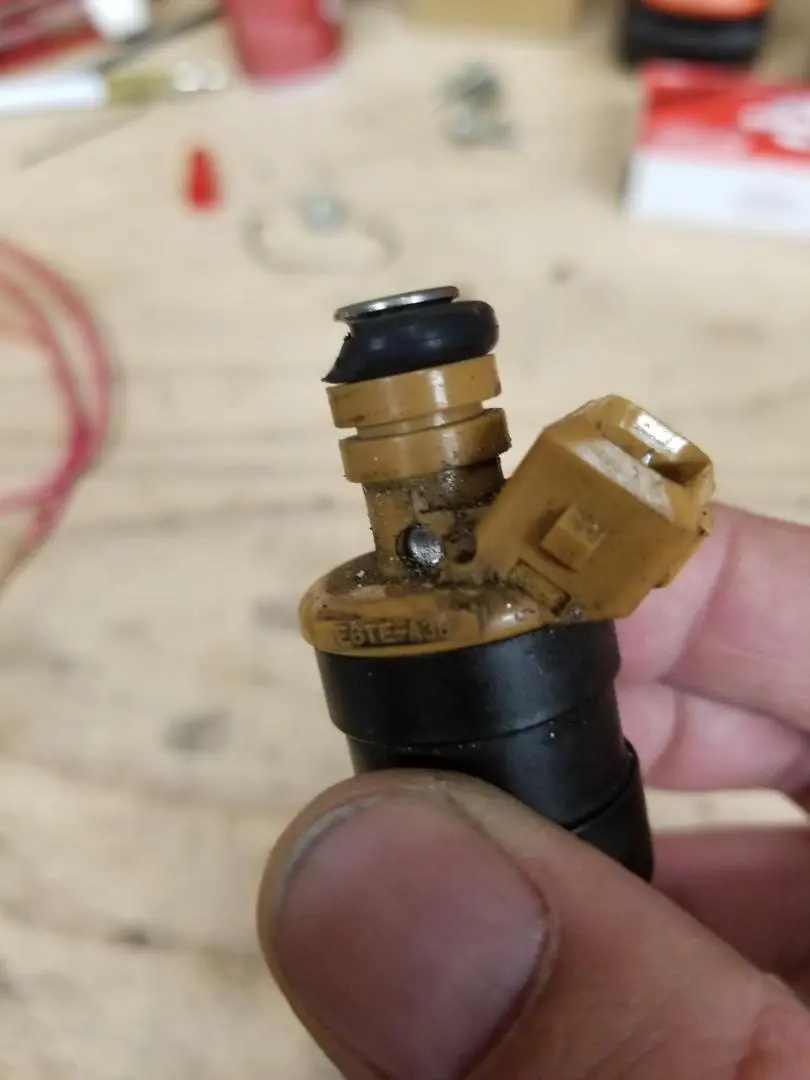

I found the culprit, injector 3:
I guess I must have sliced the edge off when I was trying to seat them the first time (incorrectly from bottom to top) because it wasn't like that when I took it out to clean it.
I'll pick up some o-rings tomorrow and give it another go.
Thanks guys!
