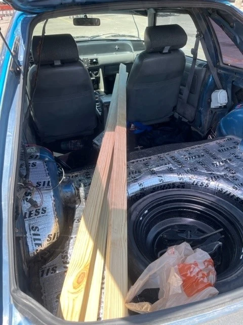

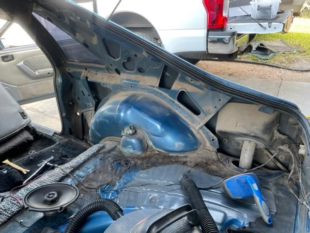

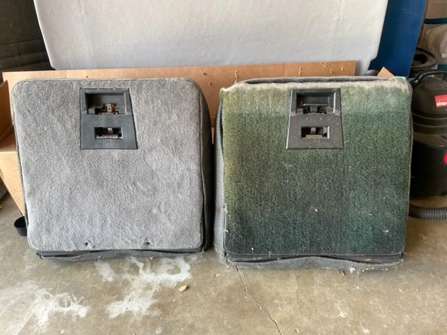

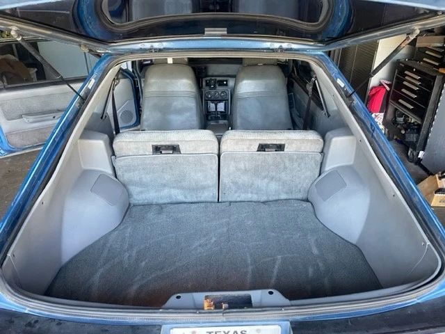

The hatch area looked like someone stored used engines and transmissions back there. Carpet looked like C$%p and the panels were all stained and scuffed up. I pulled out the rear seats, panels and carpet in the hatch area. I then installed KilMat and went back with new hatch carpet. I cleaned and died the panels and it is 1000% better. I lost my before photo of the hatch area but I do have a before and after of the carpet on the rear of the back seat to give an idea.
