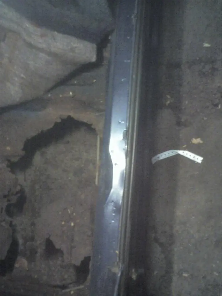

I've got myself a nice 89 LX 'vert that appears to have spent some time in the rain with the top down. The passenger side floor pan is in the process of being replaced, but I've hit a snag: since it's a convertible, it has extra structural reinforcements along the rocker area inside the door, and they cover up part of the floor pan. Is it safe to cut these out as long as the car is supported (not lifted, just held in place) by jacks, or is there another way around?
I've attached a picture to give you a better idea what I'm talking about.

I have not done this, but I have installed a couple sets of subframes, so I would say that as long a you block the car up nice and square while you remove them, it should not be a problem.
I would put them back and also install subframe connectors to finish up.
