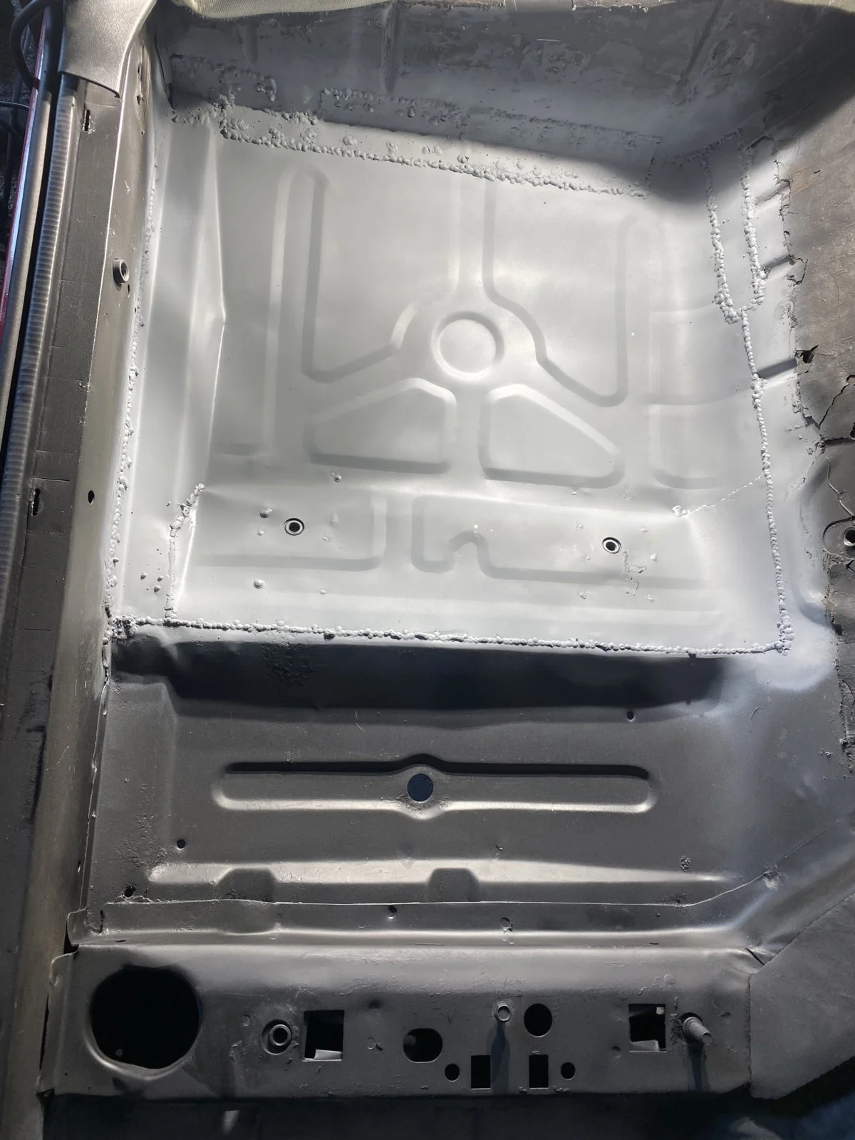

Here’s my install.

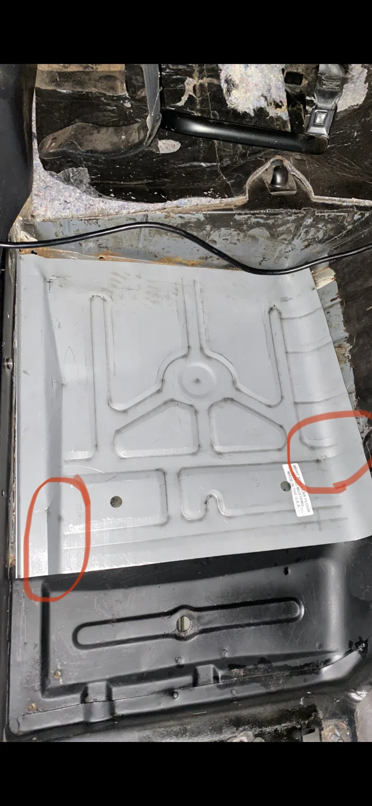

Here is a pic of the piece before I welded. There are splits where I circled. You have to do a little fitting and bending, and then weld those seams up. But if you’re not looking for OEM, I’d say it was worth it.

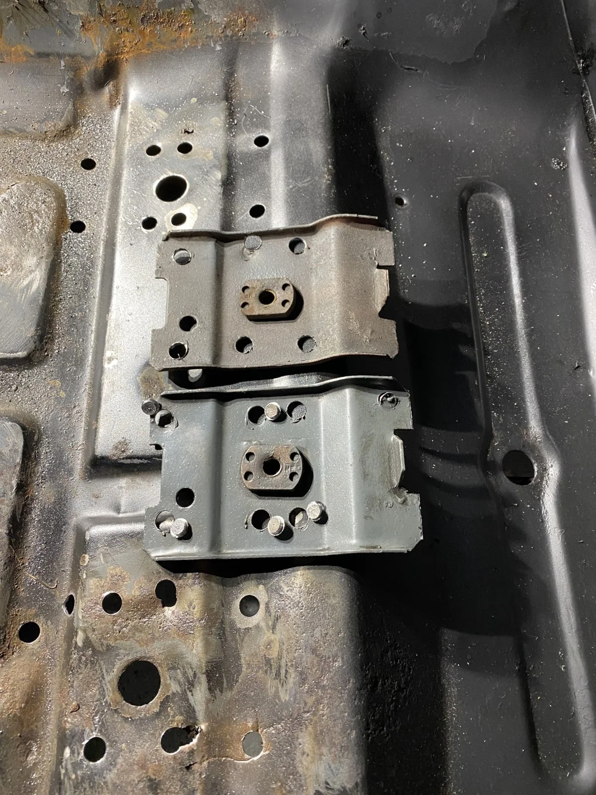

I also saved some money by drilling out the spot welds and re-used my seat mounts..... if yours are still in decent shape.
