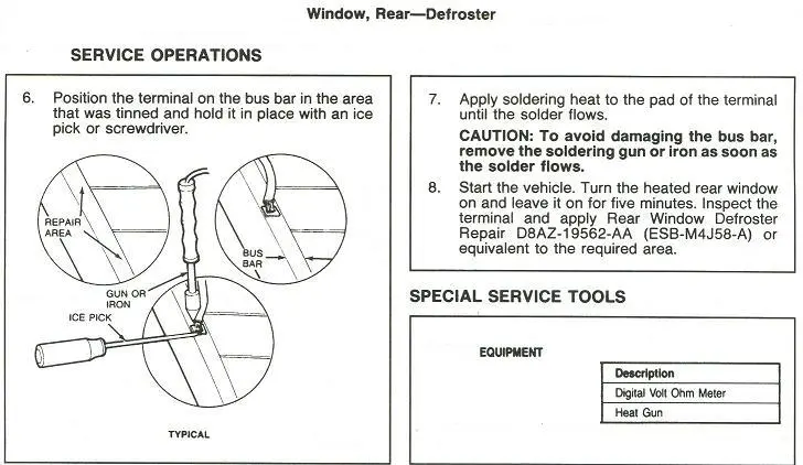

The "negative/ground" (right) side of my hatch defroster cable has came loose from the glass. Is there a safe way to reattach this? Meaning, should it be soldered back to the metal base, or will I run the risk of shattering the glass due to the soldering iron heat?
