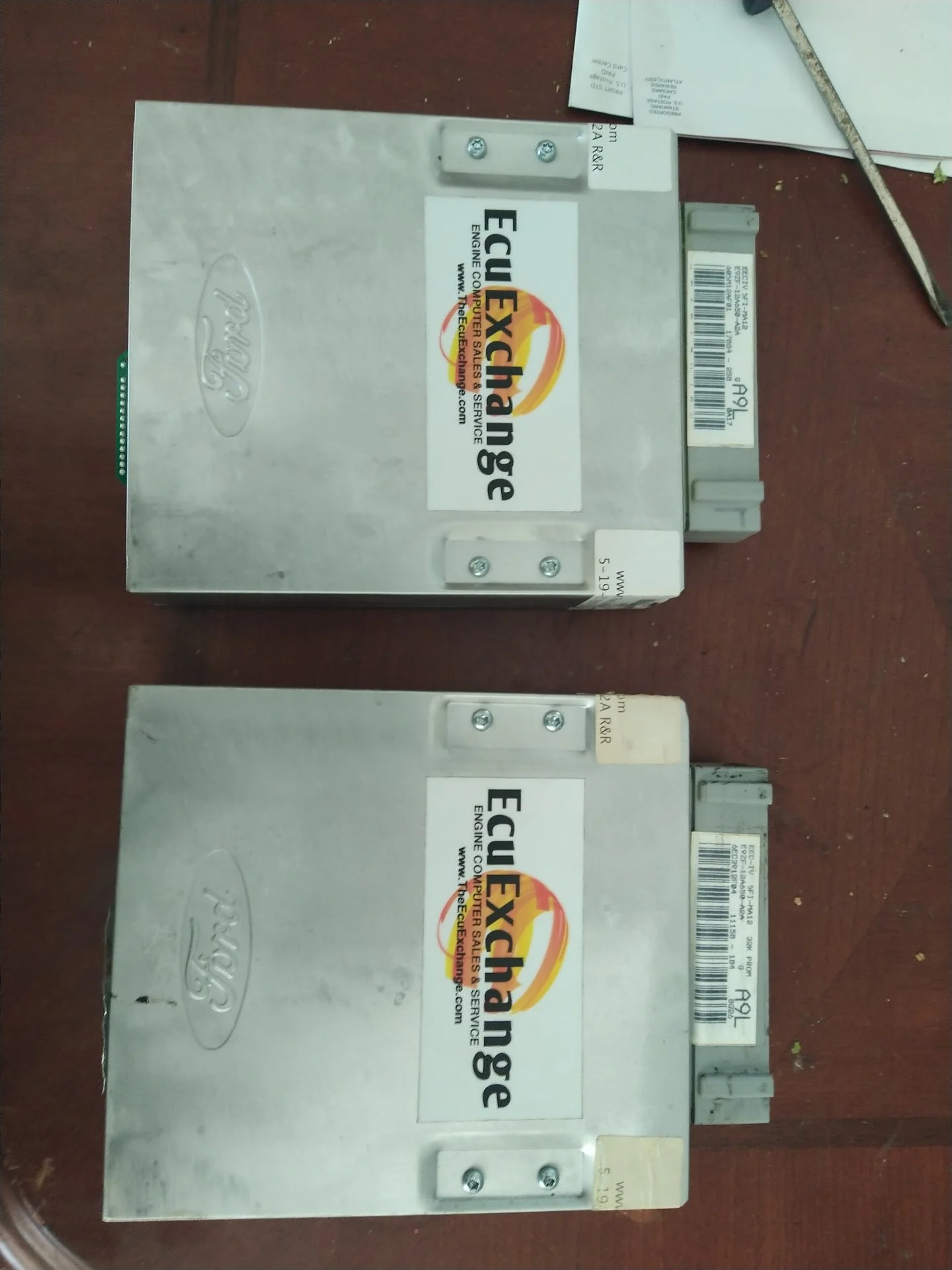

Ordered CTS
TMI
as well as a new temp sender (fixin the guage)
I’ll repost if that takes care of things..

I also agree on swapping out ECU's...Thats why I always have a good working spare...Sometimes those internal voltage capacitors can be finicky.......
