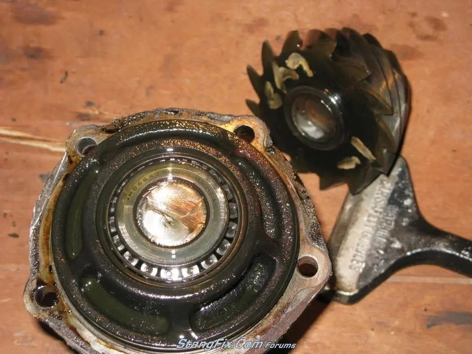

the original 8" rear end just gave out this morning. i guess it couldn't handle the 289 stroked 347.

do any think i can still use the 8" rear? i'll have to check the innards to see the damage. the car doesn't move when put in gear.

here it is...
if i keep this 8" rear, the best option i believe is the TJ guy from eBay who has 8" center sections for $855 minimum... buying the pinion gears and the installation kit with labor would be about even.
now, if i go 9" big bearing, the only thing i see me having trouble is converting to rear disc brakes. i have the original GT setup - front discs and rear drums.
