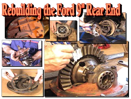

Do it yourself! I bought that video and after watching it, and buying one tool so I could measure case spread, I re-did my own and it is amazingly quiet. I used Richmond gears and rebuild kit and installed strange 31 spline axles and a truetrac diff at the same time. I enjoyed the video and it saved me a ton of money. Rears were the last uncharted territory for me, and I can say without question that if you've assembled an engine, you can CERTAINLY redo a Ford removable chunk.
http://www.youtube.com/watch?v=bSCUck4M6W4
