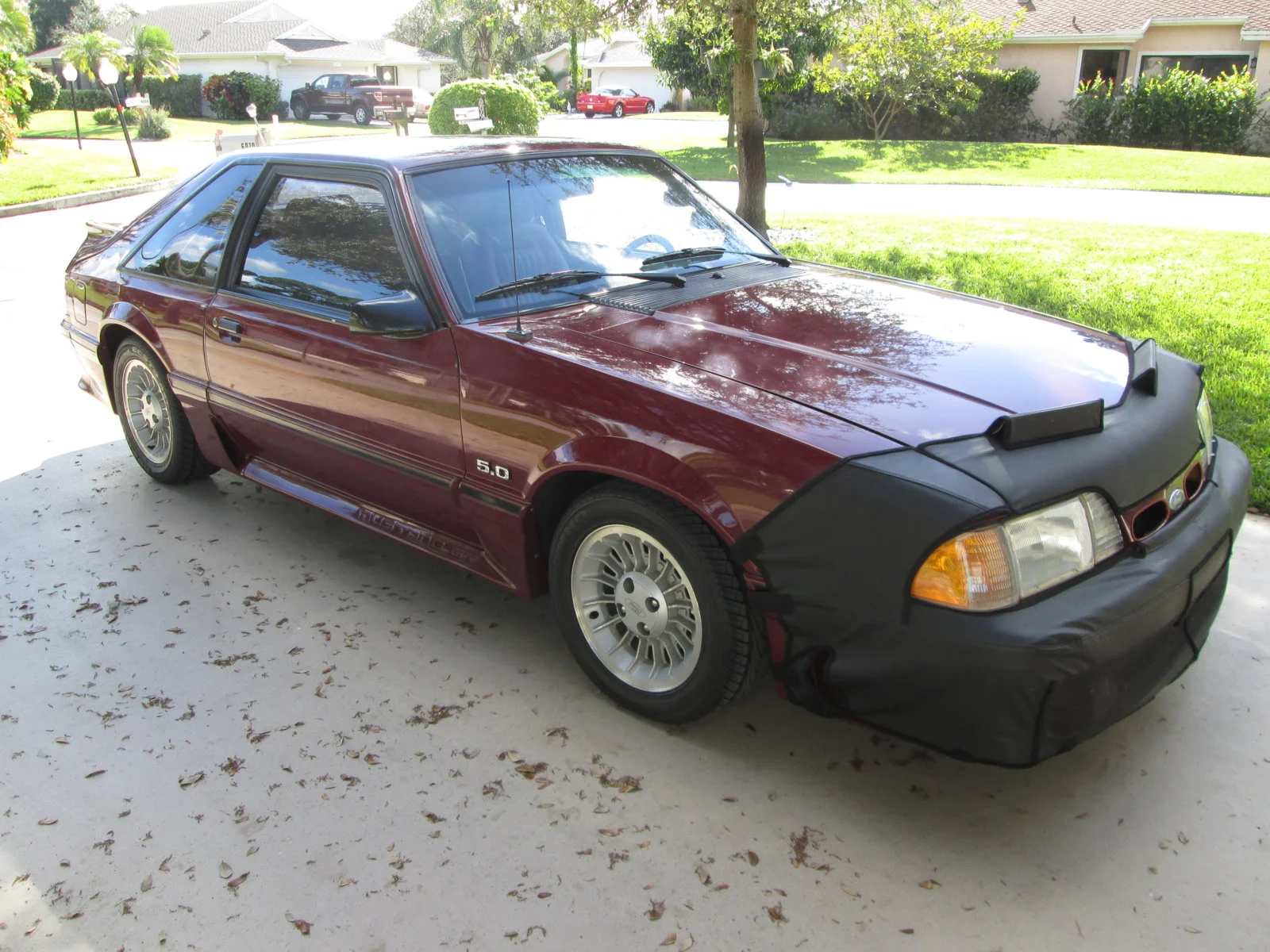

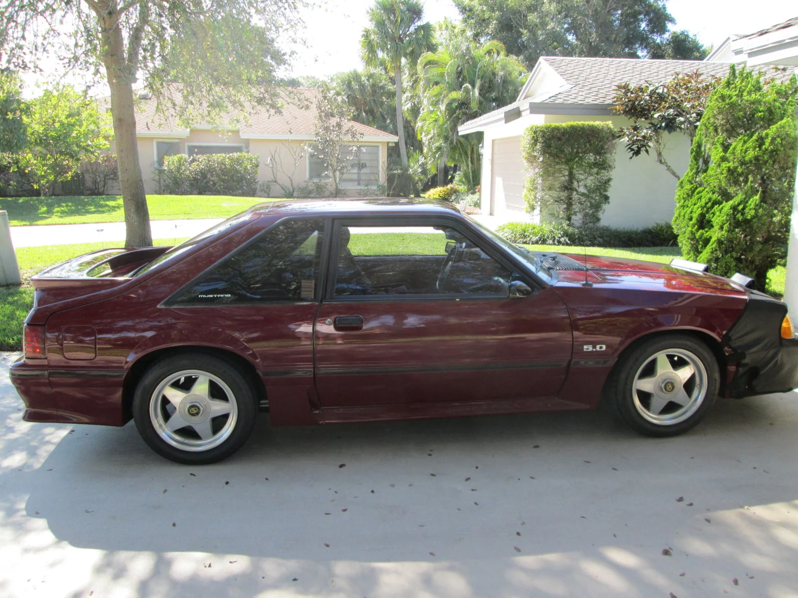

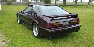

Hows it going everyone. New to the fox family since July last year. Been a fan for a long time though. I'm 28 years old and have a 1990 Mustang GT fox body 25 year badge. 122,000 original miles. All original parts. Still really clean. My only major issue now is I believe the rear main seal is going as I have oil on the ground after I'm done driving. Itll smoke a little while I'm driving, but not much. Other than that I keep adding a little oil here and there until I can get it fixed professionally. Although I've read some reviews on blue devil rear main seal fix? Any input on that would be great. I have some rust on all of the wheel wells, we touched them up a bit. I do some research on info on these cars all the time but there is nothing like human interaction to really learn. Just looking for outside info on these cars. I recently had a hood latch issue so I got a hood in my cart to get it replaced. I'm just pissed because this thing is all original. And I wanted to keep it that way. But gotta do what you gotta do right ? Check out my mustang and tell me what you think. Just wanting to talk to my fellow fox lovers.

Looks clean! Has it been repainted? Im with 90sickfox. Only right way to do the rear main is to pull the trans and clutch out of the way. The labor isn't to bad, but you might need 2 people.
Hey yall yeah I havent touched the blue devil stuff yet. I have been adding oil here and there when need be. It's nothing major. But the car had sat for nearly 10 years. When we got it the paint was horrible. My dad and I spent probably 8-10 hours buffing and waxing the crap out of it to get her to shine. But it had some rust on the quarters and what not so we did a little touch up job on it to kind of blend a little bit. Cant afford a paint job so it's no big deal for now ya know. Long story short I didnt latch the hood all the way and went for a drive at night. Was doing 35 mph and BAM damn thing flies up and smashes. I was heart broken. Couldn't believe i did it. Just trying to get to gas station before it snowed and wanted to drive her one last time. Ran inside to grab my things came back out and took off. 1/2 mile down the road it happened. So I got a quote to have it fixed. But I was looking at hoods today and found a decent one. It is automatic transmission. Which is okay. Not a fan really. The rear top of the seats are faded from it being sat out for so long. But back on topic with the rear main seal. When I first got it it didnt leak at all and then slowly started getting worse. Then I read up about how they are notorious for it ? Idk it's all hear say. I feel like I have a diamond in the rough though. Its never been tore apart. All original. 1 owner. The strut towers are going to need to be replaced in the near future.

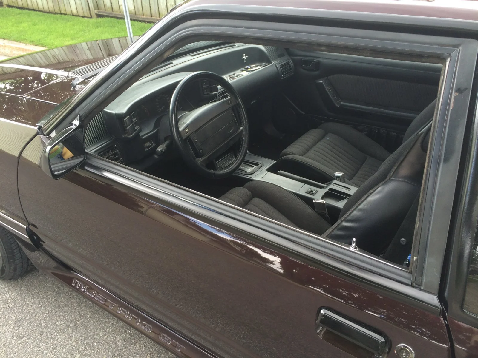

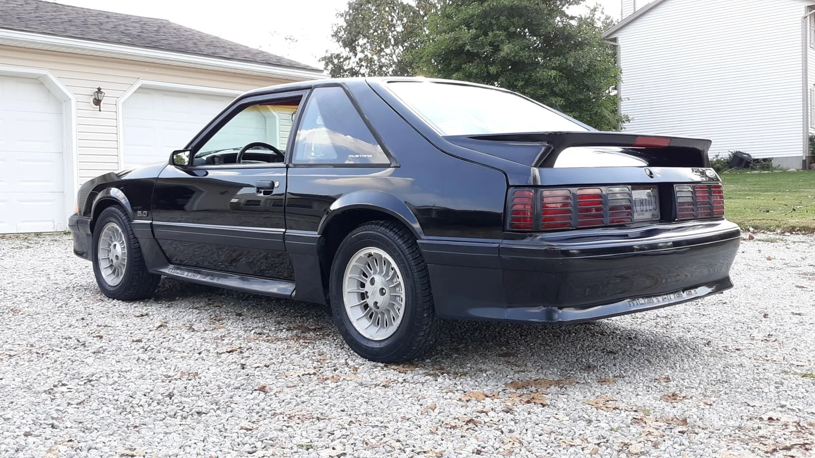

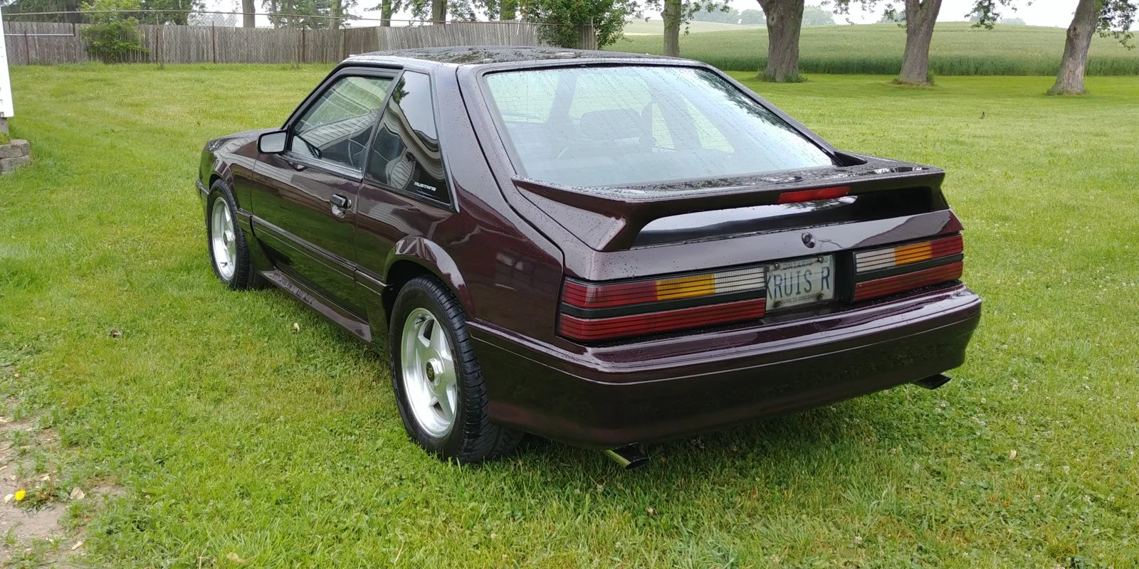

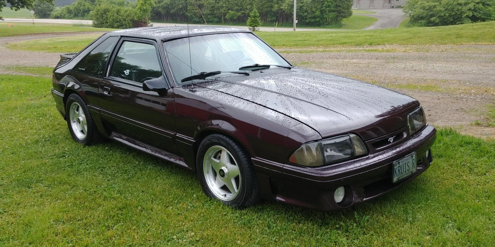

Nice looking ride. I have a 90 GT as well and aside from the interior it looks like our cars were twins (black, auto, sunroof, late 90 build). Mine came with the black interior.

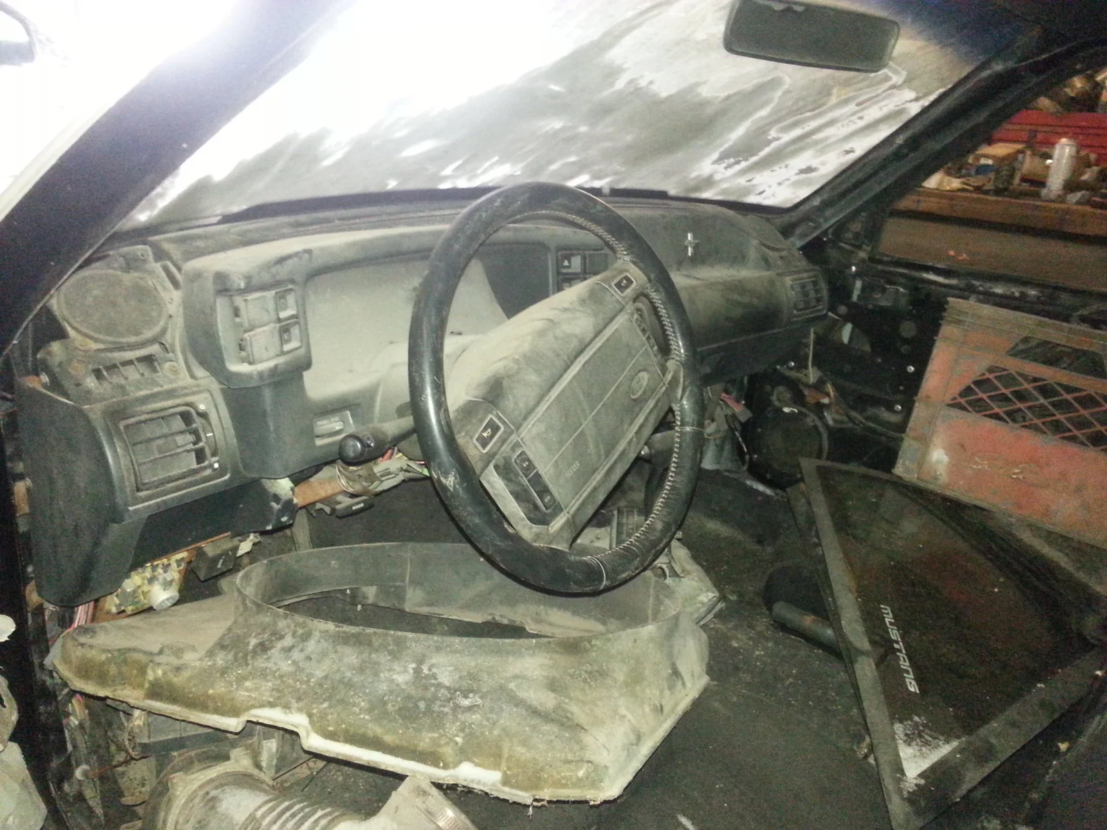

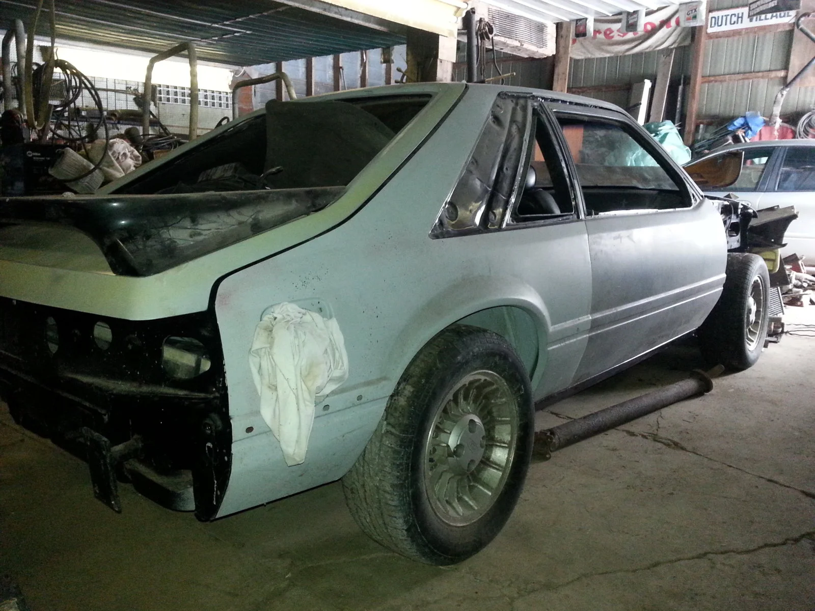

Here's what I started with...
2.5 years of weekend work later...
For a full walk around with it running ...
View: https://www.youtube.com/watch?v=2douA8PXBZw
I did all paint, body and all mechanicals myself. Take your time. If you need to pull a tranny or engine to do the rear seal, maybe pull engine and do strut towers while its out. Just a thought.
Reactions: 90foxer

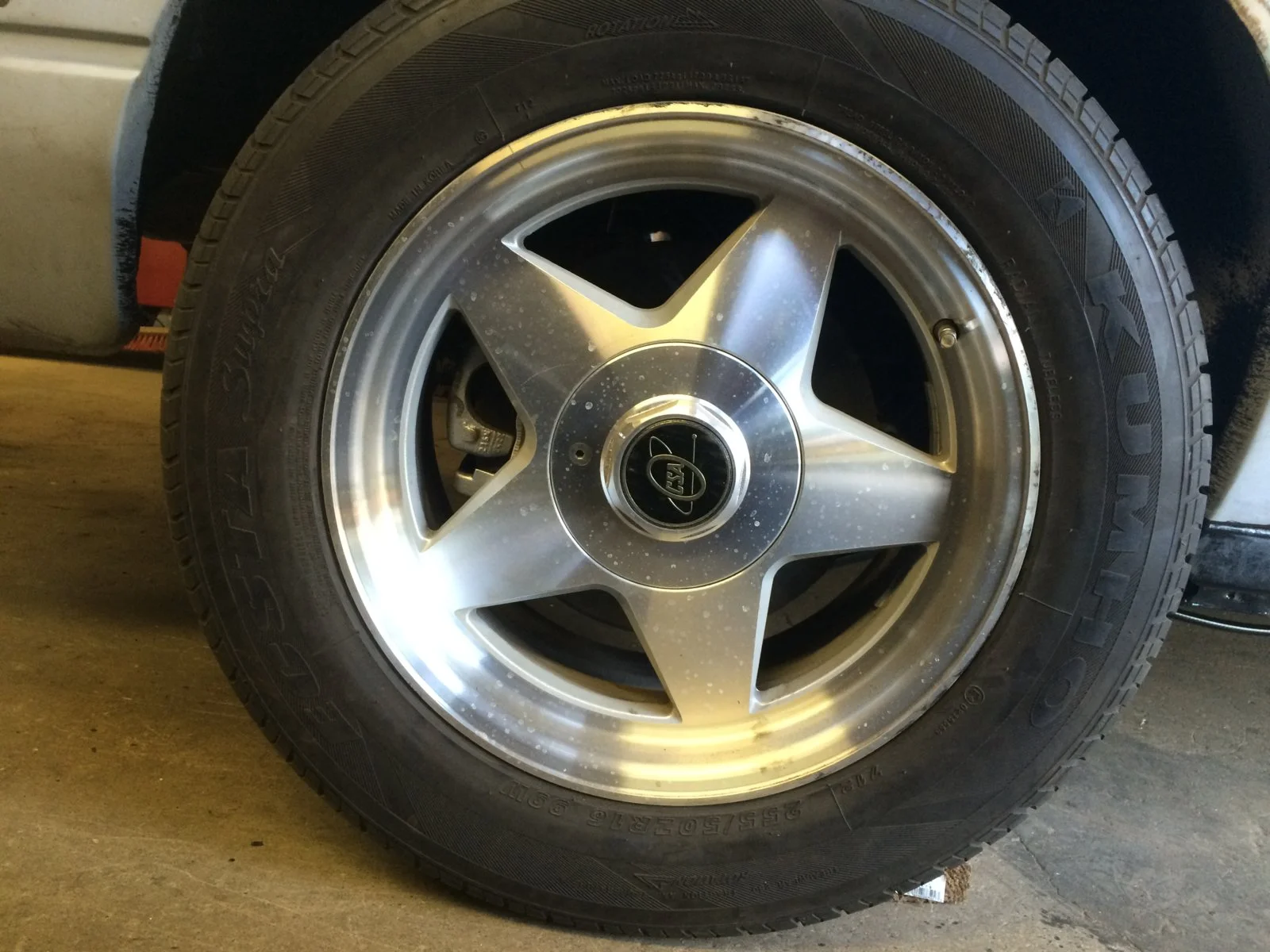

turbine wheels aren't 1990,
'90 was the last year for the turbines on GT's. '91 was the first year of the Pony wheels. That's why the front fenders are different for 91-93.
Almost identical wheels. I see you have the caps that are held on with the central cap, mine have the short tapered allen head screw to the side. I came across someone else with those same caps, they couldn't get the caps to fit on right (and stay on) and wished he had the kind like mine. But the rim itself is different to accommodate the screw

I didn't realize turbines were '87-'90, 4 model years.
My center caps are attached the same as yours.
I replaced the allen head zinc plated screws with stainless steel ones. The bolt head has a slightly larger OD; 0.610 vs 0.560. Used a countersink that matched the new ones to enlarge the center cap countersink by .050. I had to buy a box of 25 & only used 4. Send me a SASE small padded envelope & I'll give you 5. PM me if you want them.
BTW, I had a problem with one of the wheels. Tire leaked about 2psi/month for 20 years. Finally found a tire store with a large tank where we detected a small bubble every few seconds. The aluminum was porous in one small section. They put JBWeld patch on inside & outside of wheel. Doesn't leak any more. Only leaked from the years of Fix-A-Flat which they didn't completly remove from the bead sealing surface. They had to remove new tire & wire air brush it off.
