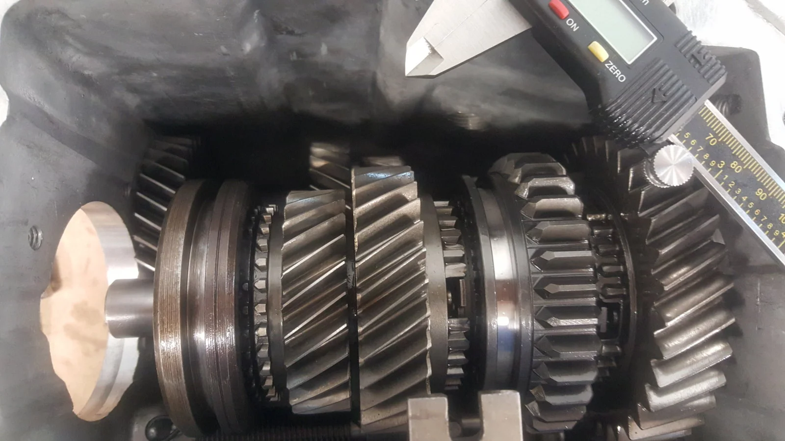

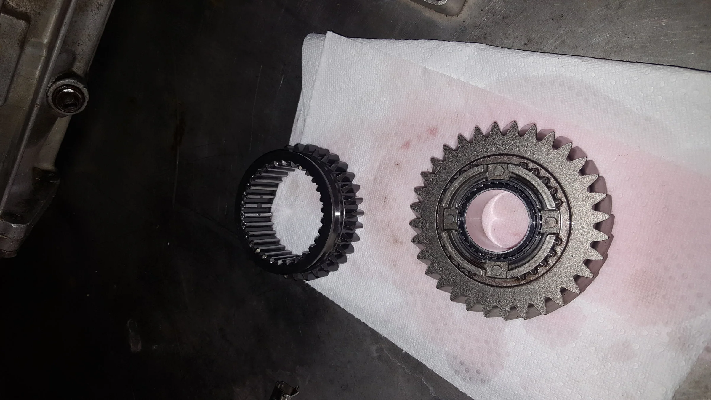

Ok, so I bought a new 1-2 syncro slider that should work with all of the different counter gears per the part number description. I also got a first gear, it is a 32 tooth. I have no idea of that will work as it came out of a 048 counter gear for a tbird turbo coupe with a 2.3l.
The gear box looks like a awesome shop, I will likley get my 1-2 shift fork from them but at 160 per gear it does not make financial sense to rebuild this trans.
Is tooth count all I have to concern myself with them? I have been searching the web and all i can find is ratio numbers attached to different years of trans. Nothing that gives me tooth counts or counter gear specs.
Sorry guys, I don't even know what I don't know!

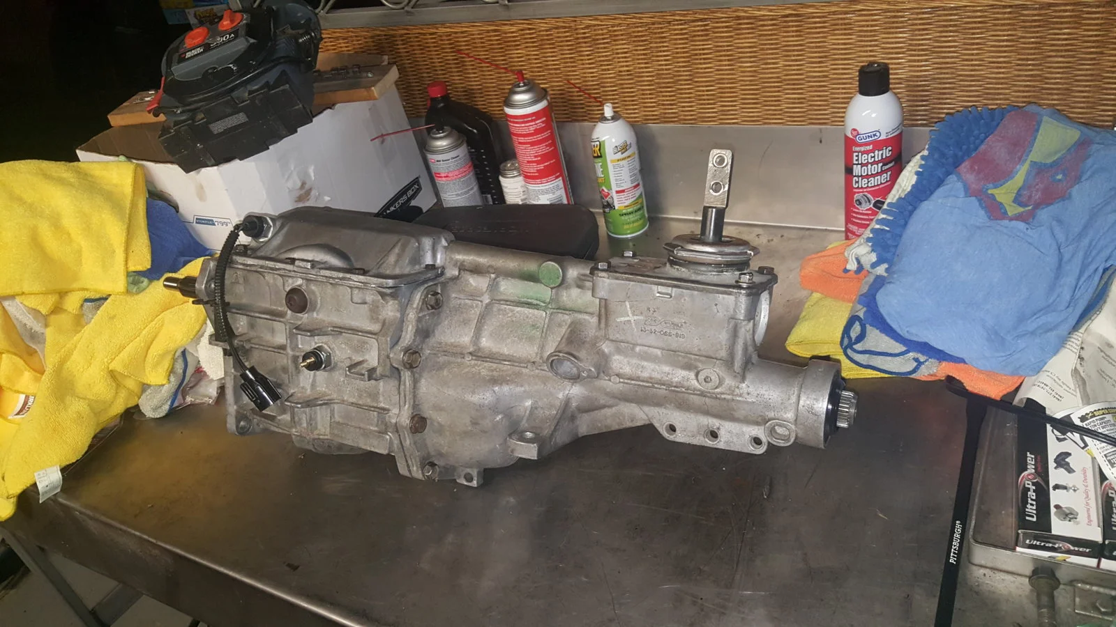

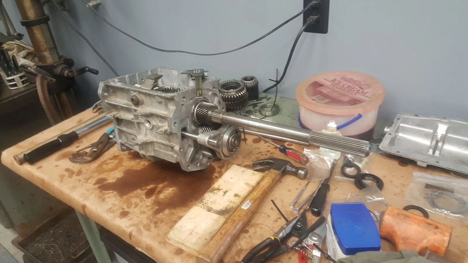

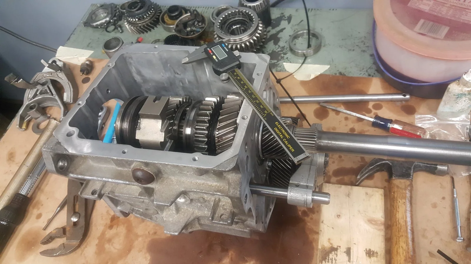

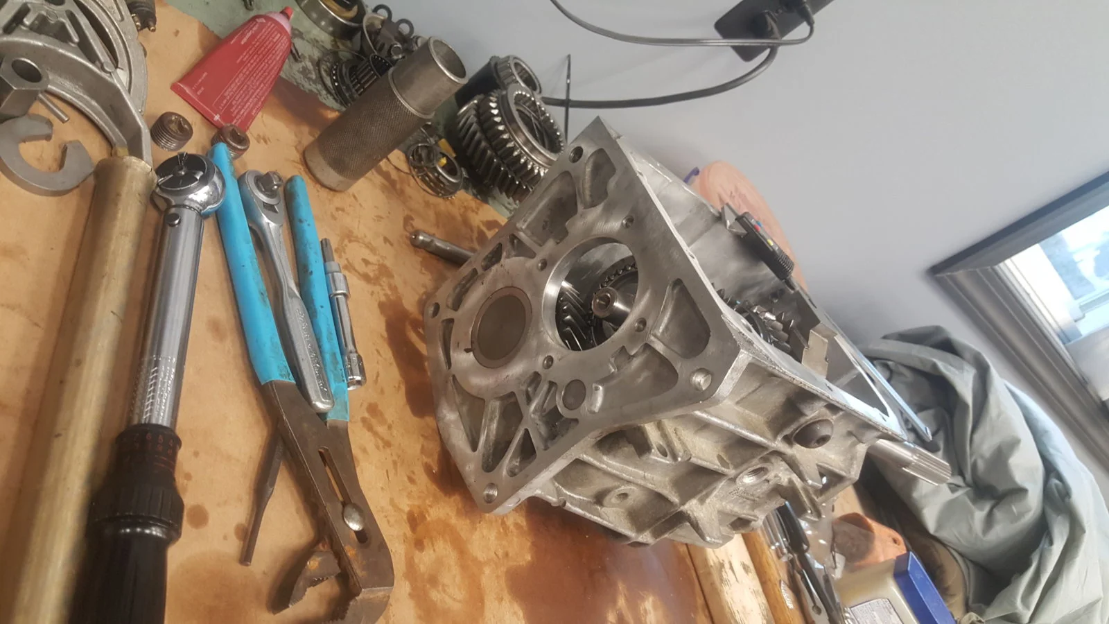

Money for rebuild kit comes in at end of month, have gears and forks for replacement....getting close to a test drive. Should have the trans rebuilt and in over a weekend. Excited....all sensors and new bolts sitting on workbench...twittling my thumbs......aarrgggg. did this jack o lantern with the kids the other night...wife just shakes her head lol.
Got it rebuilt and in. Bolting up exhaust and pouring in fresh sauce tonight. Took longer as reverse idler was trashed when i got into it. Metal shavings everywhere. I will be driving to Foxtoberfest!
