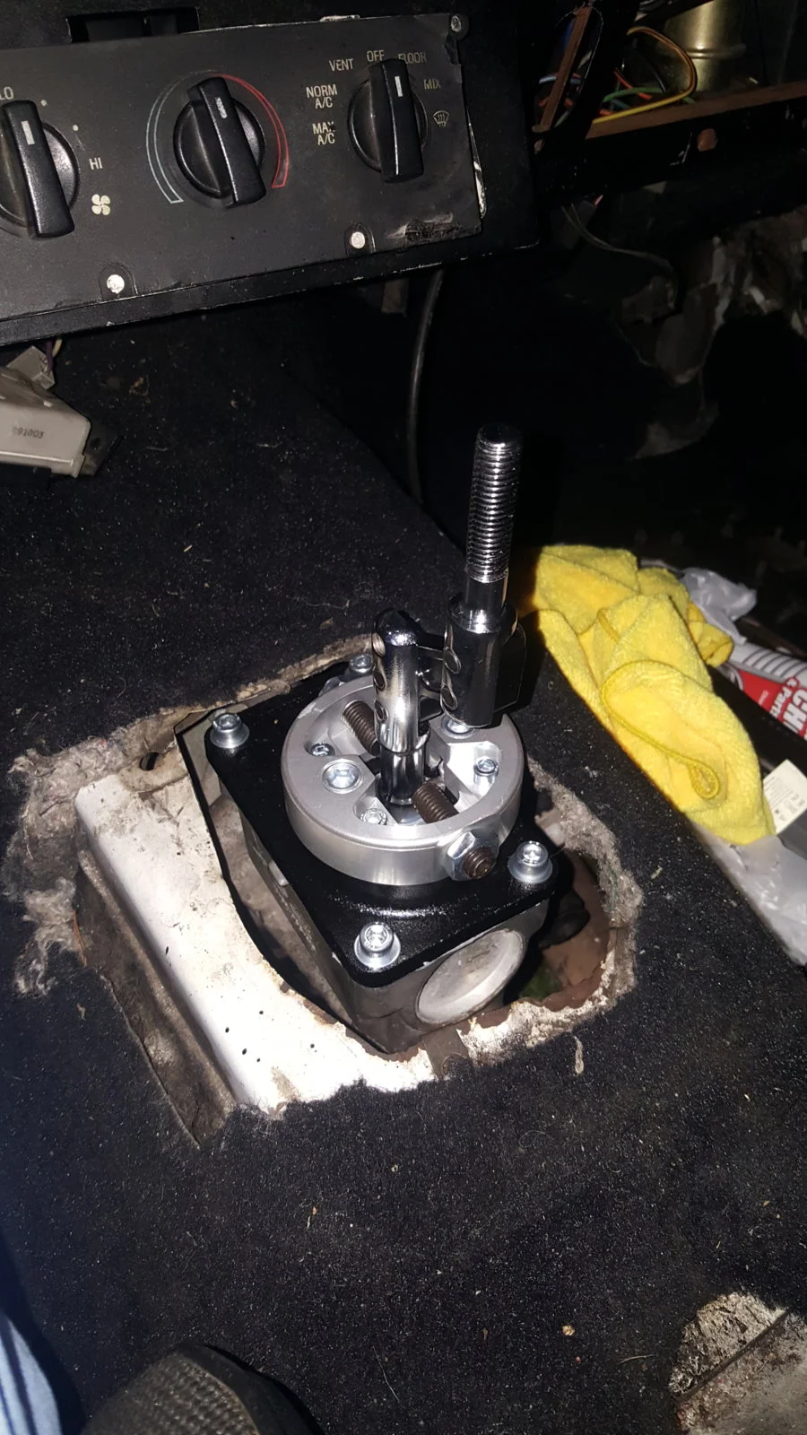

New shifter, direct from ebay China. I suggest nobody spend the money on these things, they are crappy. Mine was totally worn and floppy. Grit had gotten in it and acted like sandpaper on the plastics. It is cheap but the metal is unbelievable crap. Oh well, I bought it and the return shipping and restocking is more than the purchase price. We will see how long it lasts.

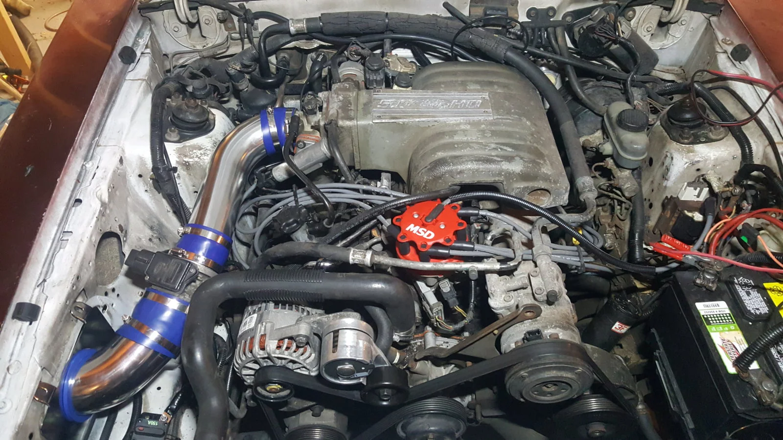

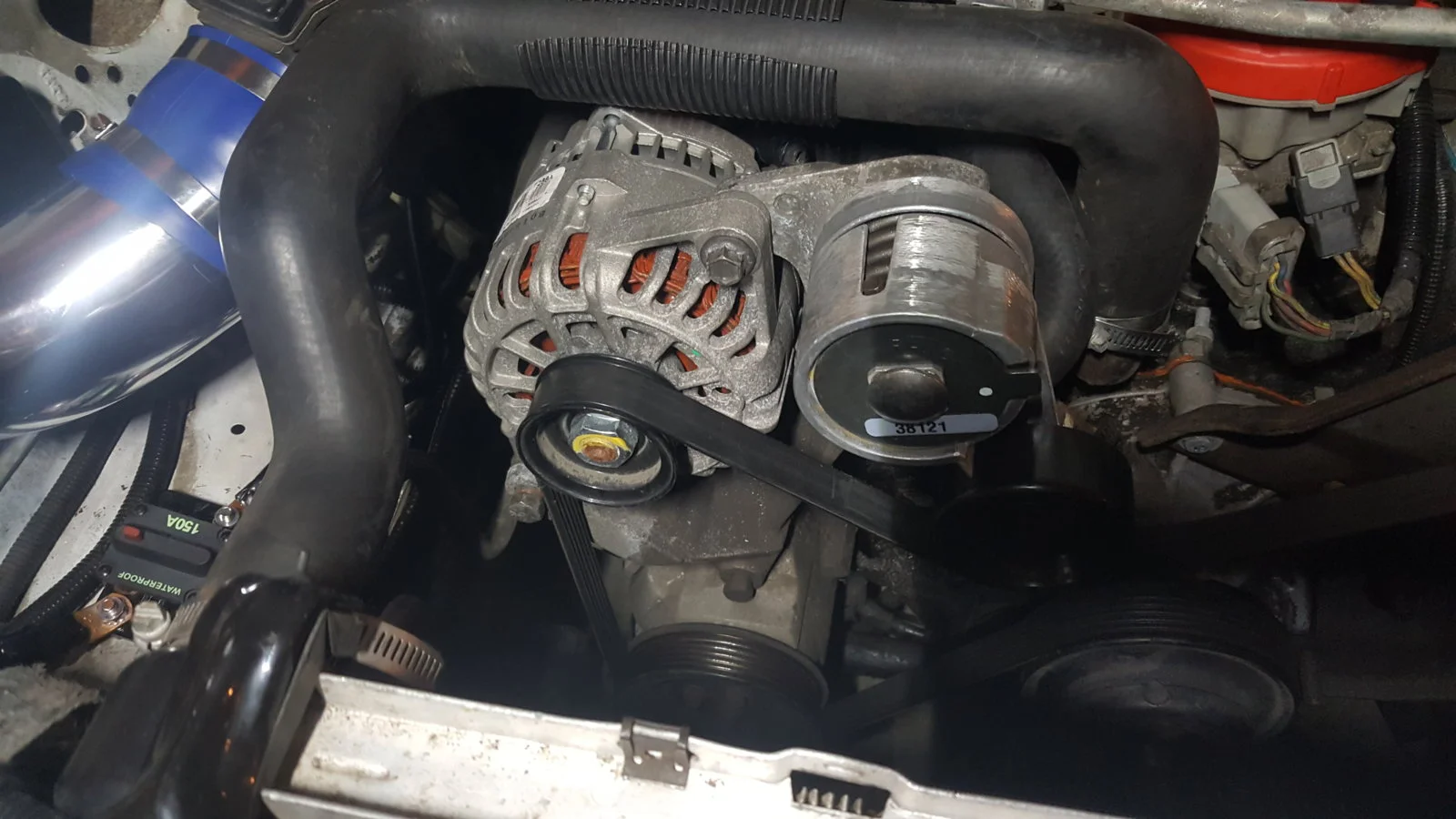

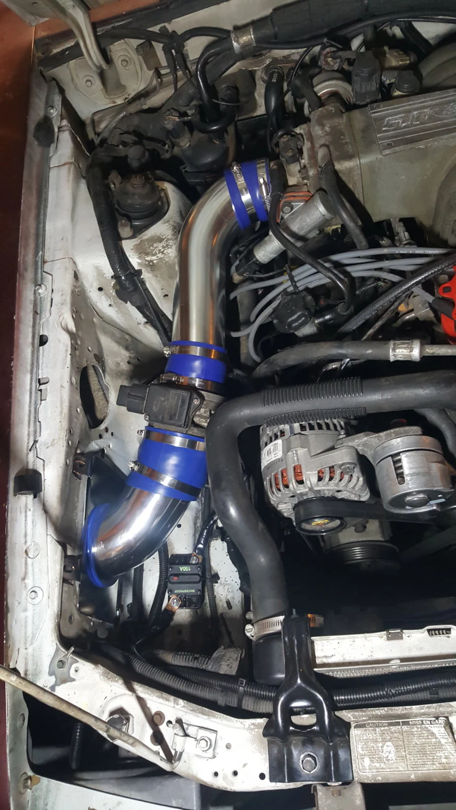

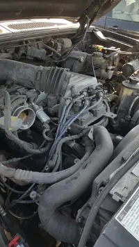

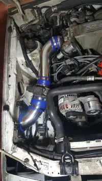

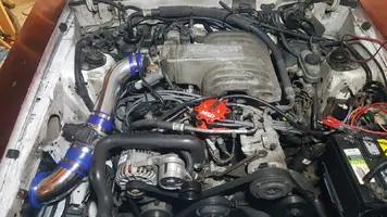

I just had a "well that should not have taken that long" moment. I wired in my 6g alternator from a 2002 sn95 I found in the junkyard.it looked brand new with a reman sticker on it, the car had only been there a week and the hood was down. It checked all out at the parts store. It fit really well, I'm glad I went this way instead of the 3g. $20 score. Also, I installed a ebay air cleaner so I could DRIVE THIS THING FOR THE FIRST TIME! I told myself that I would assess this car after I got it running. I totally bought "too cheaply" but it has been fun, a great stress release/distraction.

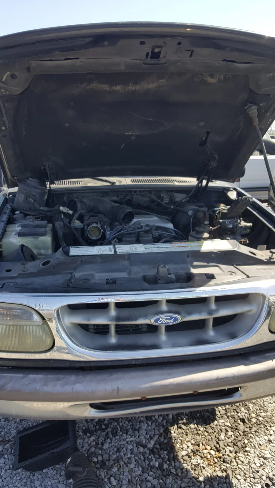

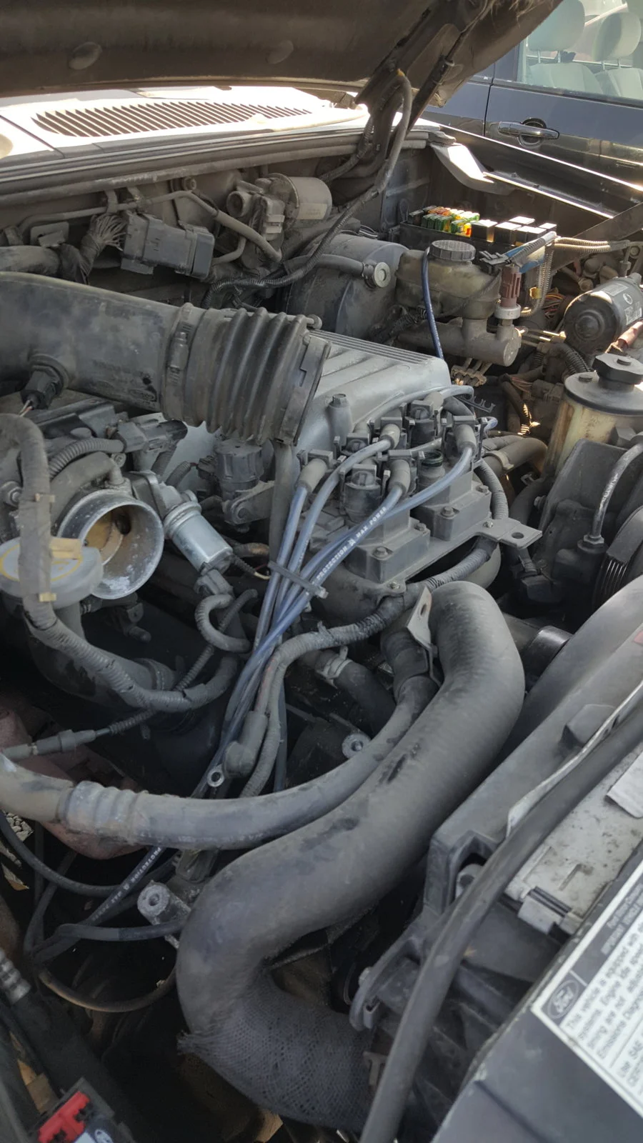

I also found a 1996 explorer at the yard.........i was really thinking about those heads. I already have a gt40 intake and explorer throttle body in the basement. I'm thinking it would be a fun winter project to clean up the heads super cheap at home old hot rod style and put them on the car. How long do you guys think it would take me to get them out?
