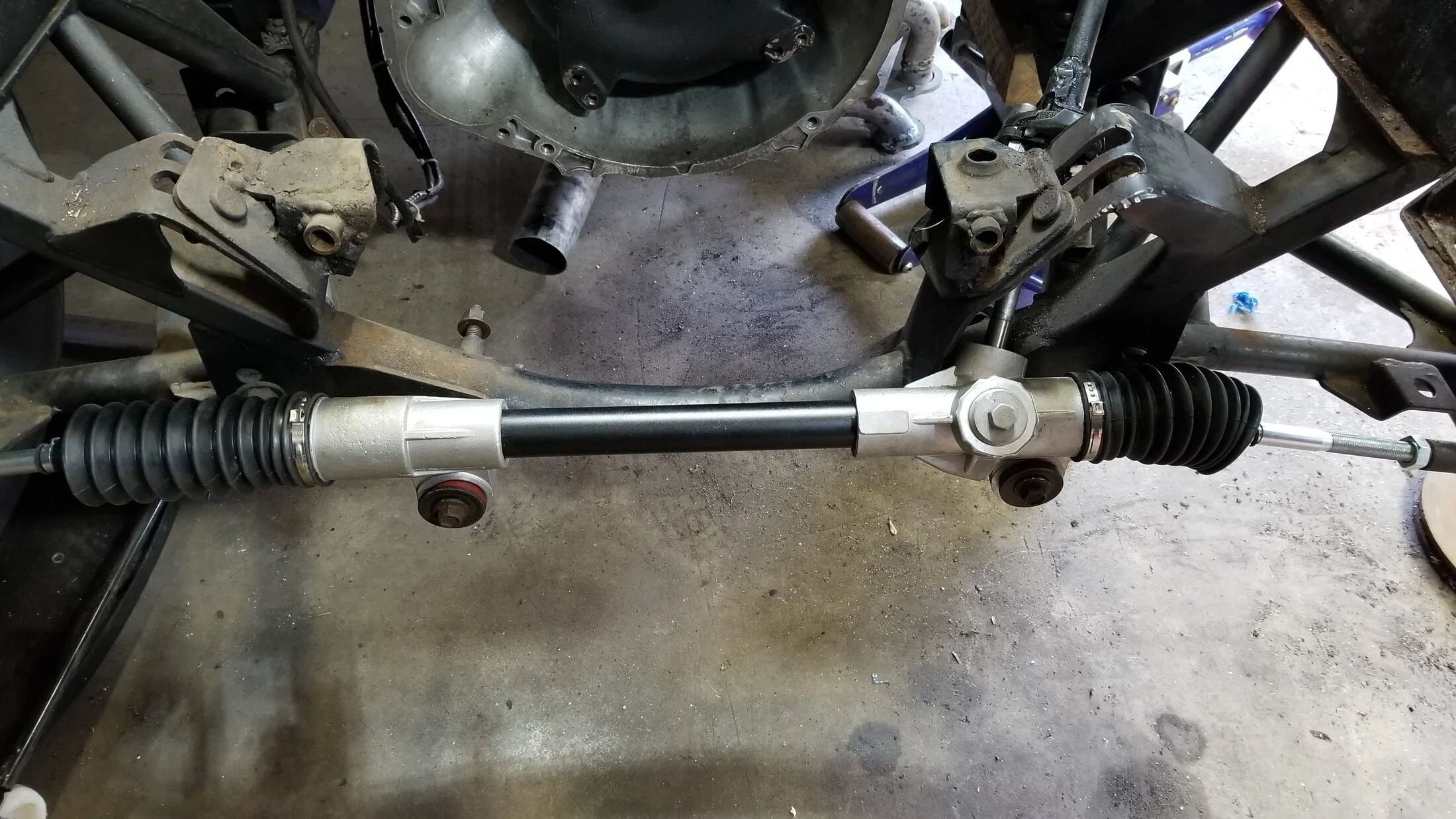

I found a company in Iowa that sold me a brand new Manual rack shipped to my door for $150.
