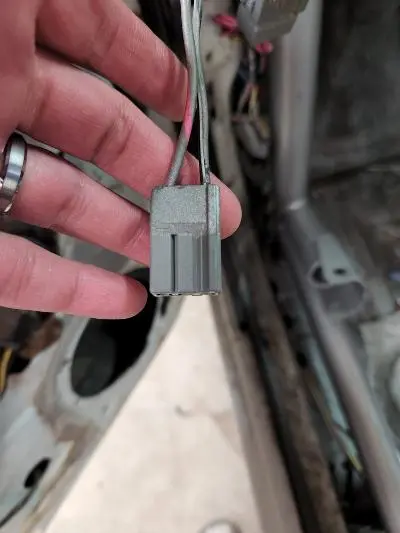

Picture of connector I'm apply 12v to the pink wire. (Located on drivers kick panel)
