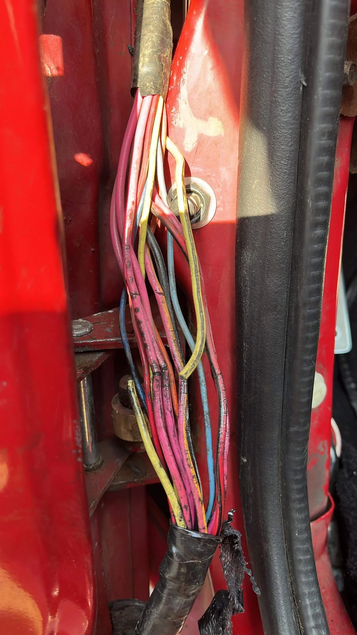

Still haven’t gotten around to putting power to it, had to do an alternator on an accord today. I put a test light on the down wire on the drivers side for the passenger window. Test light turns on. Same wire but on the passenger side, wire does not turn on. So I know that the issue is the down wire on the passenger side is not getting power. Motor should be just fine. I’m just not sure where to look lol.
Well. Did some more testing. Took a wire from the negative battery terminal and touched both the yellow/red wire and the yellow/black wire and the window rolls down.
Tested for continuity from the yellow/black wire and my tester shows continuity with every other wire there is.. what the hell? I’m not a wiring genius so this is confusing the hell out of me.
Found it. Y/B wire broken in the door hinge. Almost every wire looks like it’s about to break lol. Imma put in some butt connectors and call it a day

Fixed it. First I put butt connectors right where the wires broke in the door hinge. Big mistake as they broke as soon as I shut the door. After pulling it back out, I had another harness lying around (the different one I referred to). I took that, cut the hardwired switch off, then used butt connectors to put the plugs on. This way there is no tension on the connectors. I loomed around the area that goes through the door to prevent any further pinching.

As far as why the wires broke by the door hinge, that is where the harness is flexed the most when opening and closing the door. Bend the wire back and forth enough, add in the years of service and the wires get brittle and break.
