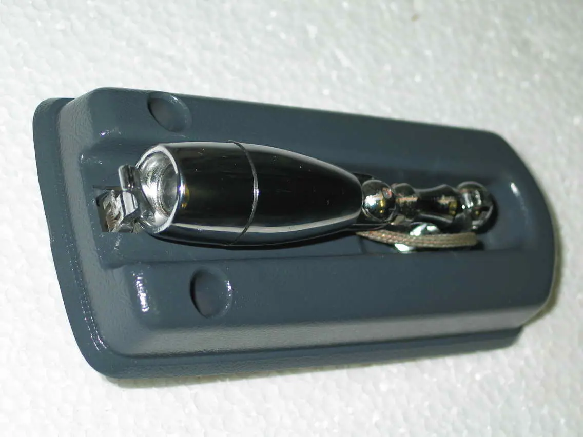

Hello I have a 91 GT with factory sunroof and would like to replace the swivel map light , are there any lights that are easily adaptable or drop in ? Not digging the snake light at all :/
Thanks
I don't know if a regular dome light will work, depends on the hole made by the map light, when I did my headliner I had a vert rear view mirror that has lights in it so I didn't cut the dome light hole, maybe check out a dealer for motorhomes, a buddy of mine got a nifty little light from their accessories dept for his custom pickup.
The headliner is cut out for it, so it's hard to remove it without finding something to cover it up. Unaware of anything specifically made for that spot other than the snake light.
Honestly, the housing is really super simple. You could surgically remove the snake-light, install one or more shrouded LEDs pointed in the direction(s) you'd like and call it a day.
Remove the light assembly
Here is the extent of what's behind it.
Modify the housing to your liking and re-install.
