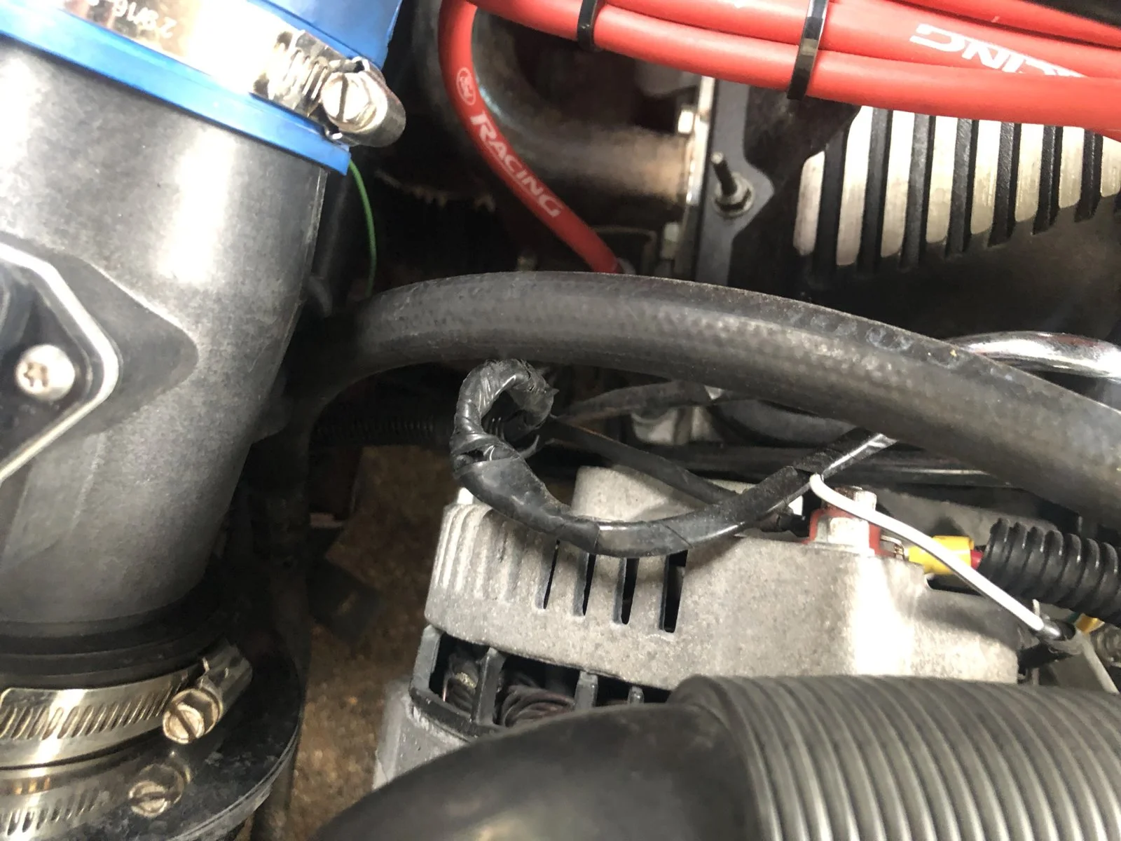

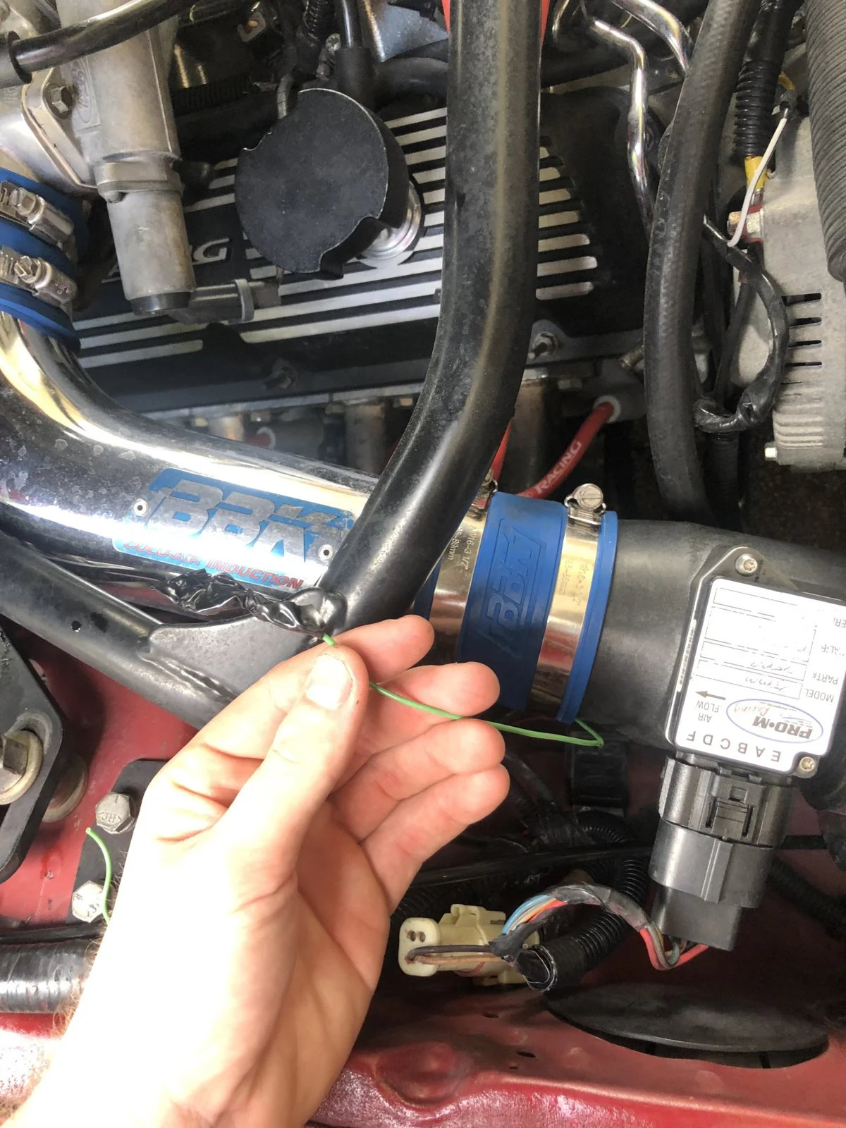

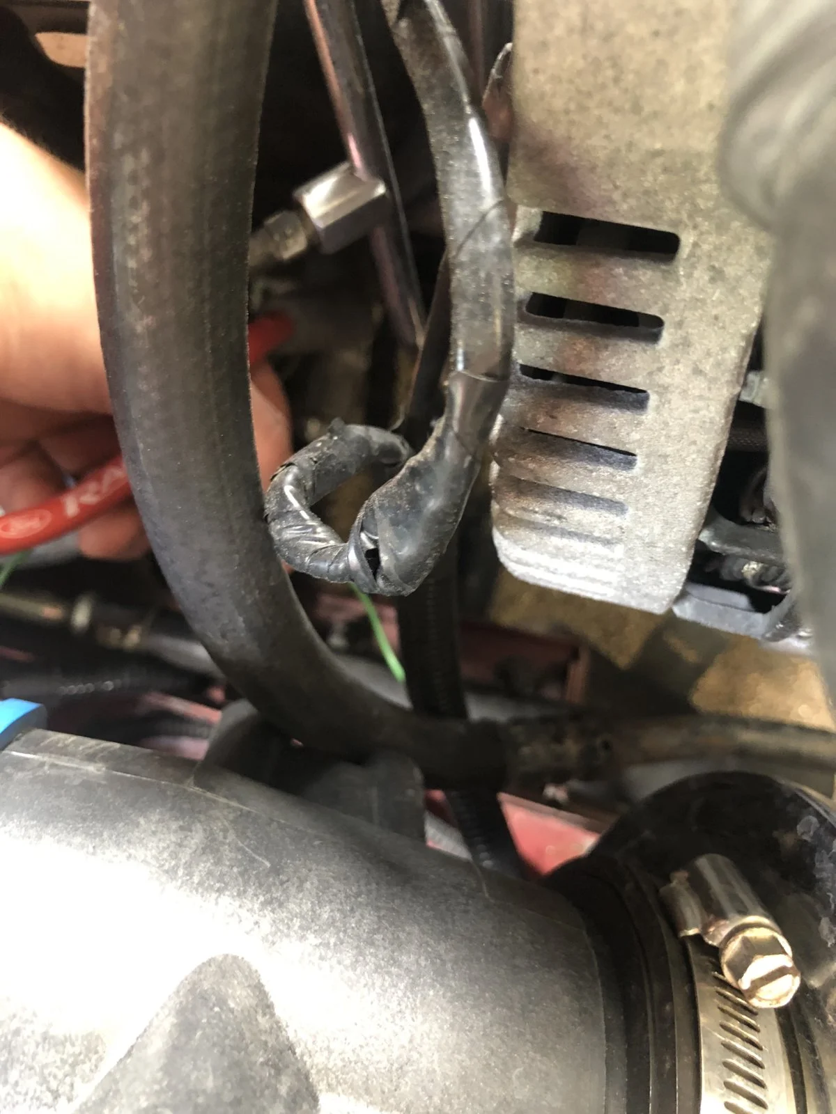

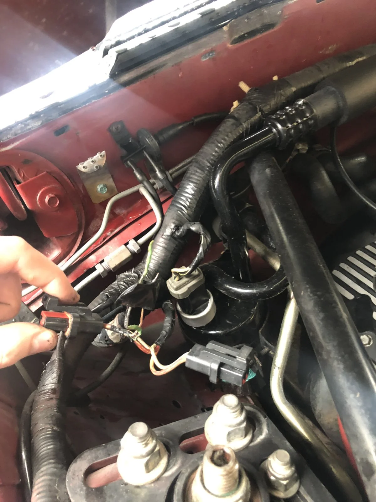

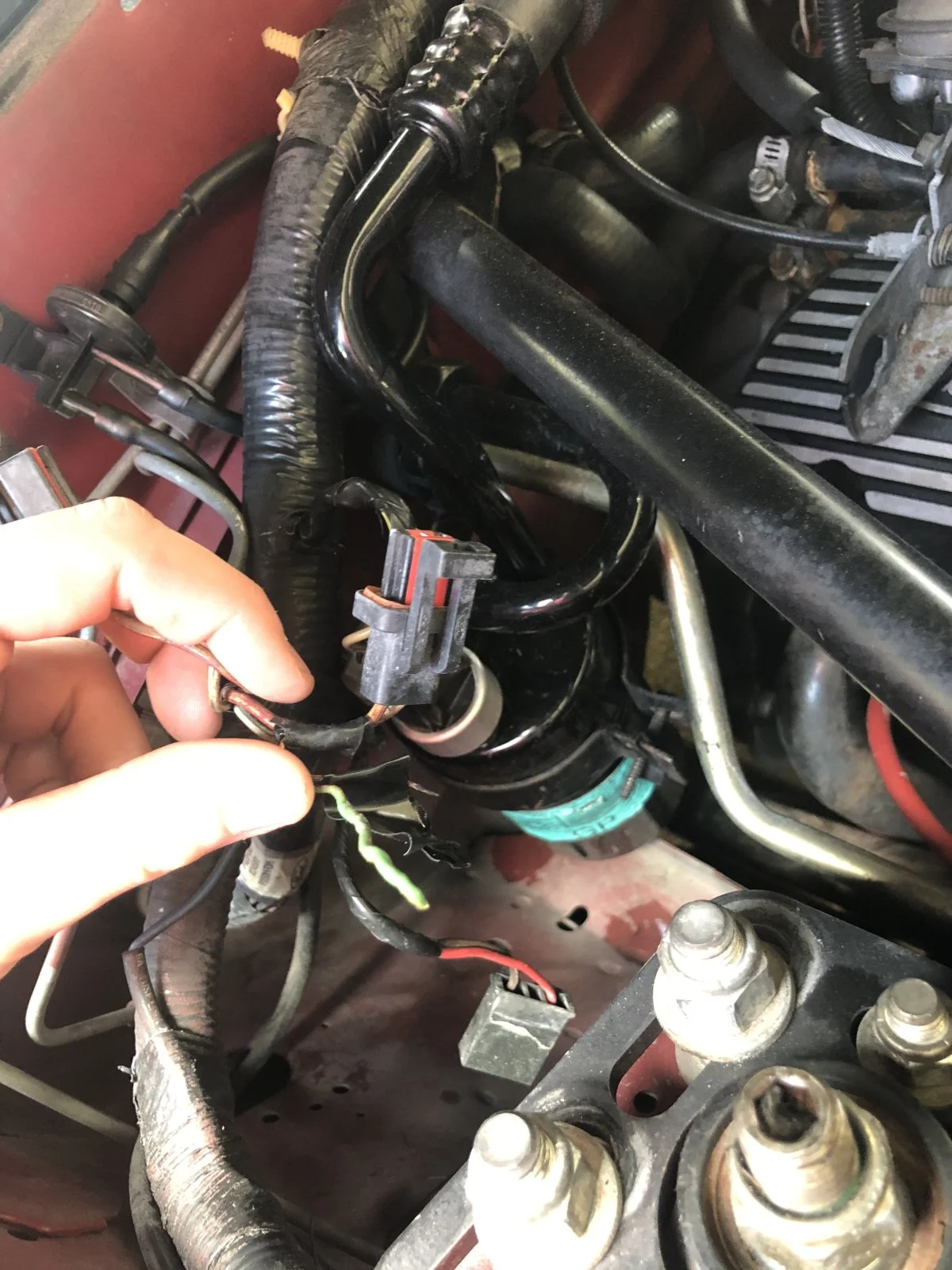

Yesterday I went to start my car is it began to smoke and wouldn’t start.
I found a wire that was melted. (Green wire)
When I found the wire it was split in half, which leads me to believe it was never connected. I cut the wire and taped it off and then the car started right up.
So my question is, can anyone tell me what the wire might be going to?
Where it connects near the firewall there is two other pig other pig tails not connected to anything either.
Pics attached, thanks

See the wiring diagram below. the PO may have made some modifications...

Well after the near fire incident, my alternator is now officially bad..
I ordered a PA 130 amp alternator.
When I install this I will trace the green wire back because it is tied into the wires going to the alternator.
Thanks for the responses.
I will possibly have a few more questions once I dig in when my new alternator comes in.The one that’s on there now is a 3g alternator, I’m just going to make sure the wiring was done correctly.
