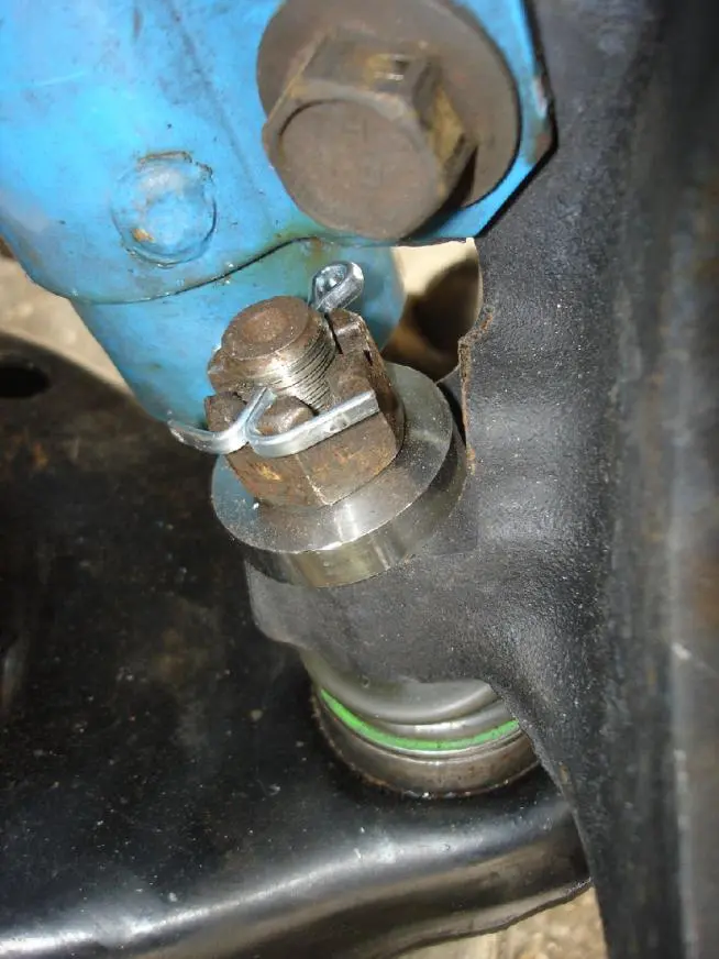

You will need a 0.330" tall spacer, 5/8" ID. This installs on top of the spindle as shown to use fox ball joints
dsc00460-jpg.58008
