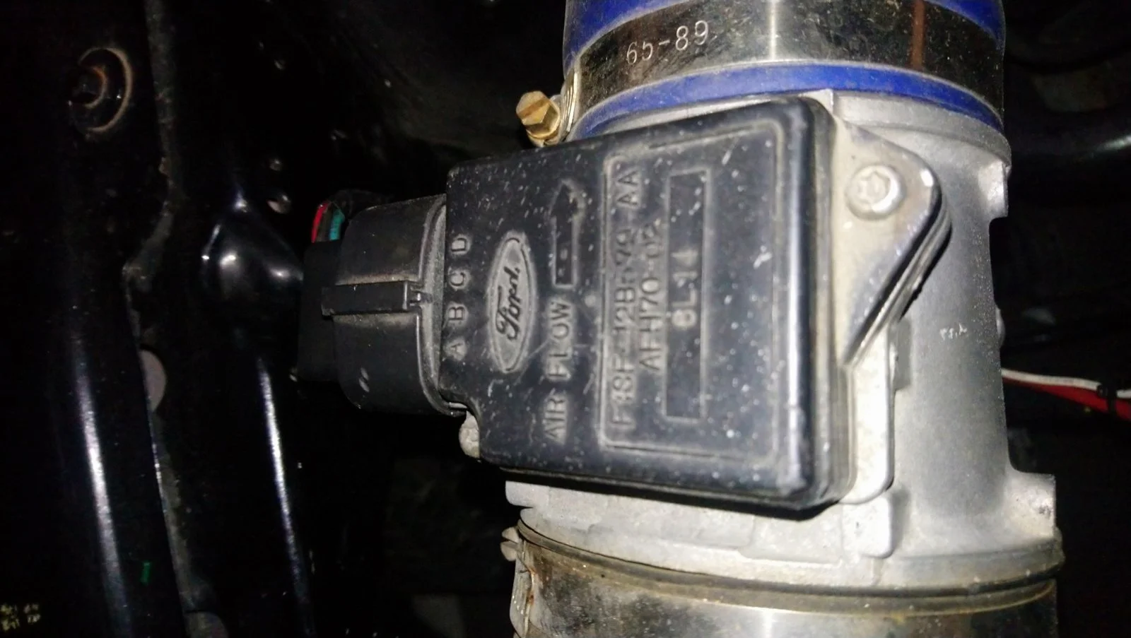

I have a 91 mustang gt with a 93 motor in it with some work done to the motor from what I was told. They said it had a cam in it, 24 lb injectors, trickflow intake, 93 computer and bbk headers. There might be more but I'm not aware of but I sent it into a mechanic that had to use the 93 harness to get this thing running. So the car starts right up but idles up and down and the exhaust smells like gas bad. Anyone have any ideas where to start?
I was told it was calibrated to the 24lb injector. Can't confirm that

Can't tell much from that picture... it kinda looks like a 93 cobra 70mm maf though. I'd removing, measure it and cross reference it with pic's of a 93 cobra maf. Have you dumped the codes??? Search for the "Idle Surge Checklist" thread... it will get you dialed in.
