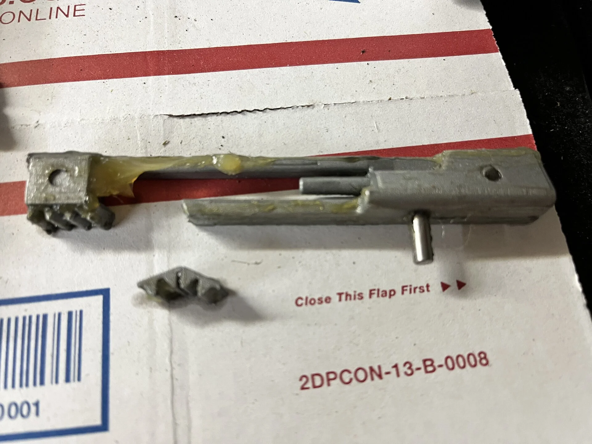

All right, so after all that trying to troubleshoot these parts, asking all of you for help and thinking that the gear was either worn down and slipping or too much play in it or that something internally was wrong with where the ignition rod and key cylinder meet. Luckily my original ignition rod was in good condition and I reused it, you’ll see why. I finally decided to check the ignition switch. I removed it from the car and used needle nose pliers to try to slide the part the push rod would post and it didn’t move. So I took it apart and the part that is supposed to slide for the contacts was jammed up so I fixed , that put some grease on its track, put it back together then installed it in the car and the key turns fully now and actuates everything as it supposed to. The old switch did this because it broke (what I believe was a cord recall, but I can’t believe the new replacement switch did this too causing me to think it was a common denominator and not both switches with issues.

FYI stay away from doorman ignition rods they are crap that is made in China picture posted of what happened to mine likely my original rod was still in good shape and I put that one back in.
