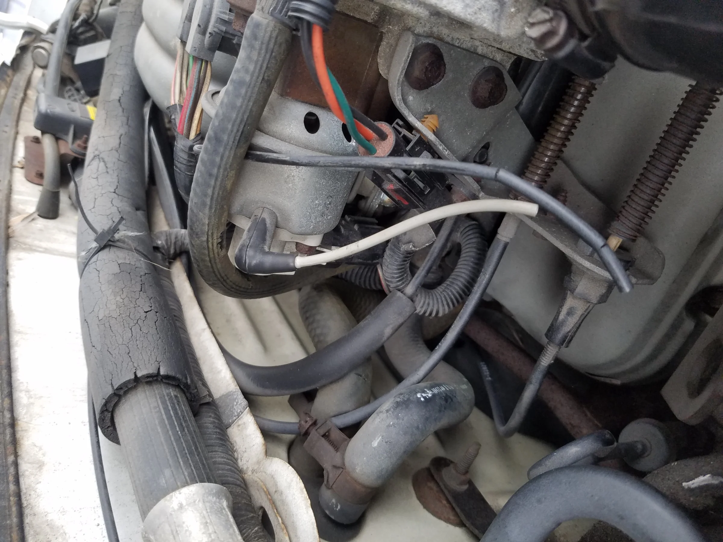

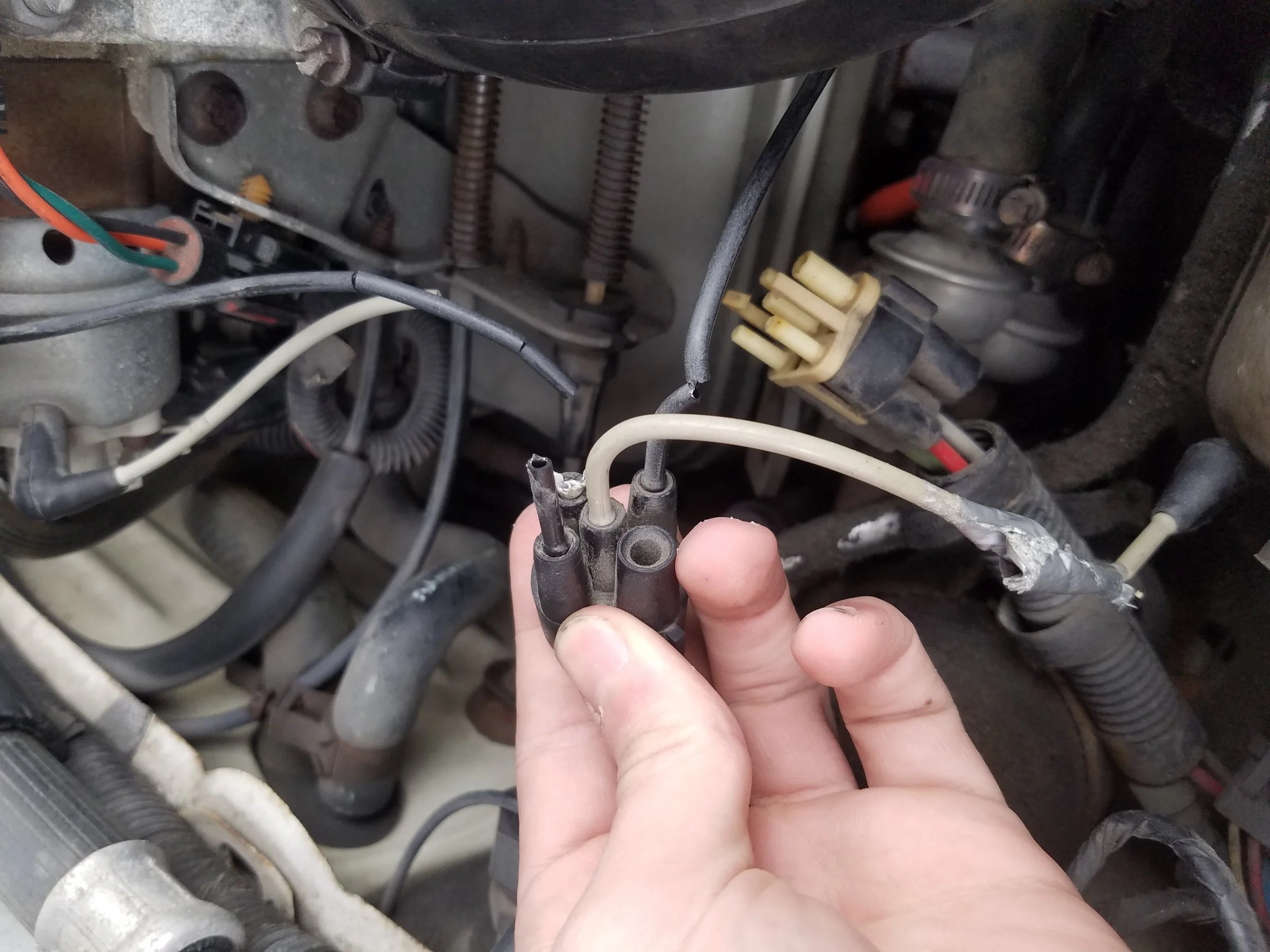

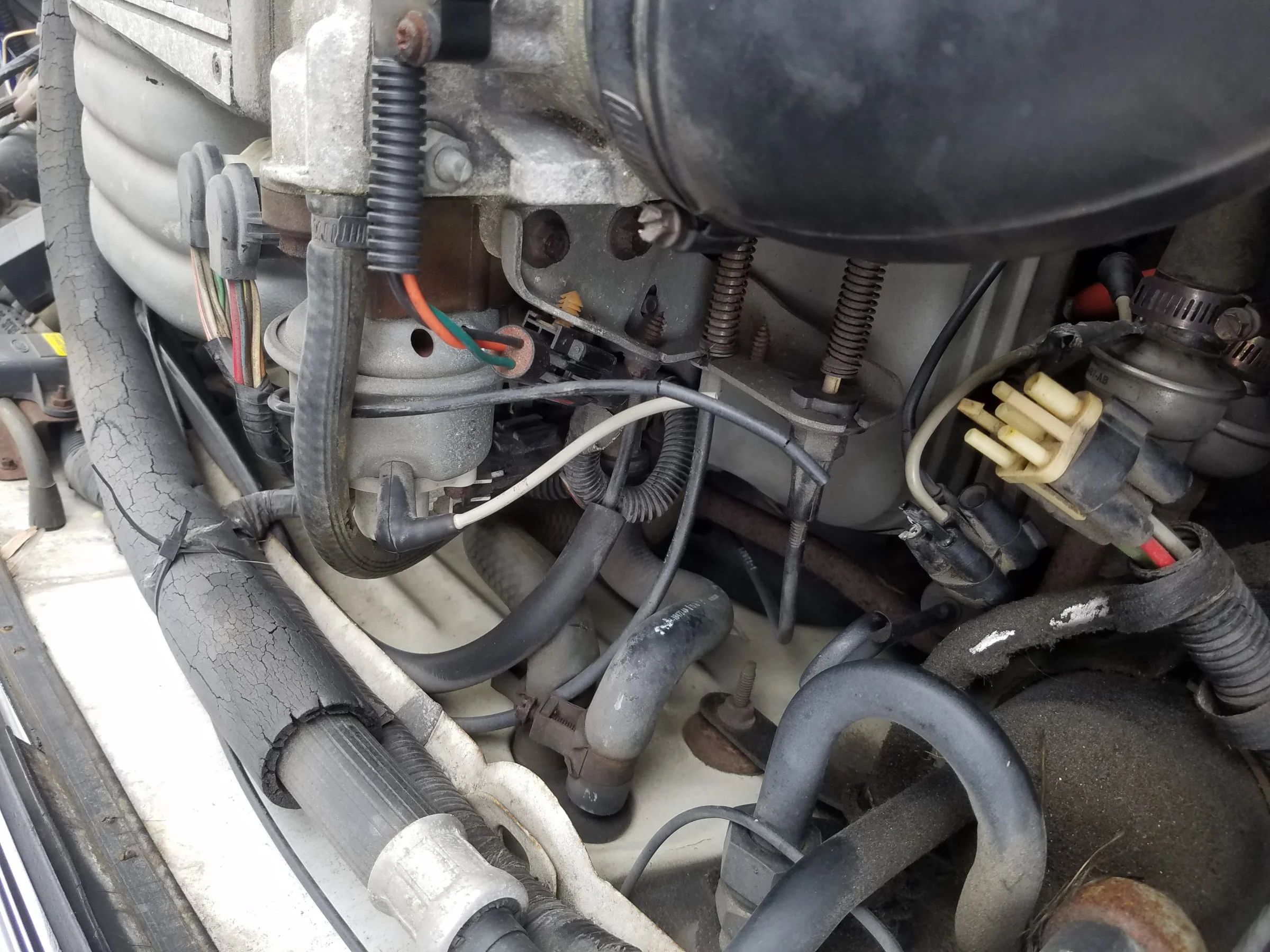

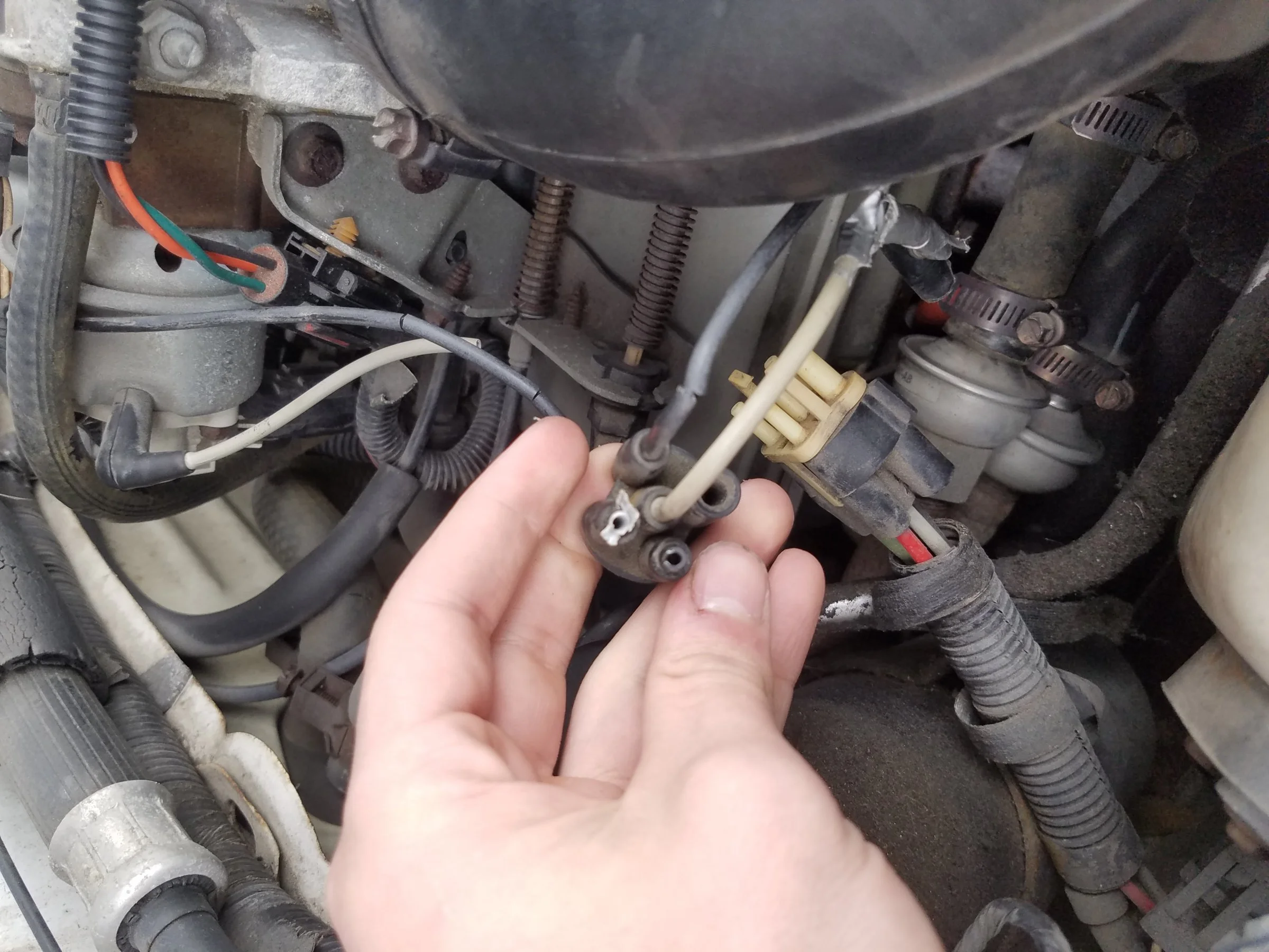

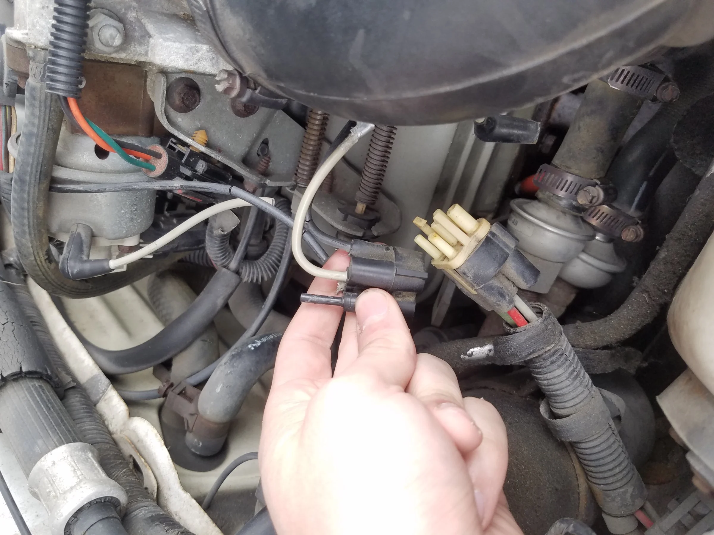

Hey all. So i have a 1991 foxbody and i have been having some problems lately. It has been idling very rough and surging between 500-1500 rpms. Sometimes it will start and then die right away. I have tried cleaning the MAF sensor, replacing the IAC, adjusting the TPS, i just gave it a tune up and replaced the spark plugs, wires etc. still nothing. The only thing left i could think of was a vacuum leak. I have seen that alot and checked and found nothing... untill today. I was looking under the hood and came across a couple broken hoses. It was a harness type of thing. One hose was going to the EGR valve, another to the back of the engine, and 2 more. I attached some pictures for reference. If anyone could tell me what this part is called and where i could get one that would be amazing. Thank you in advance.
