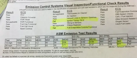

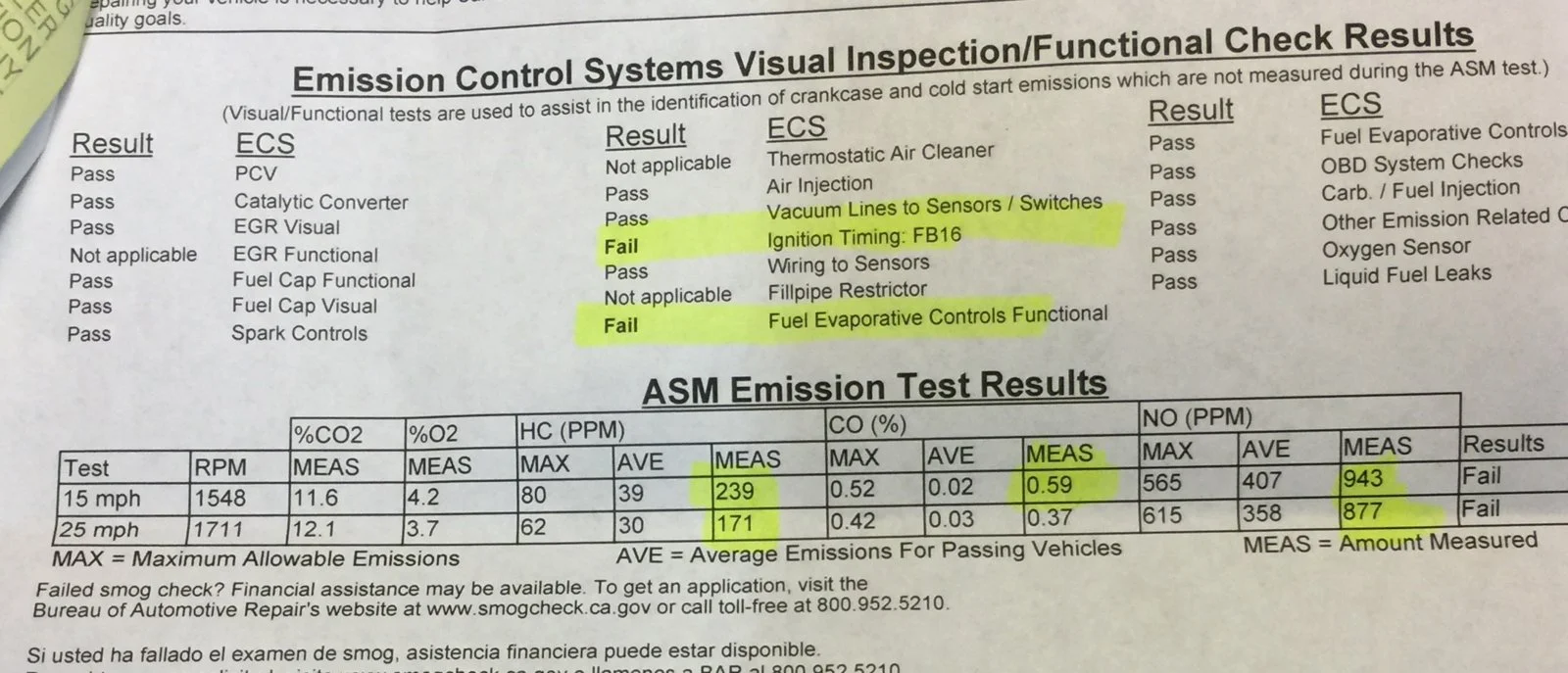

Any feedback on this report? I didnt even know my timing was at 16...fack! That was my bad. Could that be the main cause of me failing the smog check? I already going to have the smog repair shop figure out the evap leak somewhere between the fuel tank and the charcoal canister..

The ignition timing out of spec seems to have triggered one flag.
How to pass emissions testing:
High NO - high combustion temps - retard timing, check EGR for operation.
High CO – Rich condition - fuel pressure too high, check O2 sensors, replace air filter, Clean MAF element.
High HC – Lean misfire, vacuum leak, common misfire due to worn or weak ignition system components. On rare occasions, an overly rich mixture may be the cause. Do the ethanol/E10 fill up as suggested.
High CO & HC - Cat converters, smog pump, and smog pump controls. Make sure the smog pump has good air output at 1200-1700 RPM
