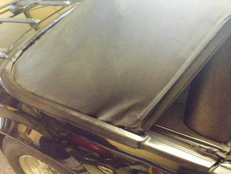

I bought a complete top/frame assembly from a wrecked '91 and installed it on my project '87. Fit perfectly so, yes I believe it'll work. Here's a pic for ya:

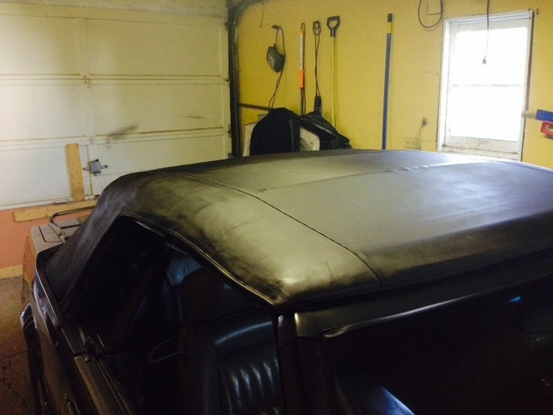

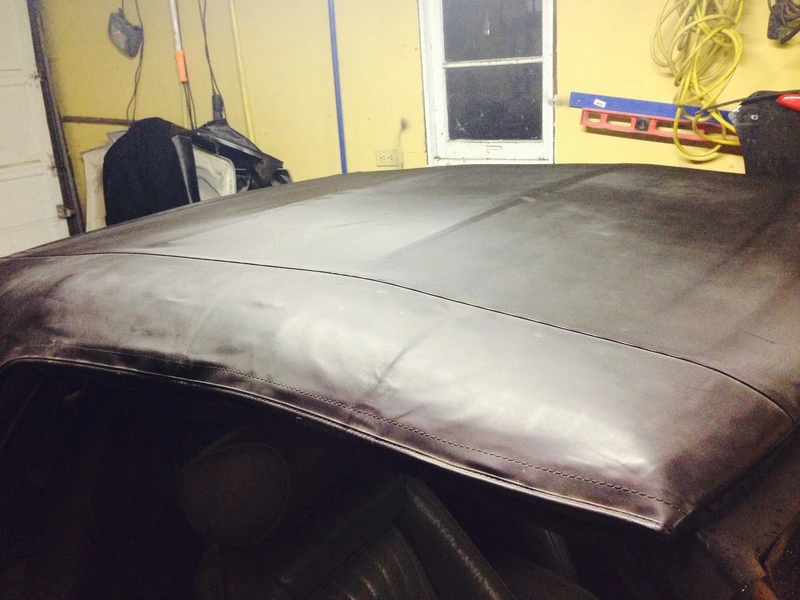

Still has a bunch of dirt I need to clean off of it, and I got to try to get the sides more taught, but overall good.
