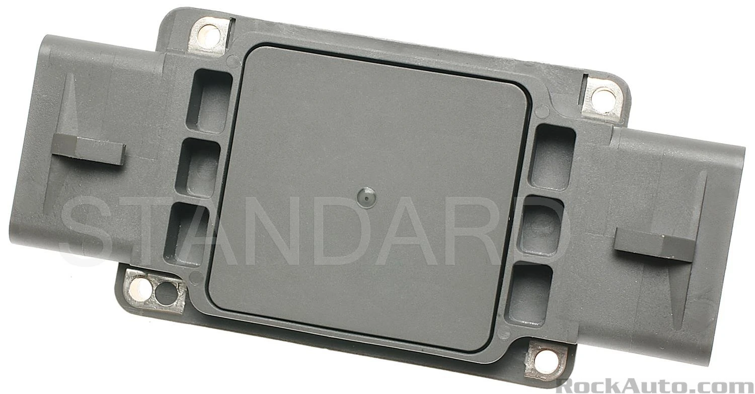

Mustang5L5 That is…until I whipped out my Bissell Mod Dude Feb 18, 2001 43,264 17,952 224 Massachusetts Jan 17, 2017 #2 Jan 17, 2017 #2 No idea, but I know it looks like this. It's like the TFI on the 5.0's. Also, like on the 5.0s, not a cheap part

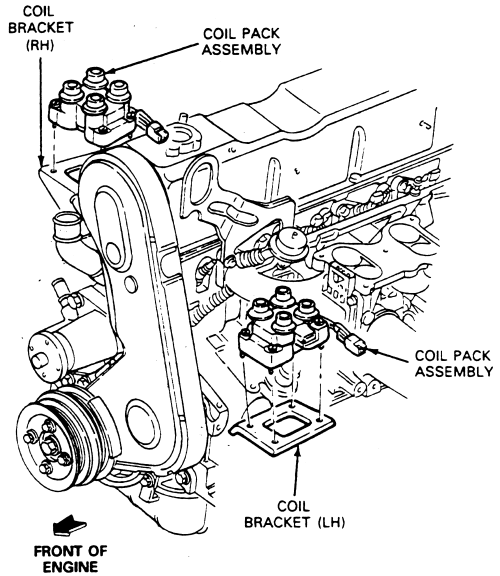

Mustang5L5 That is…until I whipped out my Bissell Mod Dude Feb 18, 2001 43,264 17,952 224 Massachusetts Jan 17, 2017 #4 Jan 17, 2017 #4 On the ranger 2.3L, it bolts to the lower intake manifold You can make it out in this shot behind the driver's side coil pack

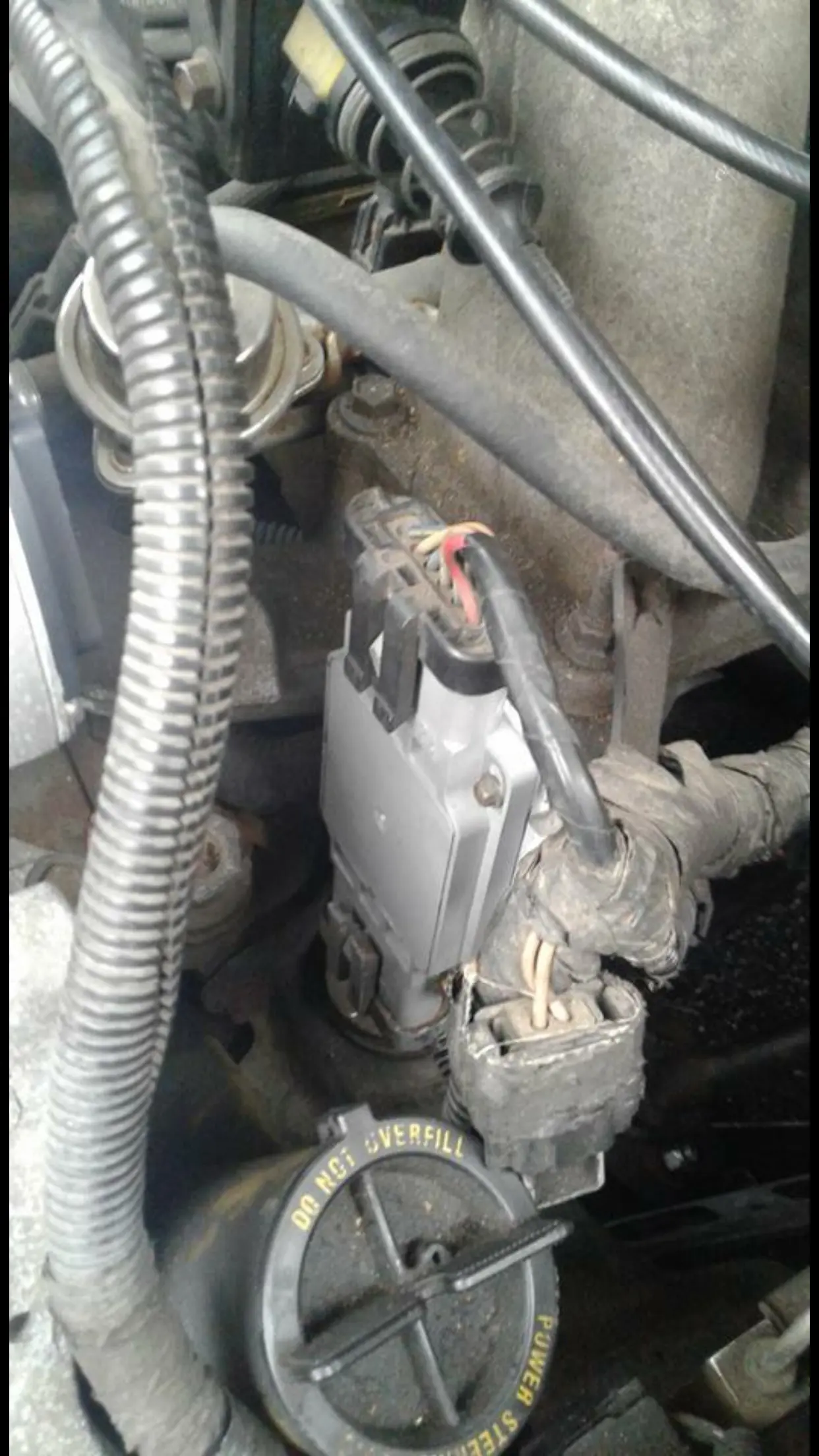

billison I like tinted tail 15 Year Member Feb 27, 2006 2,607 1,094 184 stl Jan 20, 2017 #6 Jan 20, 2017 #6 Location Attachments IMG_0099.webp 103.6 KB · Views: 695
