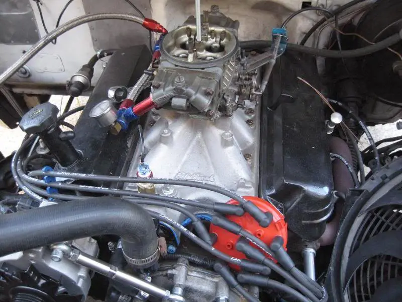

Don't sweat any BS comments .. do what u want. I just got my 93 running with an Edelbrock carb 600 cfm. Performer rom manifold. Runs great! This is on top of a 331 with Edelbrock heads, Edelbrock can, comp cams rockers
